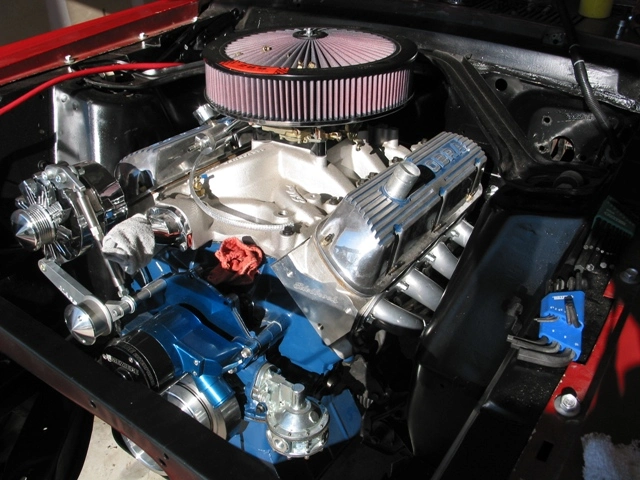

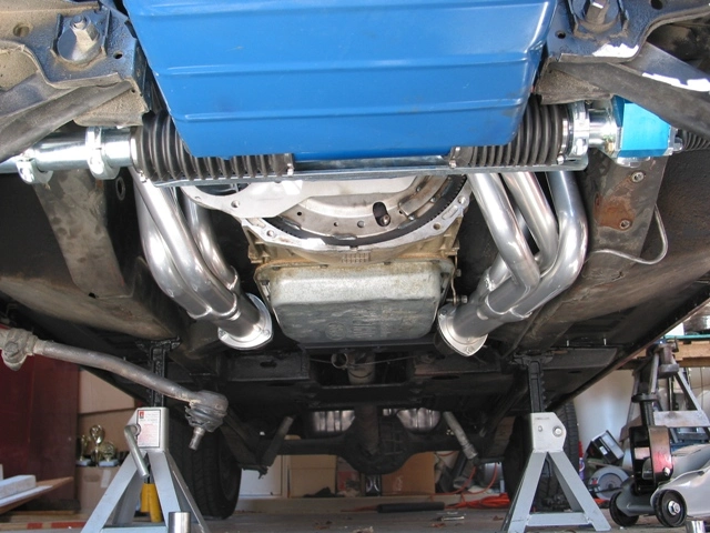

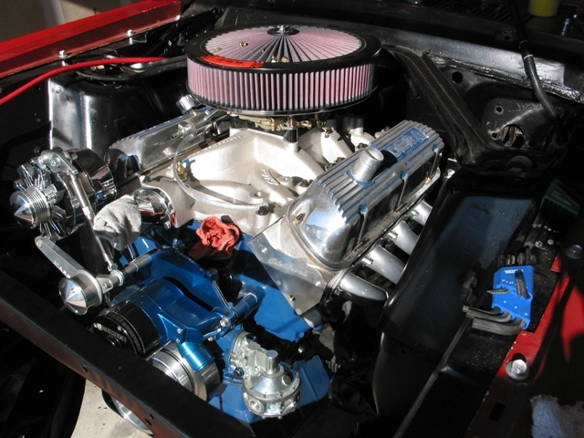

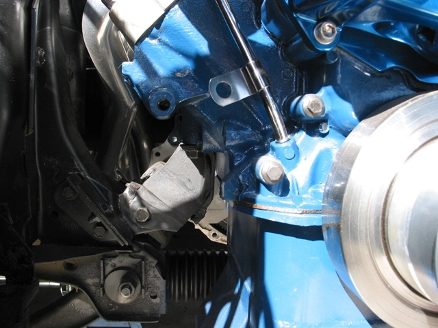

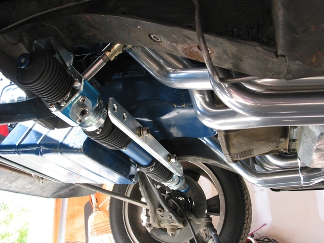

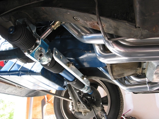

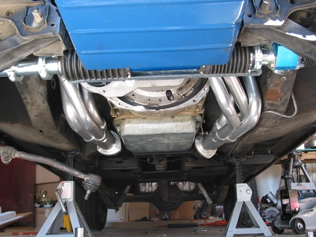

I posted this just the other day but it was asked for again. This is not a 69/70 but the engine compartment and transmission tunnels are the same as my '67. These are ceramic coated Hedmann Elites on a 351W with an AOD behind it. Plenty of room for aftermarket rack and pinion and also plenty of ground clearance.

69Rcode_Mach1 said:
I agree that is a very nice looking engine compartment. Will the hedman elites be okay with power steering though??
Yes, you'll need the PS 1" drop bracket just like you will with every long-tube I've ever used. You could do a rack-and-pinion and avoid that though :D
"These are ceramic coated Hedmann Elites on a 351W with an AOD behind it. Plenty of room for aftermarket rack and pinion and also plenty of ground clearance."
Wow....those look great.
Makes me glad that I ordered a set this morning!! Hey, maybe my luck is changing :shrug:
