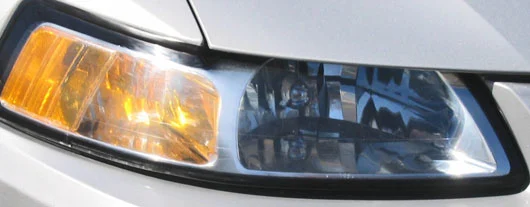

When I purchased my 99 Mustang, the first thing I noticed was the awful hazed/fogged over headlights. I priced new headlights up and figured I could put money into more important things on the car. So after doing some research I decided to restore the headlights myself and live to tell how I did it :D

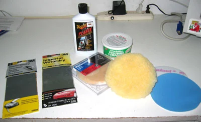

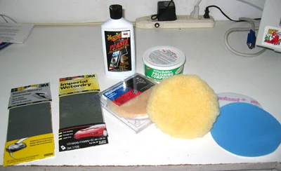

Heres the materials I used.
- 600 Grit Sandpaper WetorDry
- 1500 Grit Sandpaper WetorDry
- 2000 Grit Sandpaper WetorDry
- Turtle wax polishing compound "and scratch remover"
- Meguiar's Plastx Clear Plastic Cleaner & Polish
- 2 Polishing/Buffer Pads with drill (or electric polisher if you have one)
- Clean rags
- Masking Tape
- Water (bottled)

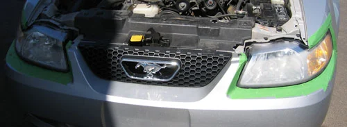

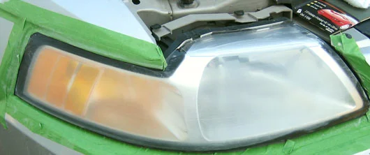

Step 1. "Tape Up"

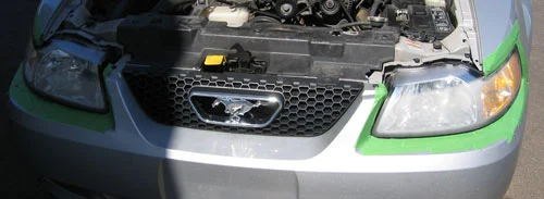

Get any kind of masking tape, and tape all around the headlights with the hood up so you won't accidentally scratch the paint finish. You can go all the way and cover the bumper but I didn't bother.

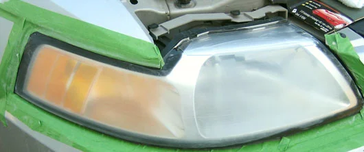

Step 2. "Wet sand with 600 grit sandpaper"

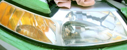

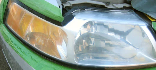

Wet the sand paper (don't spare the water) and pure some water over the headlight and start sanding with a bit of force. Why i choose WET sanding is because its less abrasive and you can see results when the headlights are wet. I used side to side strokes instead of circles. Use lots of water, make sure the sandpaper is always wet. I spent probally 10 minutes per headlight. You will noticed that the headlights might of look worse then you started, but thats OK. because we want an EVEN sand, you will get a chalky paste as you sand. Once you get both headlights evenly sanded , proceed to step 3.
Heres a pic of step 2 sanding. (pretty cloudy looking)

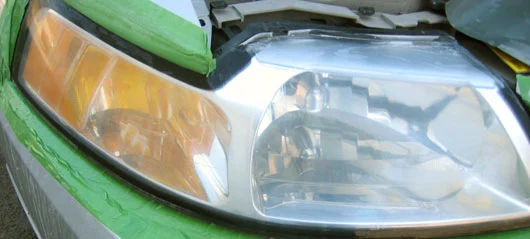

Step 4. "Wet sand at 2000 grit"

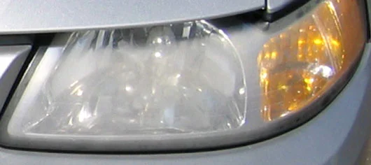

Once again, wet down the headlight , use a NEW clean rag and wipe the headlights clean. This is a very crucial and time consuming step. Approx 20 minutes per side. You may want to take a break first. You pretty much do the same side to side strokes with LOTS of water as you did in the last 2 steps. The difference here is, that you continue to sand until the headlights become almost new looking or at least close to your desired look (with water applied, it will still be cloudy dry). You know when you done when the lights look pretty clear when theres water on them. Look at the pic below to see when I finished step 4.

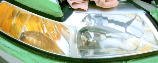

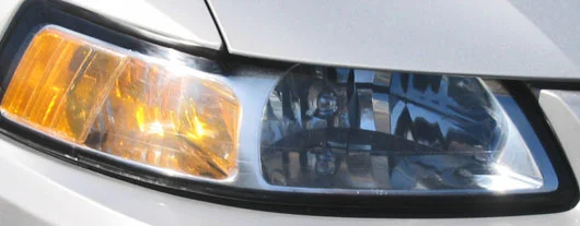

This is where the real magic happens. This is where your discouragement fades away like mine did. Even after the 2000 grit sanding drys theres still a cloudly look. Thats because theres millions of fine scratches that even the finest sandpaper can't get rid of. Thats where the "Turtlewax" polishing compound "and scratch remover" come in. This white paste will literlly remove the final scratches. I used a regular drill and buffering pad. If you have an actual polisher then use that. After wiping the headlights clean again , I put a bit of the paste on a rag and apply it in circular motions on the headlight until its completely covered with a thin layer of the paste. I then start buffering the headlight until you start seeing the amazing clearity come through. It will amaze you. Can can spend as much time on this as you want. I spent 10 minutes on each headlight. Some things to take note is if you stay in one spot too long it can scratch from the paste itself (just takes longer to buffer it out) and keep cleaning of the buffering pad to get rid of little chunks of paste buildup. Once you have done this , you should see something like this

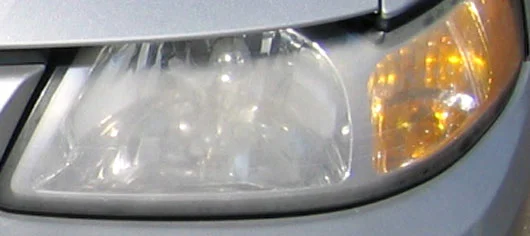

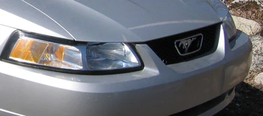

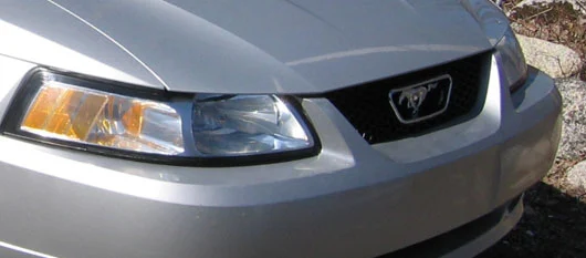

This is the final step before tape removal and wipe down. You may not find it neccessary but I wanted to get a final "polish" done with PlastX by Meguiar. I heard wonders so i wanted to finish of with this. I changed the buffering pad (you probally could of cleaned the other but I had 2 anyways) . I followed the same steps as Step 5 (about 10 minutes each) and volla. Its finished. You then remove the tape and wipe down the bumper if you haven't covered it up. My end result was this
I did find my drivers side worse then the passengers. I have learned a few new things and I may sometime this summer spend another hour and do Steps 5 and 6 again to get even the tiniest scratches out. I will of course have a polisher.

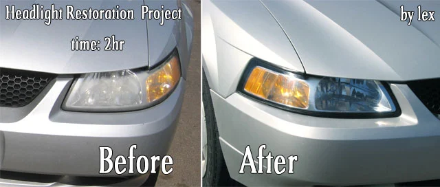

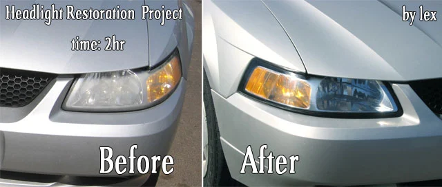

If you were wondering just how bad my headlights were , Heres a final BEFORE/AFTER shot
BEFORE
AFTER
