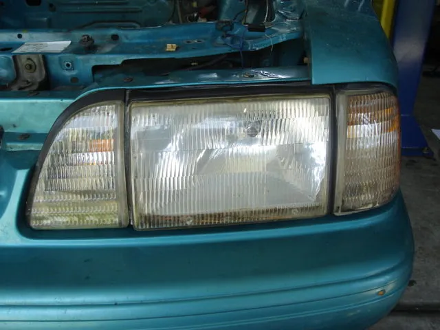

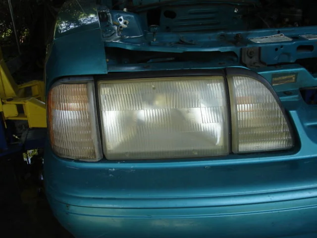

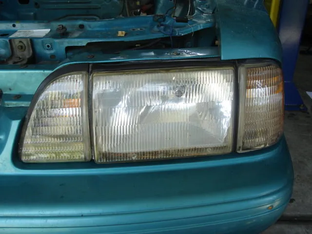

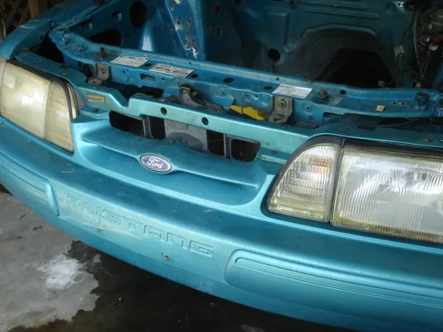

This guide was great, worked wonders on my 93. The pics just doesnt show how good they turned out.
dsc00716fs1.webp BEFORE
AFTER
-AJ

yeah, the hardcoat has been gone. The clear finish is the first thing to go. Once the clear starts coming off from the top, it's NO MORE. It's just a plastic lens now. I have put wax on them, specifically the Meguires yellow wax in the can. I would put a coat on, wait a day, put another coat on. I have put a total of 4 coats on those things and they still haze out and look like crap in a month or less. This was before I sanded them with 400. I generally do the 800 - 1500 - 2000 routine< but it just wasn't working out too well. The plastic had a very rough texture to it on the lens front. Like it was badly weathered. The rough texture was still hazy & impeded the light output. The normal routine wasn't getting it out, so I went to 400, then worked back up the chain, and then polished and waxed.
