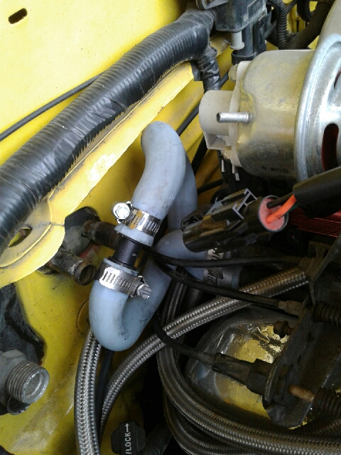

My heater core just went on me. You will experience fluid leaking from the lower firewall on the passenger side. There is an A/C condensation weep hole which doubles as an exit for coolant when the core ruptures. If you are losing coolant or smelling coolant it needs to be addressed. You can bypass the core for now, but if that is not the problem I would definitely replace the thermostat and the radiator cap because you could be overheating from a closed or partially closed thermostat and overheating will damage the seal on your radiator cap. Both are cheap and easy to replace. Attached photo is how i bypassed my core. Easy fix with a heater hose connector 3/4" to 5/8" and you use the 2 hose clamps present or buy 2 new ones. good luck!!
