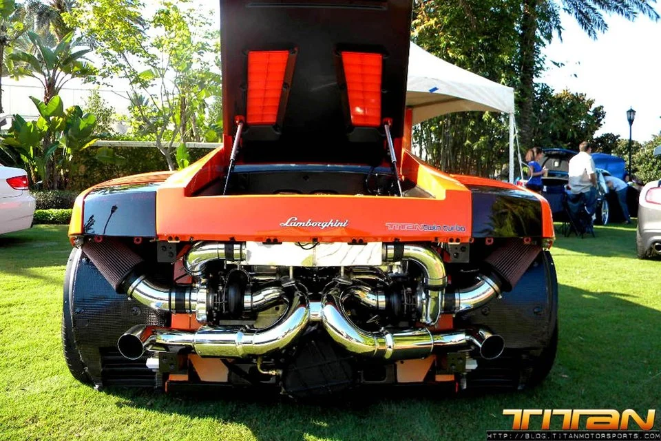

Maybe the same skill set involved in doing polishing work like this:
