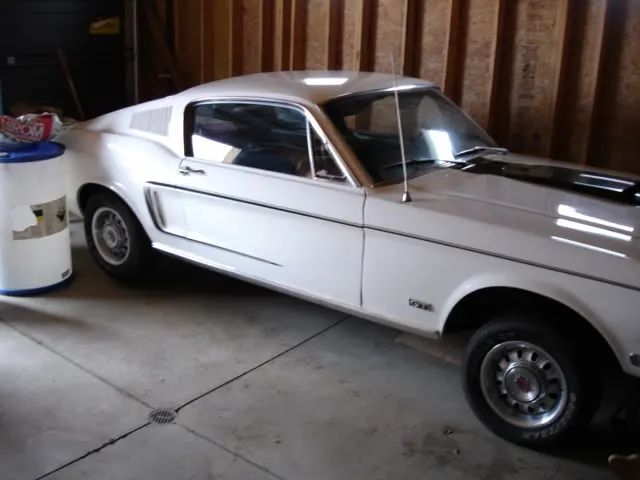

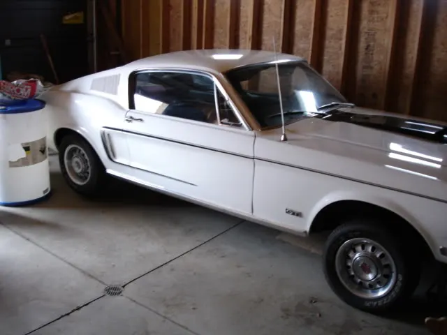

My bro has had a 68.5 'R' code Stang (wimb. white) since '78. when he bought it, it had Cobra Lemans valve covers, 2x4 bbls, and the oval cobra air cleaner. Being in his early 20's back then he just assumed it was a shelby dress up kit/intake on his 428 CJ heads and block. He sold the intake /carbs and got the correct 735 Holley.The car has basically sat since the early 80's since this was all done.
