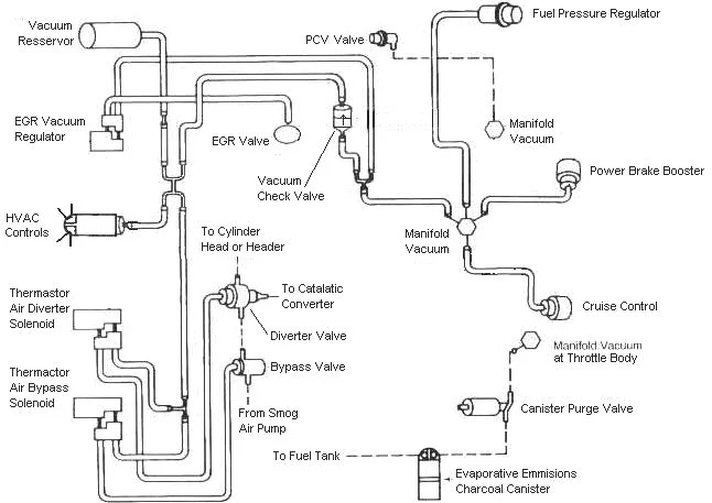

I was wondering if maybe I have an intake leak at maybe the front or the back of the intake where I used silicone. The car did perfect for over 30 minutes of letting it idle and just playing with the fuel pressure and timing. Then the car started missing and cutting off. Thats when I lost most if not all of the vacuum. My brakes wouldn't work and the air/fuel was reading extremely lean. While I was driving it home the car was surging real bad at 2,000 rpms and unless you put the pedal to the floor it wouldn't clear up. I have went over all the vacuum lines about 10 times this morning and replaced all of them and made sure they were all tight. And there was no change whatsoever. It's still popping through the air filter and has 0 vacuum at idle. When you give it gas it will rev up and stay high for a couple seconds and then it will come back down. I'm really thinking that I might have an intake leak now. Thanks for the diagriam Jrichker. I have no smog pump so that vacuum line is gone.
I have:
fuel pressure regulator to the intake.
The S from the vacuum log on the firewall to the intake
The smog canister is tee'd into the pcv valve line and is running to the intake.
And the Egr valve vacuum is hooked up and the black plastic line from the vacuum bundle is hooked to the intake.
Thats the only way I know to have the vacuum lines. They are all new and all are tight. I am scared I have an intake leak.
