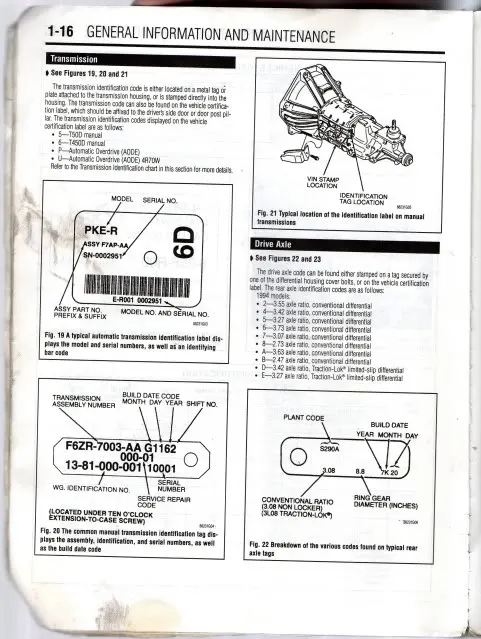

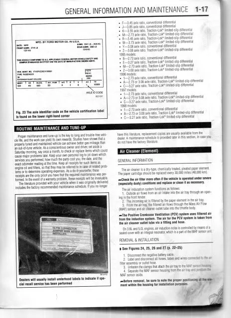

heres an example of what you'll find on the tag.
this is from my 94-98 mustang repair guide,so use only as an example.
i recommend you get yourself a Chilton and/or Haynes manual.
note the "L" with the gear ratio for LSD.
or may be listed on the door tag.
(it is on mine,not sure of the fox body mustangs)
If you cant read the tag on the rear diff. you can look at the driver side door tag. Under AX on the far right bottom it should show 1 of these 3 letters.
M,Z or E
M=2.73
Z=3.08
E=3.27
