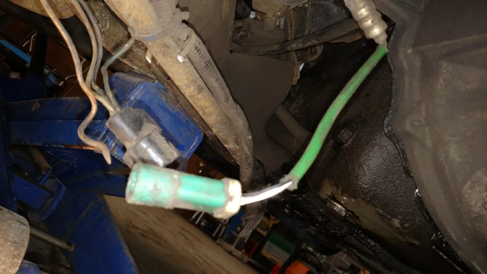

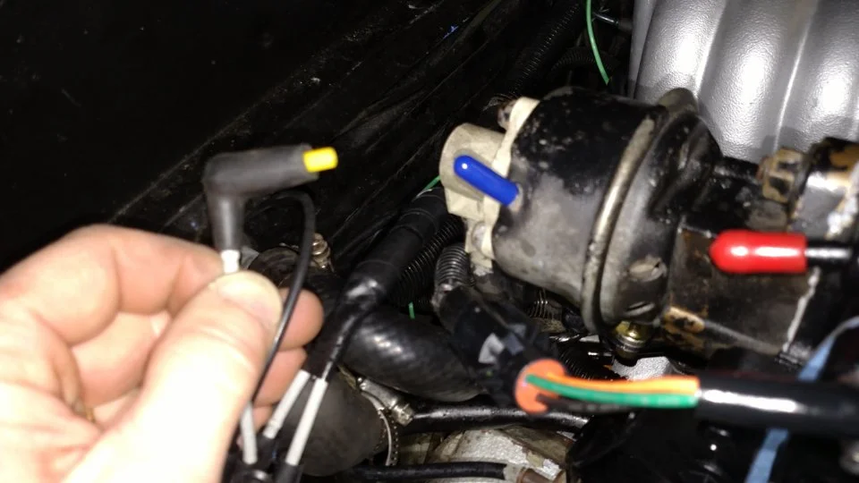

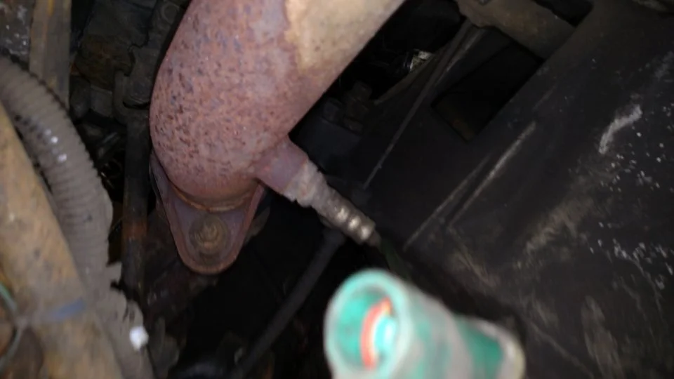

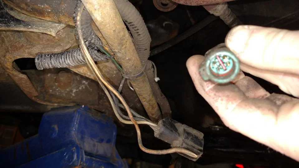

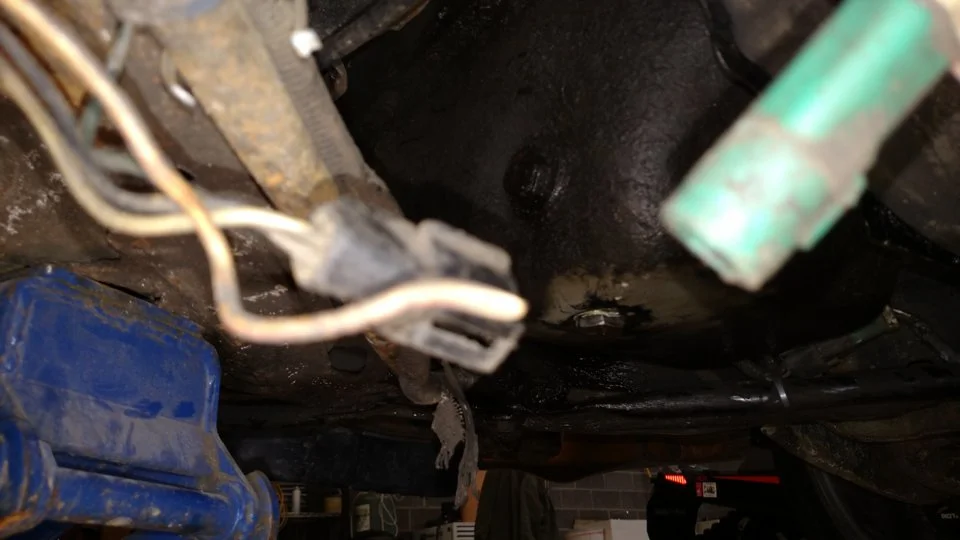

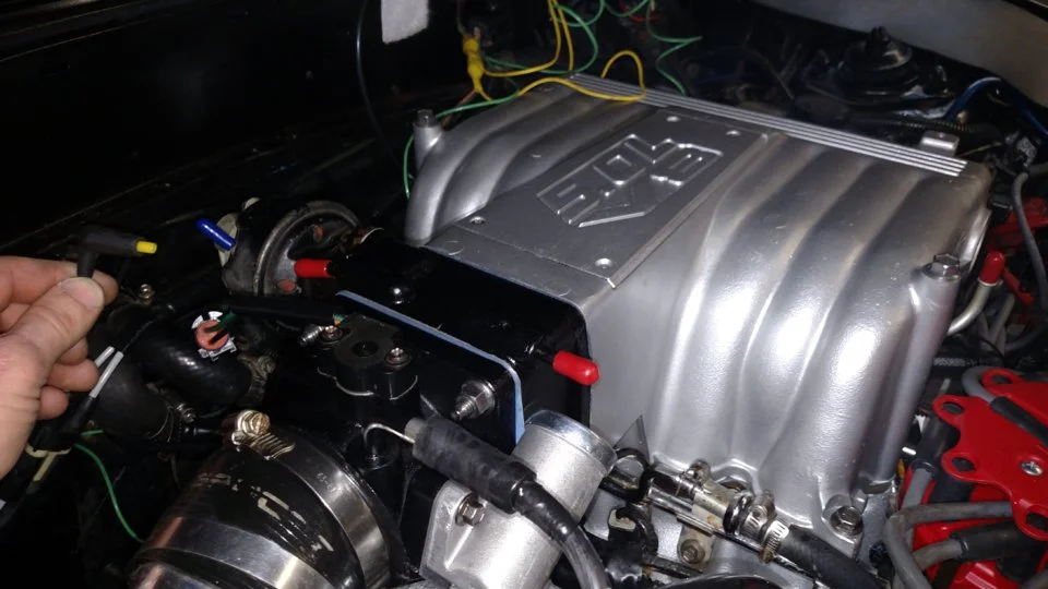

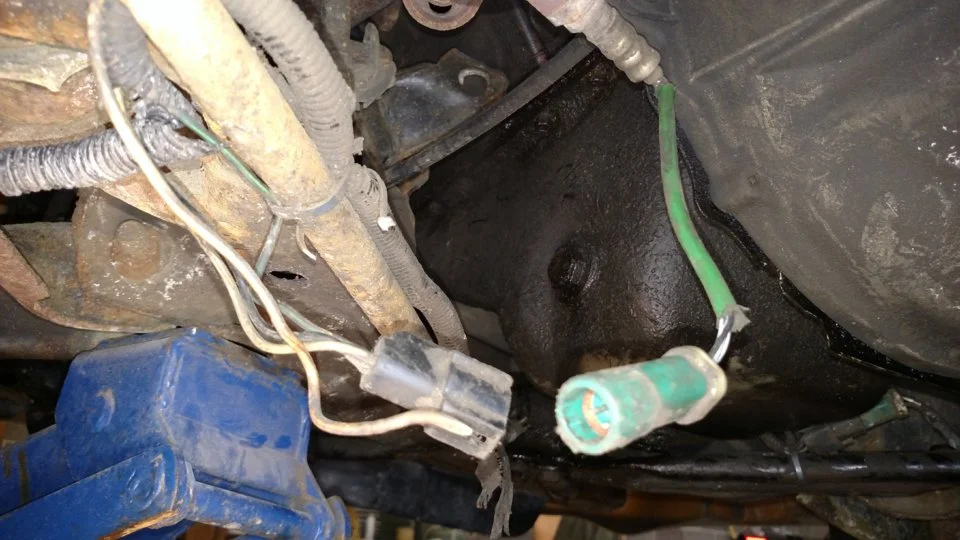

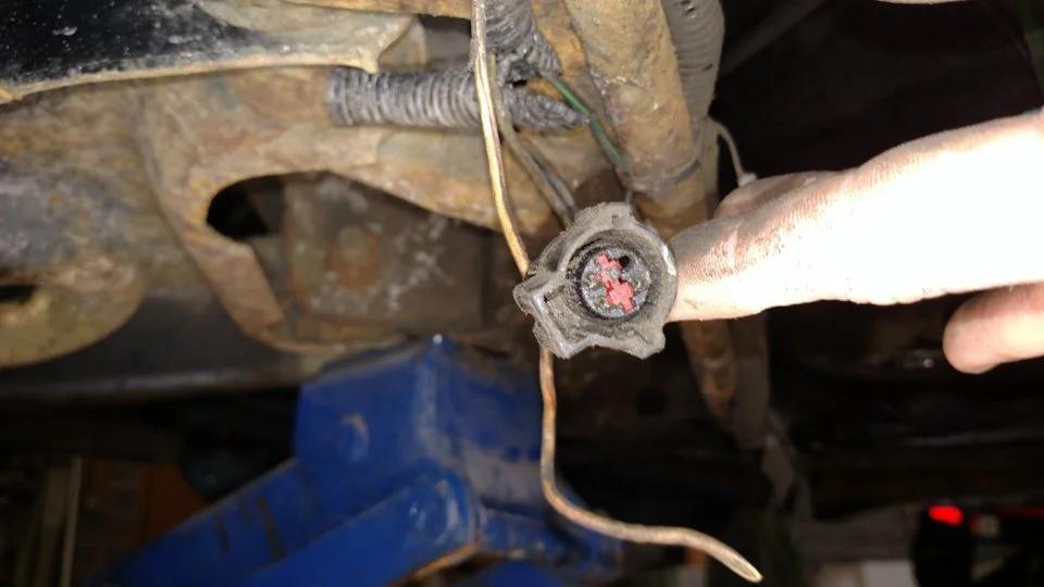

unplug the connectors to the 02 and take a picture of the 02 connector and harness connector.
Ok, hear ya go. All from the driver's side

You still need them for fuel control. Looks like that clipped wire may go to the low oil level sensor. You need to find the wire on the 02 sensor that is not being used in the o2 harness. It should be one of the black ones. So, which ever wire on the 02 sensor is going to the blank spot in the harness, is the one that needs grounded.
Ok. I'll look again and ground the wire not being used..I'll report after work or if I get a chance on my lunch brake.
As far as grounding the wire, chassis ground OK? Like maby on my firewall?.
Thanks liljoe07 ,as alwase. I'm learning a LOT about this car with your help and great patients.. Lol.
Yeah that more than likely the reason for codes 91 and 41. The 3 wire and 4 wire 02s are designed differently internally. 3 wire grounds through the case, and the 4 wire grounds through the grey wire for the 02 signal. Typically most 4 wires are connected to the SIGRTN circuit. But you should be good with a good chassis ground.
Reactions: 88droptop5.0
Ok, I'll ground the gray wires and report back.
Ok, I grounded the gray wires coming from my o2's to a good chassis ground, I lost the 41 & the 91 codes with engine running.
