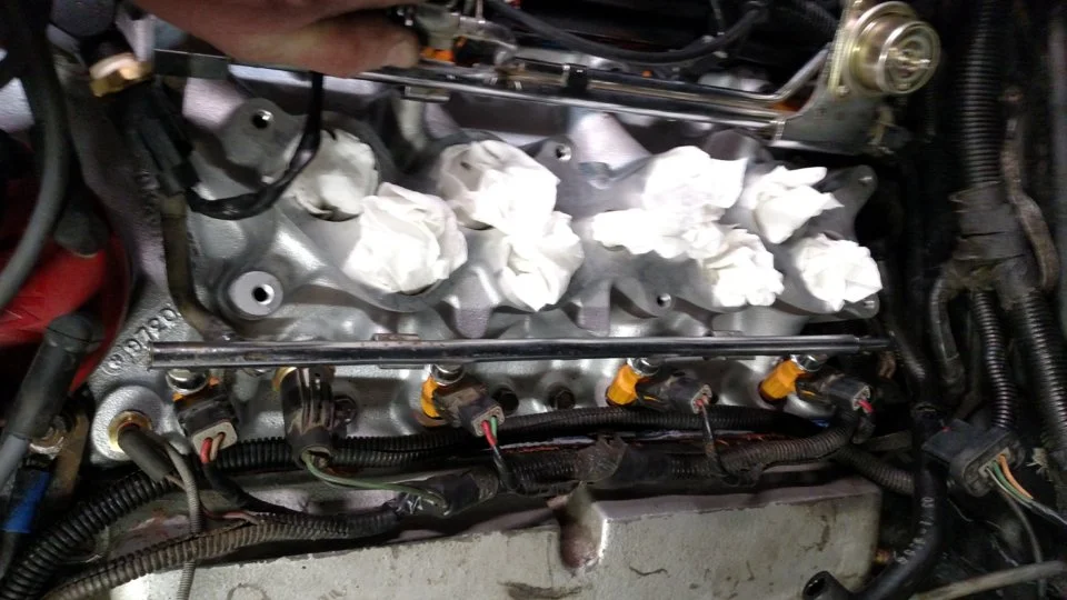

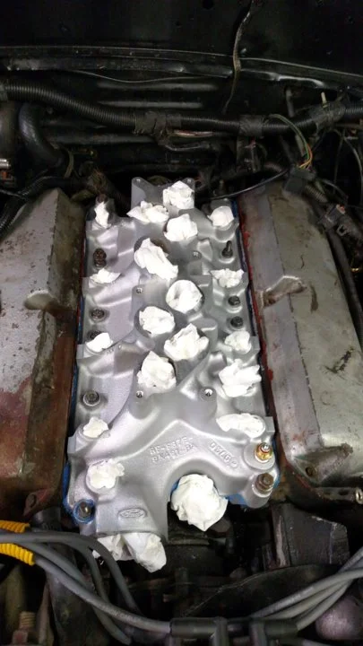

I got my lower intake installed today.
Next I'm gonna pull my valve covers and freshen them up..lol
I should have my new injectors and fuel line in Friday.

Quick update, I have my lower all finished. I installed fresh flow matched 4 hole explorer injectors, a new fuel pressure regulator and all new sensors that I could find.lol... And a new 180° thermostat.
I will install my upper tomorrow afternoon and hopefully she runs right this time.

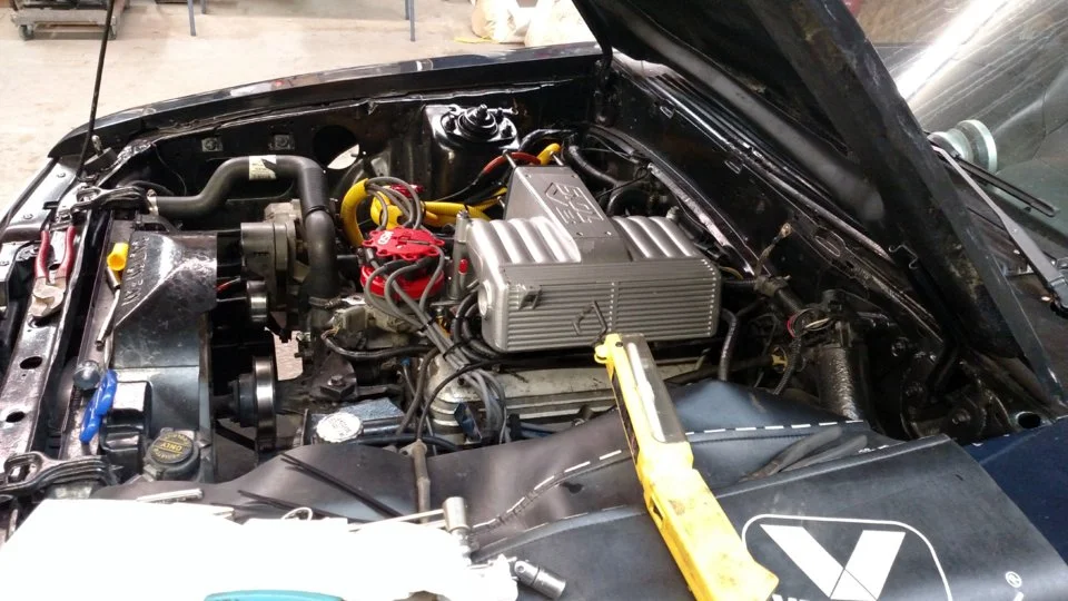

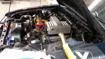

Ok, I got my upper installed and all the vacume lines I could find and use are replaced. I have a few odds and ends to finish up and hopefully I'll be able to fire her up tomorrow evening.
I'll report back with my progress, and possible a question or 2..lol.
Don't mind my yellow wire loom, it's what I had laying around the shop... :)
