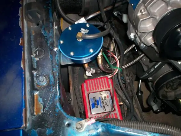

EDIT, i just saw in your first pic. you need to take the line off that connects the TB to the oil filler neck, your bleeding boost into the crank case. you need to cap those off and run your PCV valve somewhere in front of the blower. or just cap it off and run open breathers.
