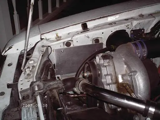

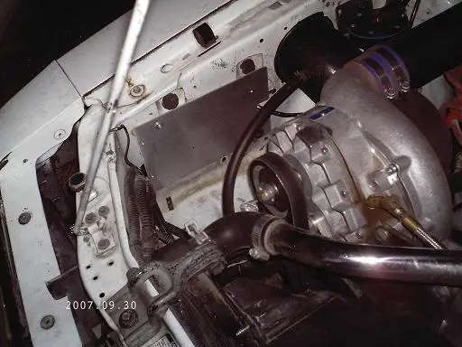

HEY GUYS I FINALLY GOT THE SUPERCHARGER INSTALLED!!! I have pics
DO Ijust unplug the PCV valve or what. When I plug the hose running from the TB will my boost rise?

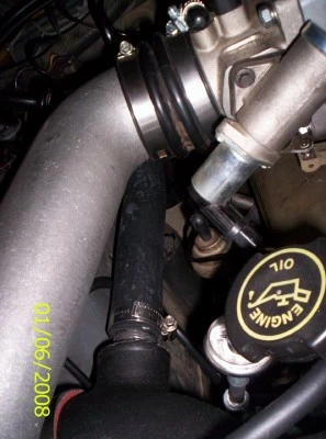

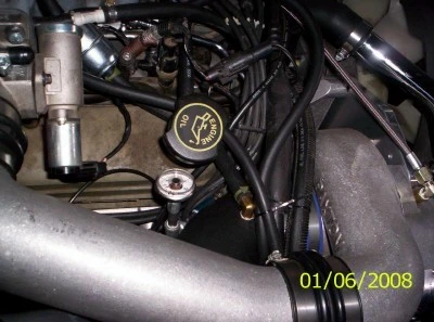

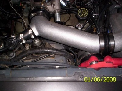

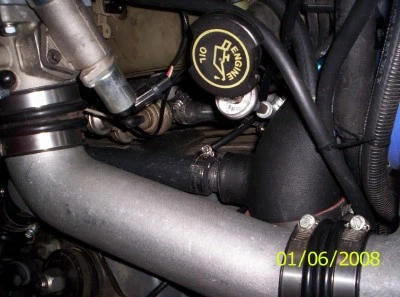

heres some older pics of mine installed, excuse the dirtyness
i drilled a hole and threaded in that barb and ran the line to oil filler neck, this was before i ran open breathers, once i did thati just capped that off. in case you wondered
this was also before u ran a bypass setup. my bypass valve setup isnt anything like vortech made it, i bought all the parts and drilled a hole in my plastic inlet tube. and ran 1" heater hose. with the upr pipe it was hard to get a line to make such a bend in a small area to clamp to the port on the powerpipe. so i had to weld up a little turn around pipe to use.
duno if the pics will help but maybe it will
