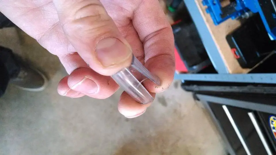

1/2" ID X 5/8" OD tube (in my case vinyl, but I'm sure other materials will work), cut to size and slit long ways:

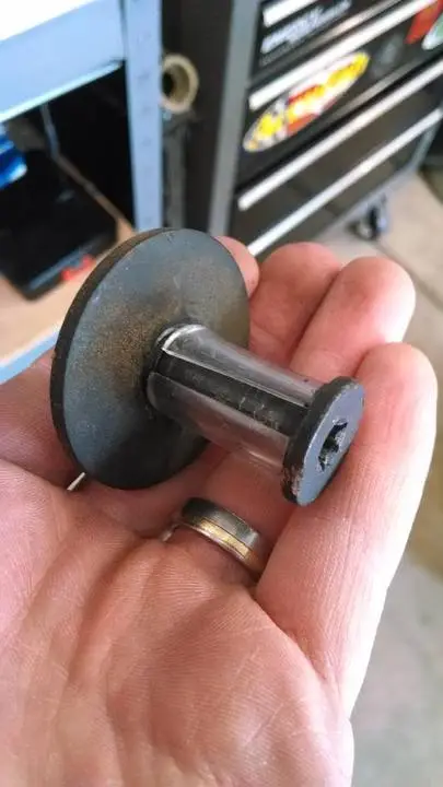

Slip it on the striker:

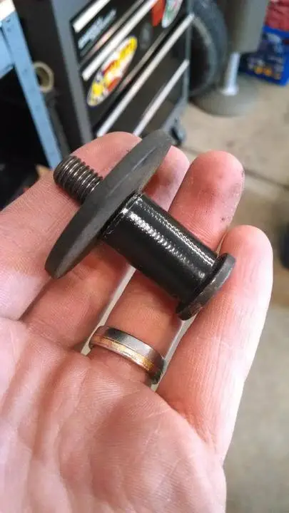

And then wrap it in something to keep it in place. I used some Gorilla tape, but I think a better method would be to use some robust heat shrink for a seamless 360 degree hold. I have some badass shrink tube at work that I'll try out in the future.
I doubt this is as durable as a replacement bushing, but even if it only lasts a year, I'll be happy. I have probably $0.10 into this, so I'd have to re-do it 350 times to justify the replacement striker.
