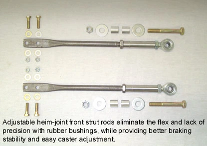

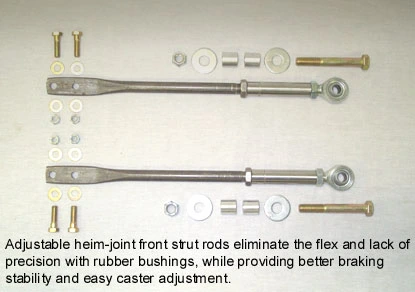

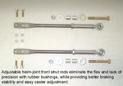

It looks like the kit from cobraautomotive does not use any reinforcement for the rails. Is that right? Anyone got pics of an installation using this method (bolt going through the rails)?
pic of cobraautomotive.com kit
BullitFB,
So you cut and threaded the original strutrod ?
BullitFB,
the 4 washers in the kit are supposed to be the reinforcement. they go on the outside of the strut box. i usually see them welded on but i'm not sure if cobra automotive recommends they be welded or not
