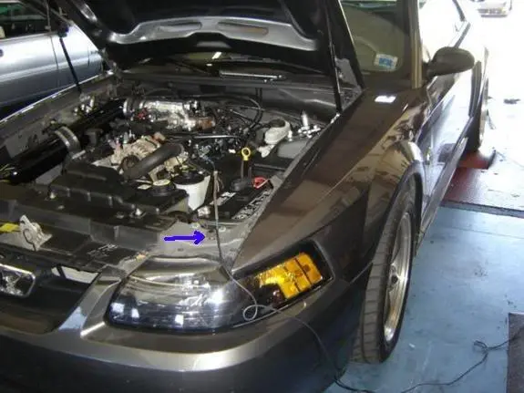

Do what I did. Got my cervini hood painted and installed and stressed the whole time after putting it on since I had to realign the latch. I finally went to Lowes and bought the heaviest shielded cable that I could find that would wrap around the hood latch and strung it through the frame below. I held the cable together with miniature U-bolts and a screwable lock link.
It's a pain in the butt to hook and unhook and still have it latch on the hood. But I can tell you that the peace of mind is worth it.
I don't like the look of the exterior hood latches so this is an alternative.

I really don't want hoodpins so the guy with the inside latch secure thingy share more info & pics :D
Here for reference, not easy to see though:
