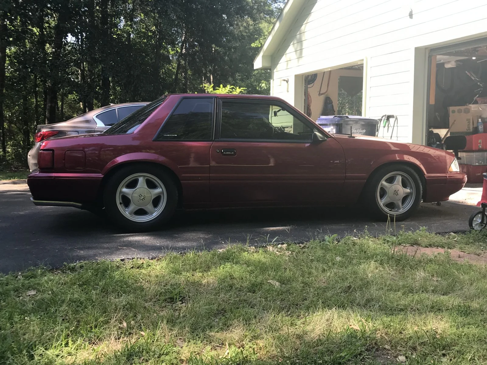

I went and got the coupe today. It’s cleaner than described. How often does that happen?!?
I’ve got a trunk load of trim, pieces, and parts to go on to complete the paint job. Hands down the nicest car I’ve ever owned. I’ll take more pics when I can.
Also, the tune is FUBAR. It’ll hardly idle but it’s an easy fix
