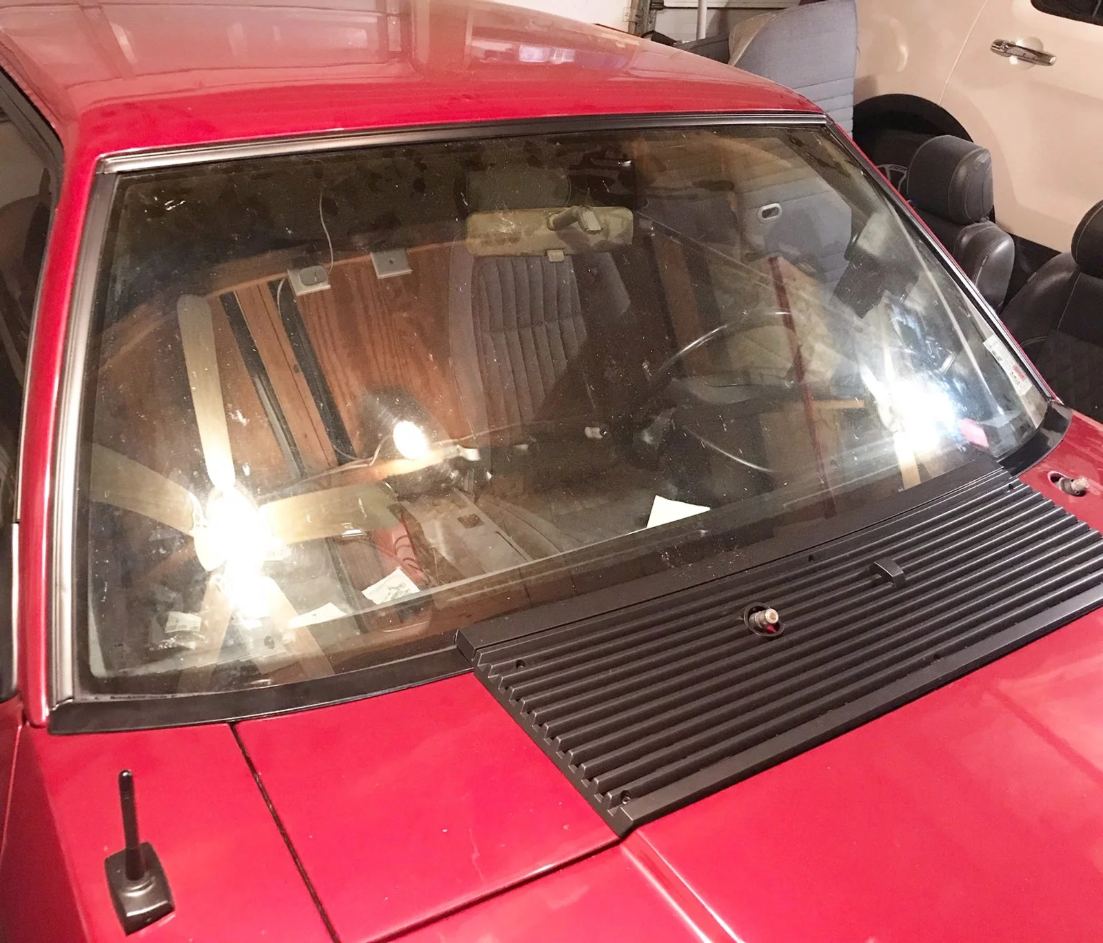

I got the front windshield trim stripped, painted, and reinstalled along with a new cowl panel and plastic bottom trim:

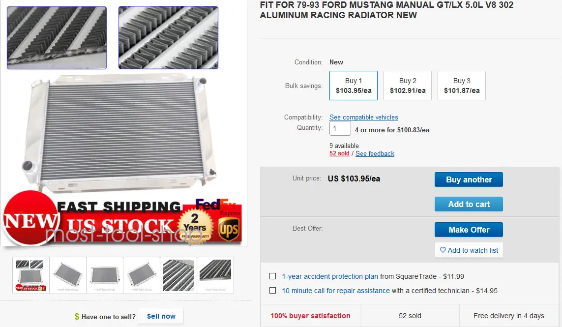

I also sold some P heads for $100, which in turn set my budget for a new radiator to replace the one that has a hole somewhere between the veins:
