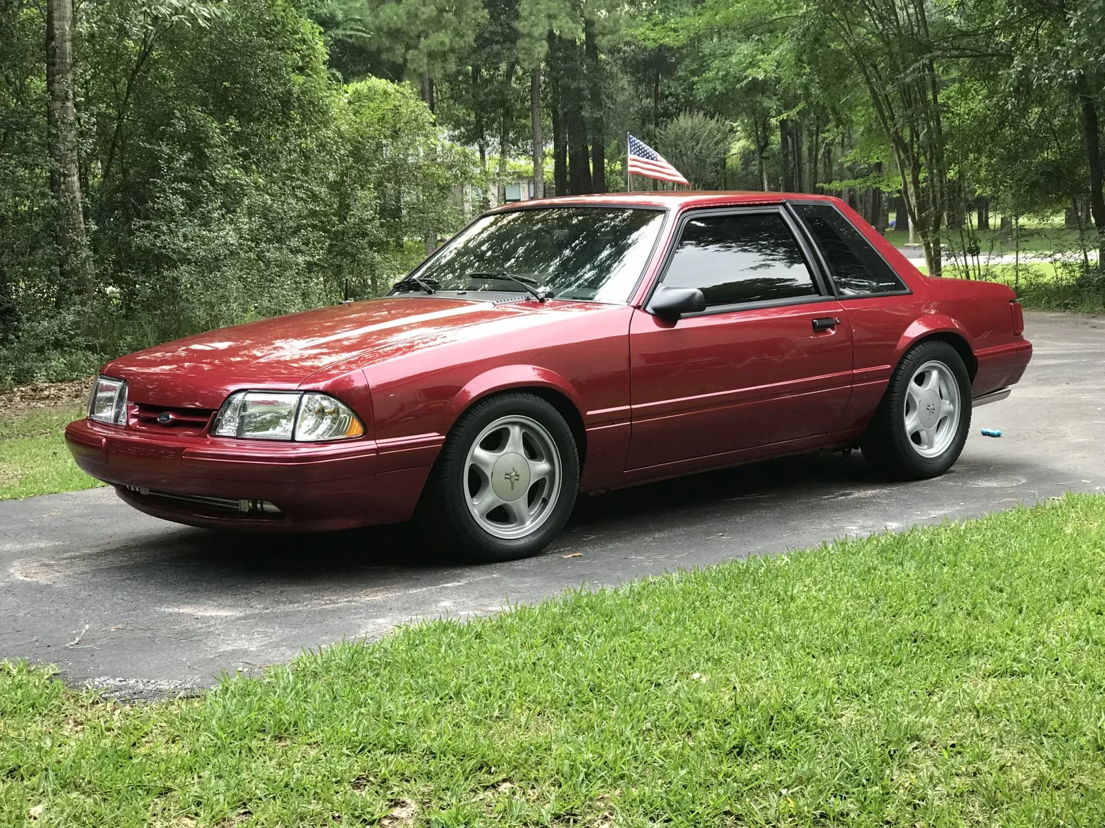

I've put the rears in. I'm not 100% crazy about them either, but I want to get the fronts in as well and see how it all looks. I got some fox seat brackets this weekend so I can start modding the s197 seats to fit. My wife is leaving this weekend, but not taking my daughter, so we will see how much can get done while yelling "dont put that in your mouth!" every 10 seconds.

That is a sharp car, by the way.

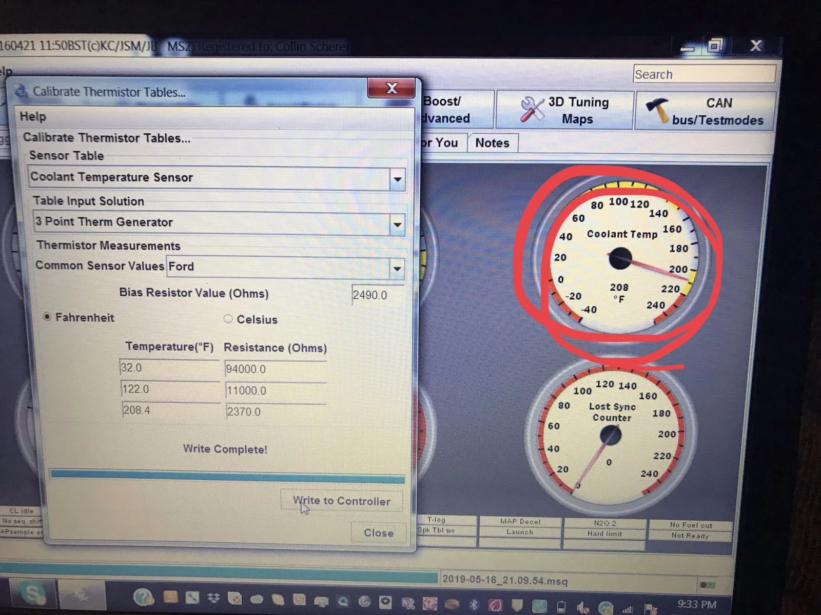

I should have license plates this week, so I can start getting some logs. I think the coolant temp sensor sht the bed, because the temp gauge is pegged at 250 in TS. I'm supposed to go to Dallas Wednesday, I haven't ruled out taking it yet. However, the start up and cold idle settings need a lot of work. It's hard to start and get idling cold now, but I think the CLT sensor may have a lot to do with that.
thats a good one, looks like it is reading the bias resistor value... basically its a voltage divider.. usually it will read 75* with the sensor unplugged. try that and see what she does, this could be bad wiring or a loose connection.
