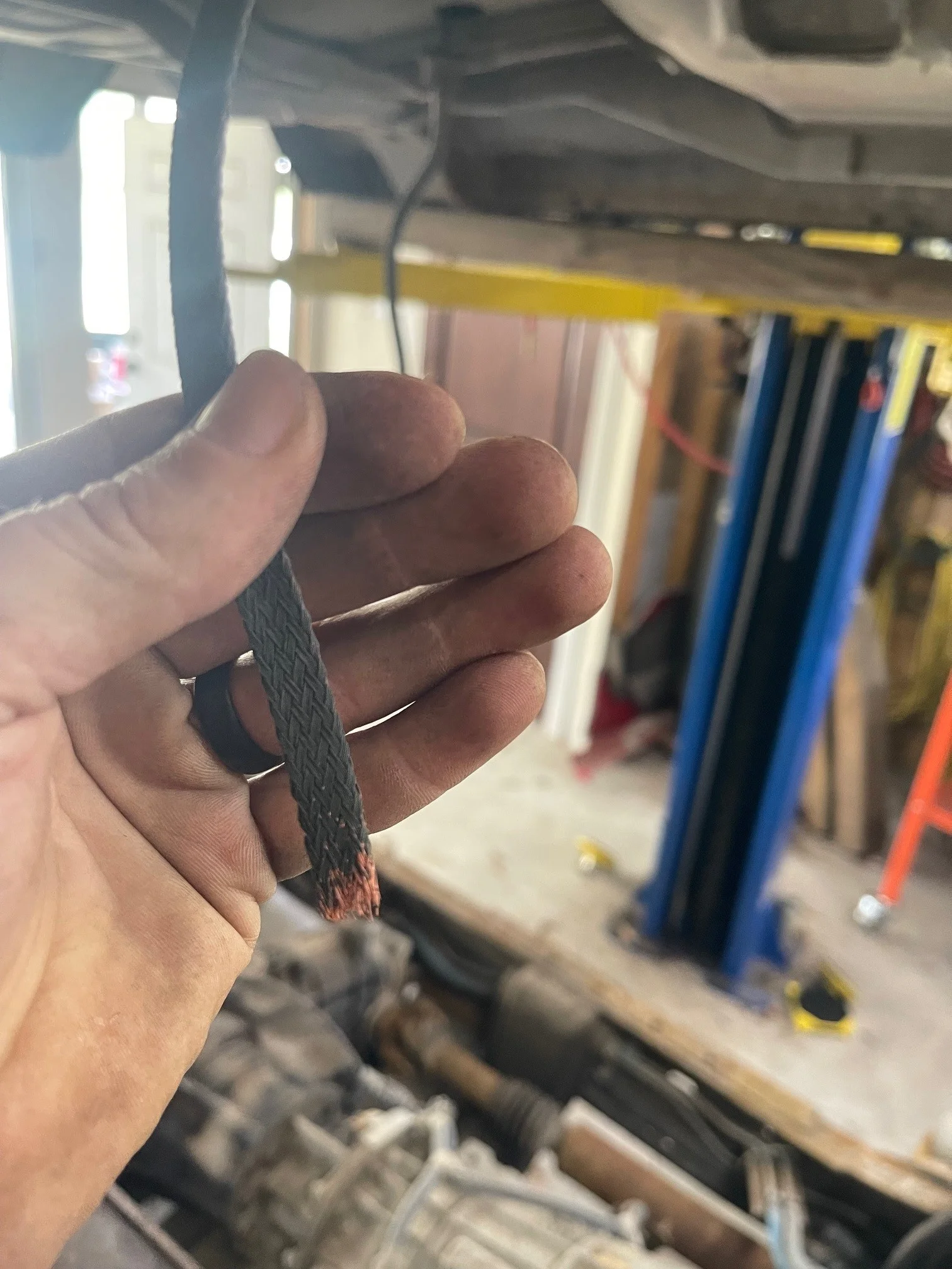

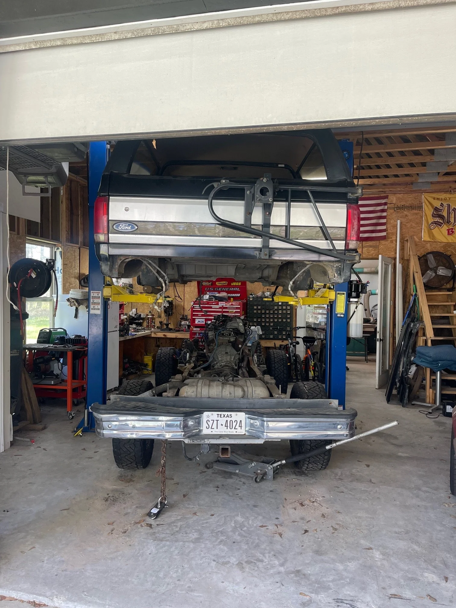

Pretty easy, only one casualty.

Ground Straps are overrated.
It appears that strap wasn't rated for the weight it was assigned to carry...

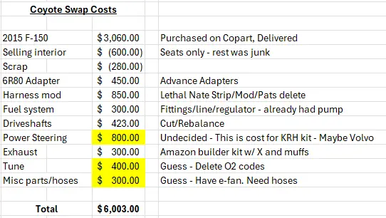

Apr 4, 2025
#1,497
  • Apr 4, 2025
  • #1,497
A tally of costs, so far. I really think you could whittle it down to $5k by re-using the old exhaust with the cats so no tune is needed. The power steering is the last remaining puzzle that I need to figure out. I dont have $800 to spend currently and its really bothering me that its such a cost.
I have chewed on the idea of making my own PS system but not ready to jump off that bridge yet.
Reactions: 85GT4V
