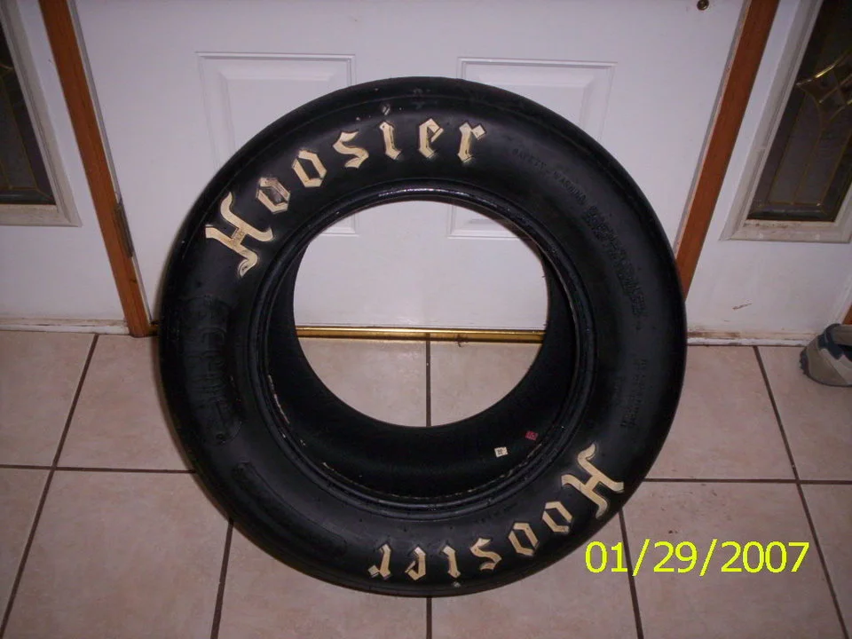

Hoosier 27x10 full race slicks. I have some questions.
Some people tell me that I'm going to bog out bad and that I should run it at 20-24psi with a massive burnout so I can avoid it. And others tell me that I need to lower it to 11-14 psi and do a massive burnout as well.
I went to the track on Friday and left it at 15psi and did a very mild burnout, no smoke at all, and I spun all of 1st gear. Now this tells me that I need to lower the pressure and do a heavier burnout, but some tell me otherwise. I didn't get a chance to run again, ****in rain. I was really nervous that I was going to break something and that is why my burnout was quick and smokeless.
The reason why I bought these tires was because I got a steal for them ($125) and they only had 2 passes. The 'holes' are brand new. The guy who had them bought them off his uncle whom ran them twice on his Nova. This guy had them sitting for I don't know how long in a tool shed, so he never used them.
What are your guys opinions? I know it's best to try, but I just want a heads up.

These are just like my slicks. When I had them mounted, no tube was used. The pic you posted look like mine, but I don't think mine wrinkle like that. The side wall seems too hard.

Redsnk, that is exactly what happened. I went with lower psi everytime and it didn't help.
13.55 @101.13 with 13psi and a 1.89 60's
13.43 @ ??? with 11psi and a 1.79 60's
13.57 @ 101.25 with 9 psi and a 1.88 60's
I did massive burnouts and it didn't help at all.
Not only did I have crappy 60's, but the tires stole almost 3+ mph. With some loaner et streets on 8" prostars, my 60's were consistant 1.72s and a best of 1.68 and I ran a 13.0 @ 104.78 and a 13.1 @ 102. I only ran the et streets 4 times, 1 time more than these and my times were soo much better. Nothing else has changed on the car. I really think these tires are TOO big for my car. I'm selling them!

One thing for sure is the height of the tire killed you. Your stock wheels are probably 25.75" tall or so and you bolted on a set of 27" tires....you really killed your rear gear, basically like making your 4.10s into 3.27s.
The tire I would recommend for you is a 26x8.5 ET Drag or 26x10 ET Street, these tires are the same size and will be adequate down into the low 11s. A 26x10 ET Drag or 26x11.5 ET Street will be too big for the power you are making.
I would also look into a set of MT ET Radials as well as they hook very well for a radial type tire.
Just for grins way back when my car was stock, I think back in '99. I had full exhaust, gears, and mass air meter on drag radials the car ran 13.40s. I bought a set of 26x8.5 ET Drags, ran then around 18-19psi and ran some 13.20s-13.10s...they worked pretty well.
I have some 15x10 prostars, so I'm going to HAVE TO get the 26x10 et streets, they're really what I'm looking for. The et streets I had borrowed were 26x11.5 but were mounted on a 8" wheel. Do you think I should sell my 10" prostars and get some 8"? So even on et streets you're saying that I need to run 16+ of pressure. Everyone keeps telling me to lower it as much as I can. What's their misconception?
