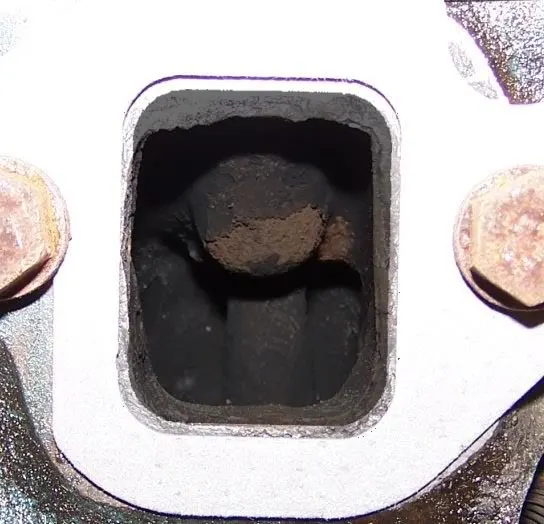

The 289HP manifolds will increase power a bit, and 'shorty' headers a bit more, but if you leave the heads untouched with the horrible stock exhaust ports, the improvement won't be worth the trouble of installing them.
You need to clean out the ports-and port-match them to whatever headers or manifolds you use.
This head had all of the excess flash, shown shaded, and the smog injector 'nose' removed, and afterward (using a C9OZ-C hydraulic cam) turned 321 hp on the dyno. With all that junk in the ports, no way could it have done that.
Don't even bother with headers or dual exhaust with crappy stock ports.
