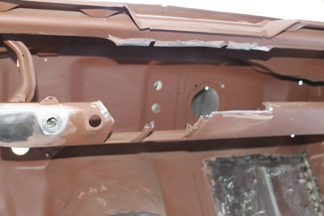

horse sence updated Horse Sense - 66 Coupe to Fastback Conversion with a new update entry:

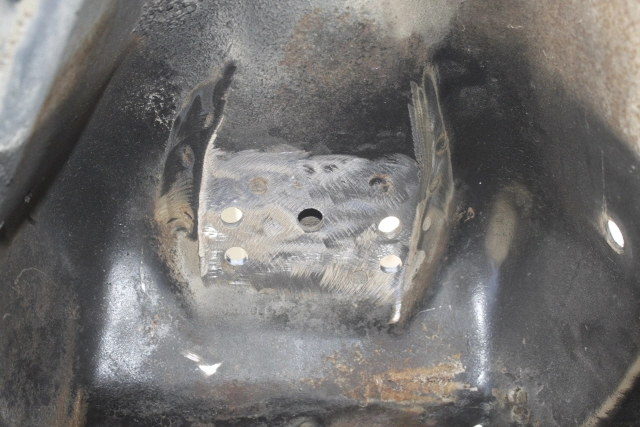

Aug.25 2013 upper a arm drop
i dropped the upper a arm mounting holes, 1 inch down and 1/8 inch back for 65-66 . simply one inch down for 67-70, you do not have to fill in the upper holes . start with a small bit so the holes don't wander off your mark then go to the larger bit . the a arm slides right in . there is a bit of flange around the holes inside the engine compartment that will have to be flattened so...

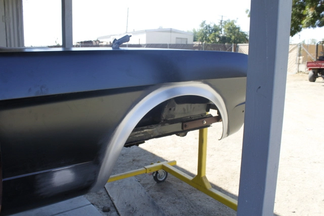

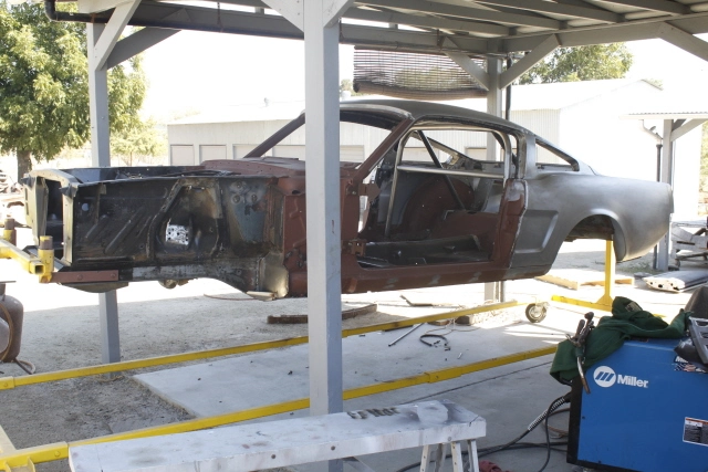

Sept 1 2013 sanded to bare metal
i haven't had much time to work on it , but i did get it sanded down. i was looking at it the other day and noticed blisters and lines in the black coating and the weld through so i sanded a spot .i found that there was writing under the coating in either felt pen or grease pencil so the coating didn't stick. i sanded it off with a D A sander. this is realy...

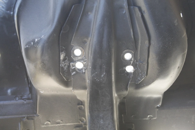

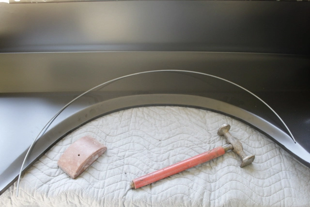

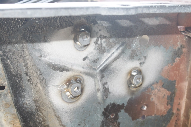

Sept. 1 dent ...BE GONE!
i just could not stand it ,that dent had to go . i got out my stud welder ,another Harbor Freight goody. before you can say weld, it is welded .the tool i made from an old pop rivet gun .it pulls the metal up flush with the surrounding surface and stops. it took 6 studs and about 30 minutes and the dent was gone. a light brush with a file and it was almost perfect . no bondo will be needed. i hate bondo:nono: this thing works great on creases and dings but you need clean metal to weld .

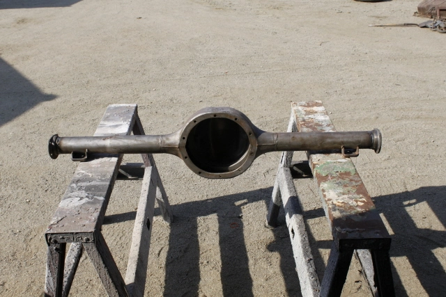

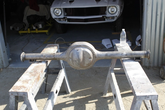

Sept. 12. 9 inch rear housing
i am still waiting on red oxide primer ,because every thing i order has to take forever to get here:fuss:, so i narrowed a 69 9 inch to 66 width. its pretty easy .just jig it up in the band saw so it cuts true, and then take the bearing retainer and ckuck it up in the lathe and cut it loose. two inches come off the 69 housing each side then the bearing retainer is cut down in the lathe to 1 inch and pressed back into the axle tubes with a...

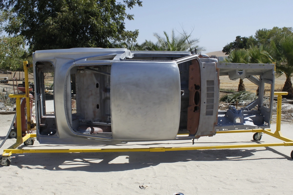

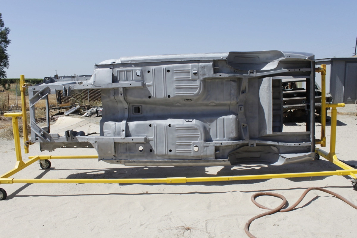

Sept.20 it is blasted
4 1/2 hours ,doesn't sound like a lot of time but try holding a 2 1/2 inch high pressure hose with 90 psi at the nozzle for 4 1/2 hours and see how you feel :drool: i am beat. every thing cleaned up real nice. but the engine compartment,was a PAIN IN DA BUTT!! some one painted it with some kind of rubberized paint:fuss:i like to never got it off. i used 5...

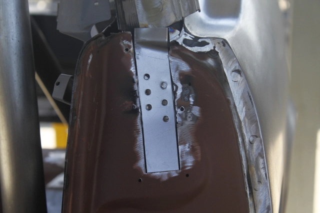

i went back down to the shop last night and sealed all the seams. i would have liked to have sealed every seam on the car but 4 tubes didn't go as far as i thought it would. i at least sealed the floor ,around the wheel tubs and the cowl and fire wall so there will not be any leaks.

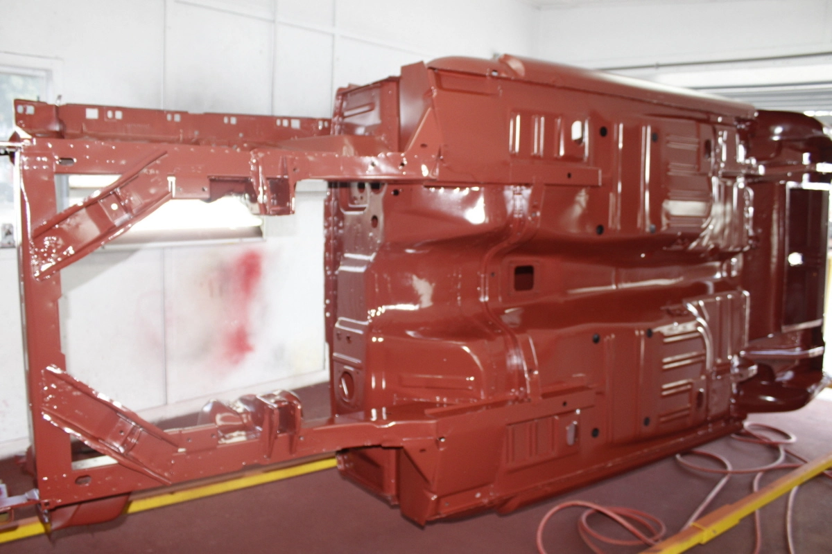

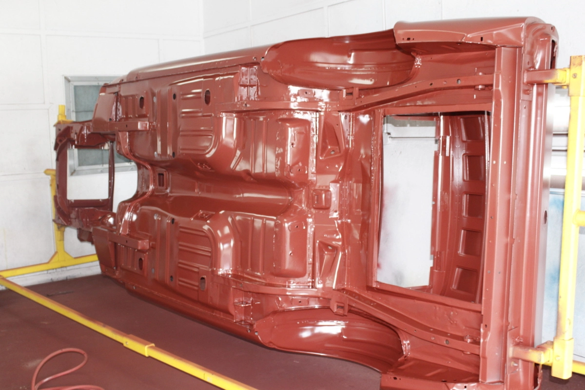

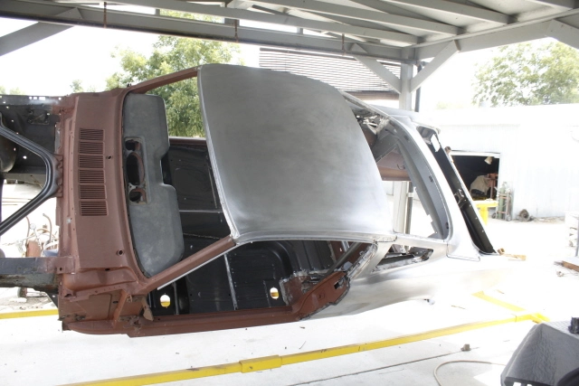

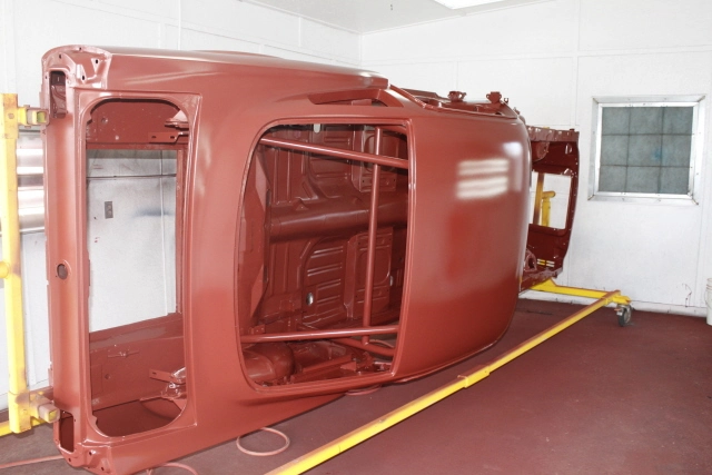

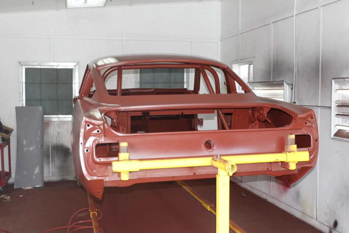

Sept. 22 Aint she purdy in brown primer?
i got it primerd to day .i love this primer . it is about the stickiest stuff i have ever seen .couldn't hardly take a step in the paint booth,my shoes would stick to the floor. i sprayed the inside and outside first just encase it over sprayed,the out side will be sanded any way, it didn't. i sprayed the bottom last because it...

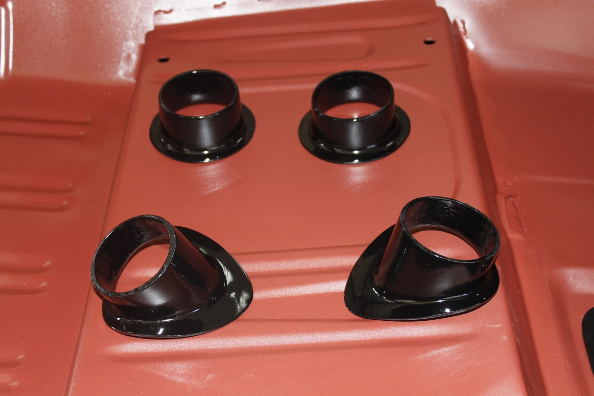

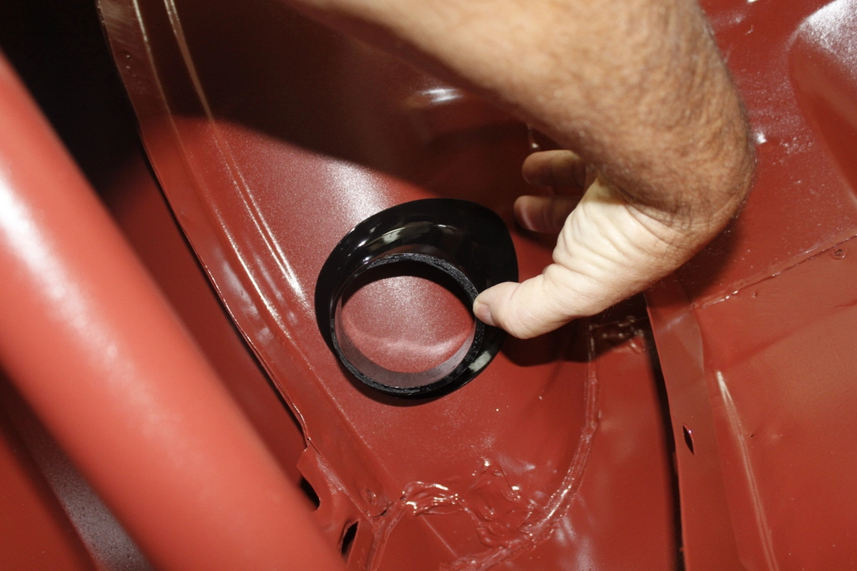

Sept. 27 brake ducts
i picked up the brake ducts yesterday. i have to get a new 3 inch hole saw ,i want a nice clean cut hole. i thought i had a set of side scoops but i cant find them so i will have to order a new set. the flat bottom duct goes in the quarter scoop and just pop rivets in place ,on the inside of course. the curved pair go on the inner wheal tub from the inside and just pop rivet as well. i will seal them with...
