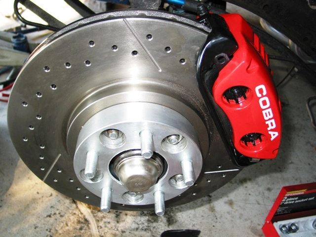

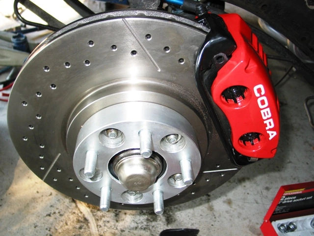

another "add-on" option
There is a company called Muggzi Performance www.muggziperformance.com that has "bolt-on" replacement rotors for your car that Crossdrilled & Slotted.
These do not require larger rims, 14" are fine, and it is a straight bolt in peice that replaces the factory rotor, works with all your factory components (calpers, wheel bearings, etc.)
I know they keep these in stock for all years of Classic Mustangs.
I have a set on my 70 Mach1, and I found I could brake a little later, and less brake fade. Alot cheaper than an aftermarket brake kit.
Probably good for the occasional lapping day, but the stock brakes I don't think are up to high track usage unless you under "period correct" rules.
Just thought some of you might be interested.

uh oh, here we go
(begin side thread about how Wilwood and Baer both say crossdrilling and slotting were for older pads that offgass, but newer high quality pads do not and so crossdrilling and slotting are a waste of money and crossdrilling can weaken the rotor and overall all this reduces the surface area of the rotor that acts as a heat sink and pulls heat AWAY from the brake pads and gets cooled by the wind)
:banana:
seriously though, they do both say in their FAQ that crossdrill/slot are for bling. The one thing about slot that might be nice is that they can "wipe" the pad and give you more even wear, it's like a scraper but would wear down the pad faster I think. Anyone else care to comment? :rolleyes:
Drilling and slotting just looks good, only reason I spent the extra $35 on my 13" rotors.
