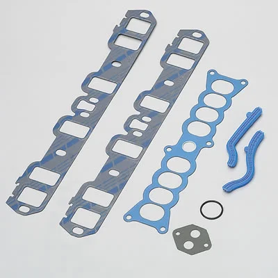

I DO use the end cork gaskets
I use 3M weather stripping adhesive to glue the cork gaskets to the block
After they are nice and dry, I screw a section of all thread on each corner
of the heads
That ensures the intake will be lowered straight and not allow the
gaskets to shift or be knocked out of place
