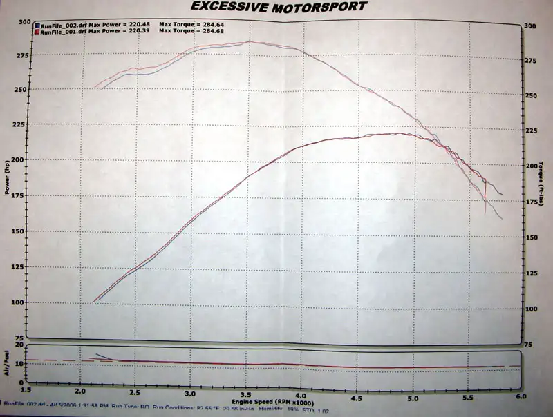

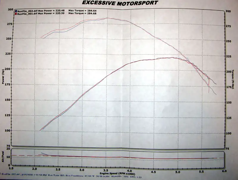

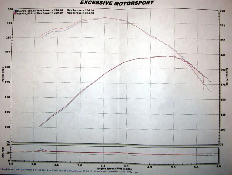

My car at the time only had an O/R H, Catback, Pullies, and 12* of timing and put down this.
wow, thats quite a bit of HP gain from just some basic mods. Ill be addin an exhaust, suspension and gears hopefully next week or so and Ill see where Im at. Not used to such big gains (Honda as daily driver :o )
