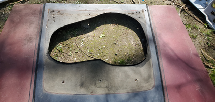

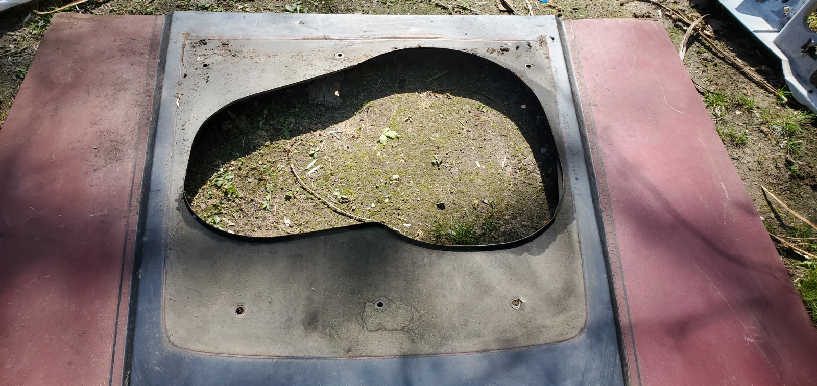

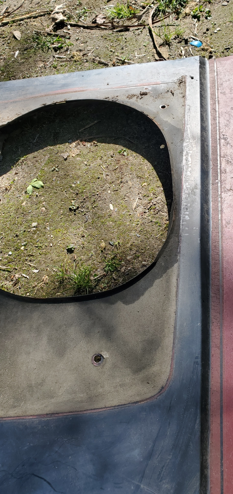

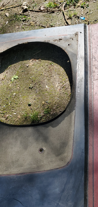

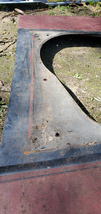

That factory hole was never functional. I think it was for clearance of the air cleaner (maybe). In your pic it looks like there is a lip around the edge to help keep some water out of the engine bay. That is the main reason I suggested something small for an opening. If you are only trying to vent some heat, you don't need much for an opening.
@mattys91gt The area of the hole below the scoop (A = Pi r squared if circles) should be equal or greater than the cut out in the scoop front (A=L times W).
If you want help with the math, bring the measurements of the holes . We have been through reviewing algebra and geometry with two kids since Covid started. :bang: Might as well use it for good.

What’s the other side of the hood look like?
I am hoping it’s still handy and it was a factory install. I only had the scoop to retrofit on an LX.
here's more pics I had of it

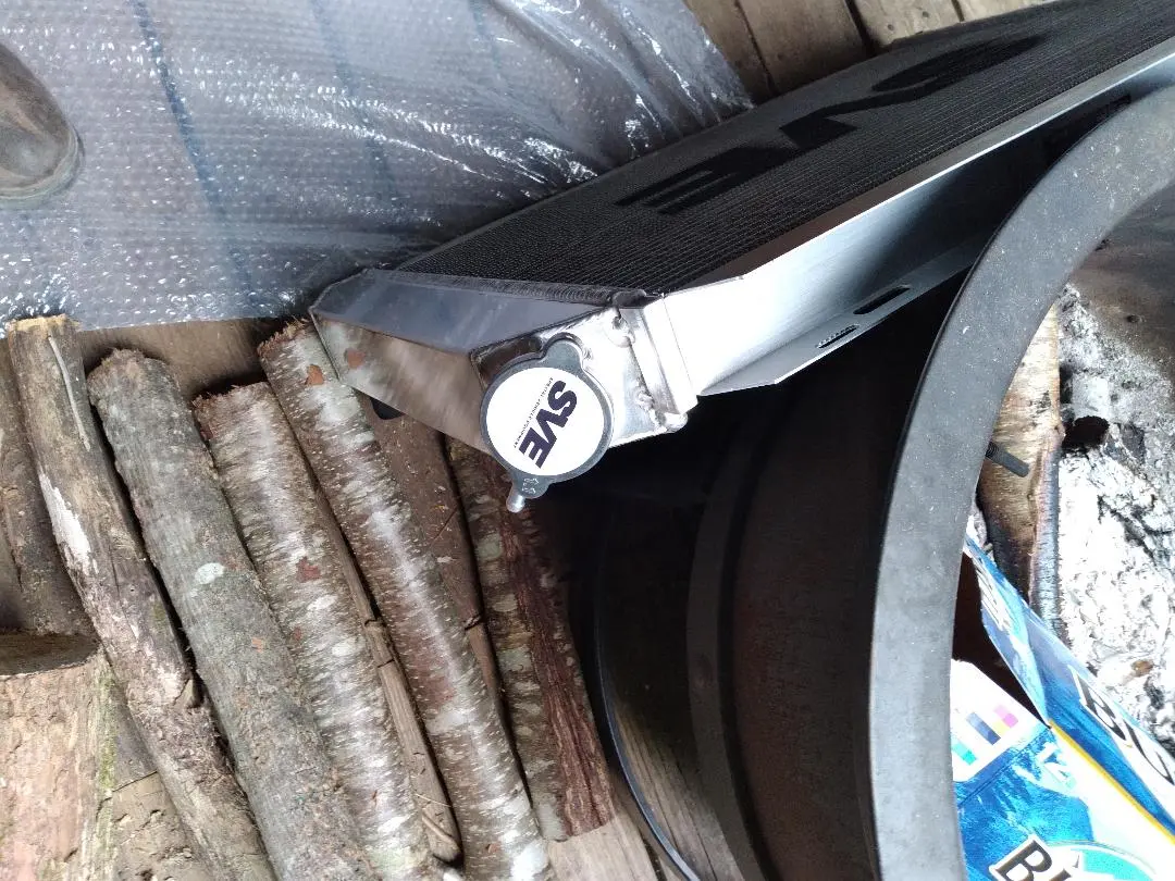

i just bought a sve rad for my 89... installing it today... i also did a flush on it ysterday...

What problem are you trying to solve here? Seems like a lot of effort for something that others don’t have an issue with. Engine bays get hot. It’s still going to be toasty in there no matter what you do
I just saw this lol I never took that in high school I'm the class of 2000 I was at a tech school for autobody I had all simple classes and out in the field working in 11th I'll have to show my wife's kids and see if they know
Classic case of 'Over Thinking'

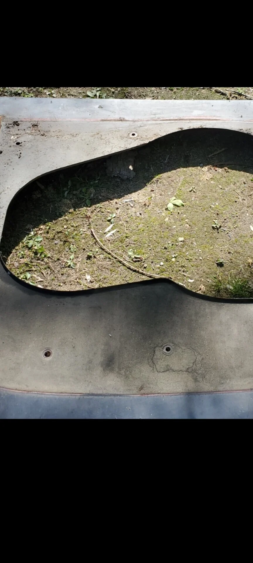

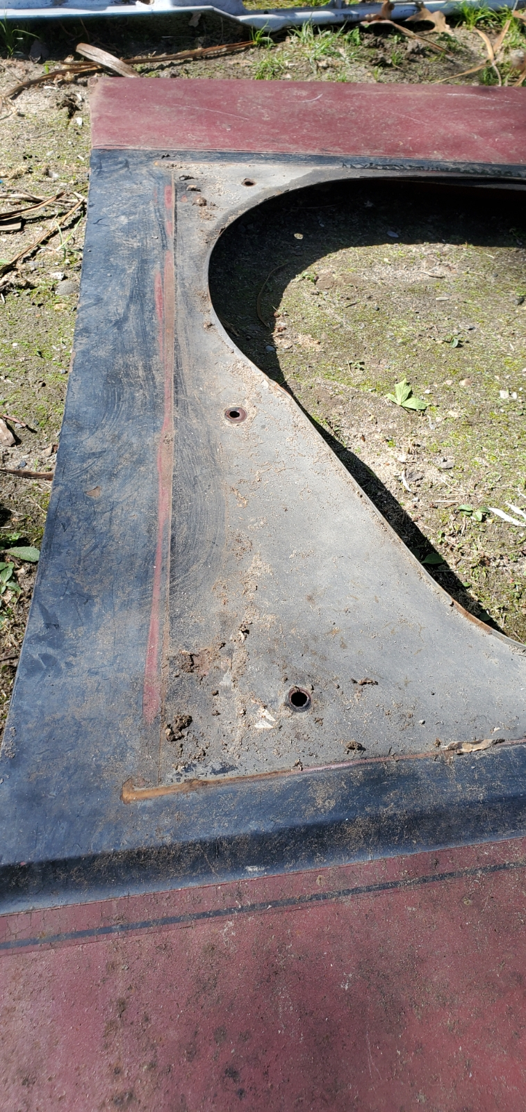

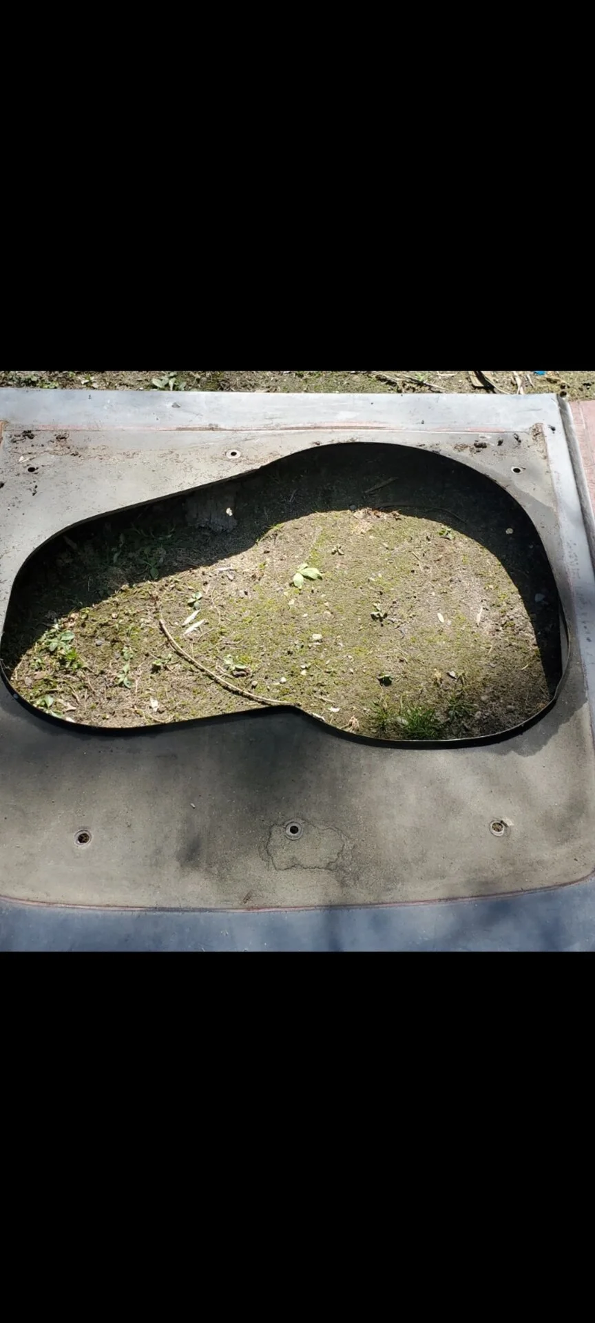

Install the scoop with the opening to the rear of the hood and drill 3 or 4 round holes or a slot a few inches wide, the width of the scoop in the hood under the front edge of the scoop and call it a day.
Drill/cut holes or slot in the hood under the front edge of the scoop, wish I could draw a pic, look, if you want to effectively get air out the holes/slot should be between intake and the radiator but the scoop opening in the back needs to be as close to the back of the hood as possible, still the effect likely will be minimal.
Pay no attention to the opening in that hood the scoop came off of, that is designed to let air in not out and it's for a carburetor.
I came send u my email or with the hood pic if u take a screen shot u can draw on the picture
