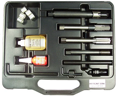

If you do have a plug blow out you can repair it with a timesert kit and there is other kits coming on the market to repair striped threads. DO NOT use a regular helicoil, this can cause a hot spot and lead to detonation.

If the threads fail use a Time-Sert to repair it.
++TIME-SERT Ford Spark plug Thread Repair Kit

AND guys..that Time Sert kit looks expensive!!! I simply bought a cheap heli coil kit from Murrays on the HELP! rack for 11.99! It fixed my car great. It made dyno pulls after that, street races...etc. Never came back out. I also used loc-tite on the outside of the heli-coil.

i myself, just pray to the mustang gods (lee iococca and carol shelby) that this never happens to me. if it does, ill use timeserts to replace them. i have had bad luck with heli coils in the past, timeserts have never let me down.
