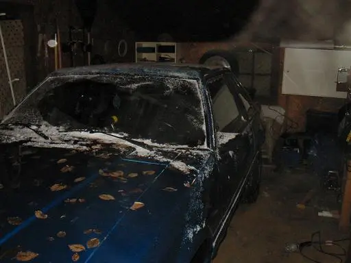

Thanks guys, i just jacked it up on the sub frame, one corner at a time. I wasn't sure whether it was healthy for the frame of the car to do that, but i guess its fine.
It was a tight fit, but it's better than leaving it in the snow!
