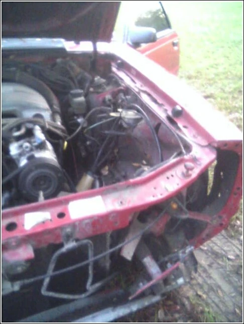

Hello I am doing a 4cly to 8cly convertion I want to change all the front suspention over to the 4cly with out killing myself can anyone help me with this and give me helpful tip on the convertion how to make it easyer ect.... Thank you all for you time and help. God bless
