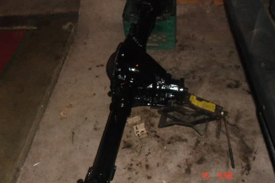

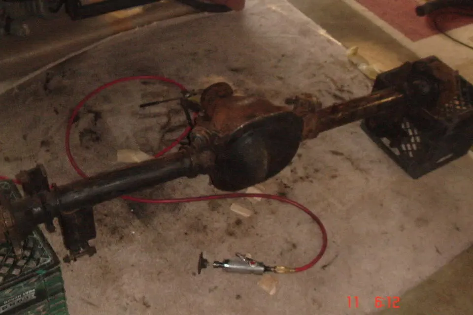

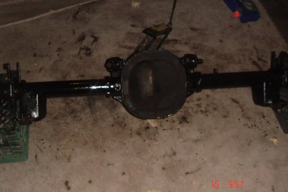

this the 96 gt rear end i picked up since i'm going to 5 lug conversion i took off the upper and lower control arms.it was sprayed with rubberized spray for rust protection.i started sanding it down and cleaned it pretty good.

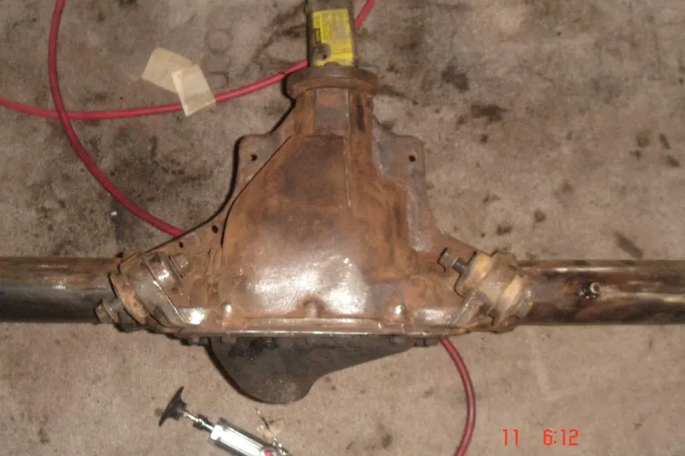

here after some sanding

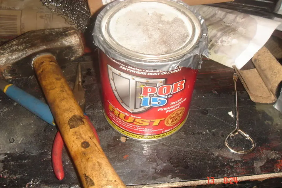

i bought some por 15
and this is the result i love this stuff self leveling and when i applied it with the brush no brush marks as if i sprayed it on.

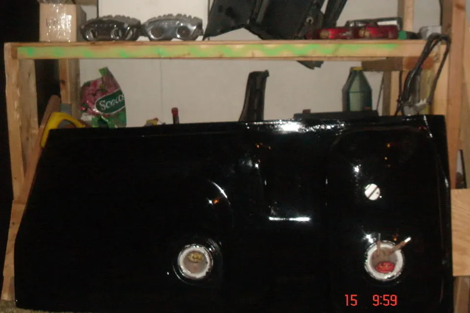

and this gas tank which was practically new barely used i plan on putting in a new sending unit

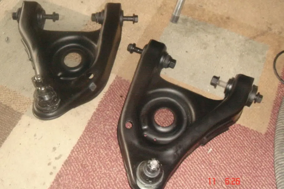

the A -arms as well i need to change the bushings

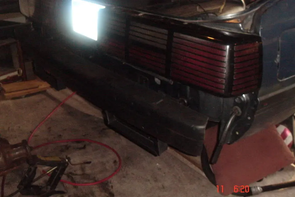

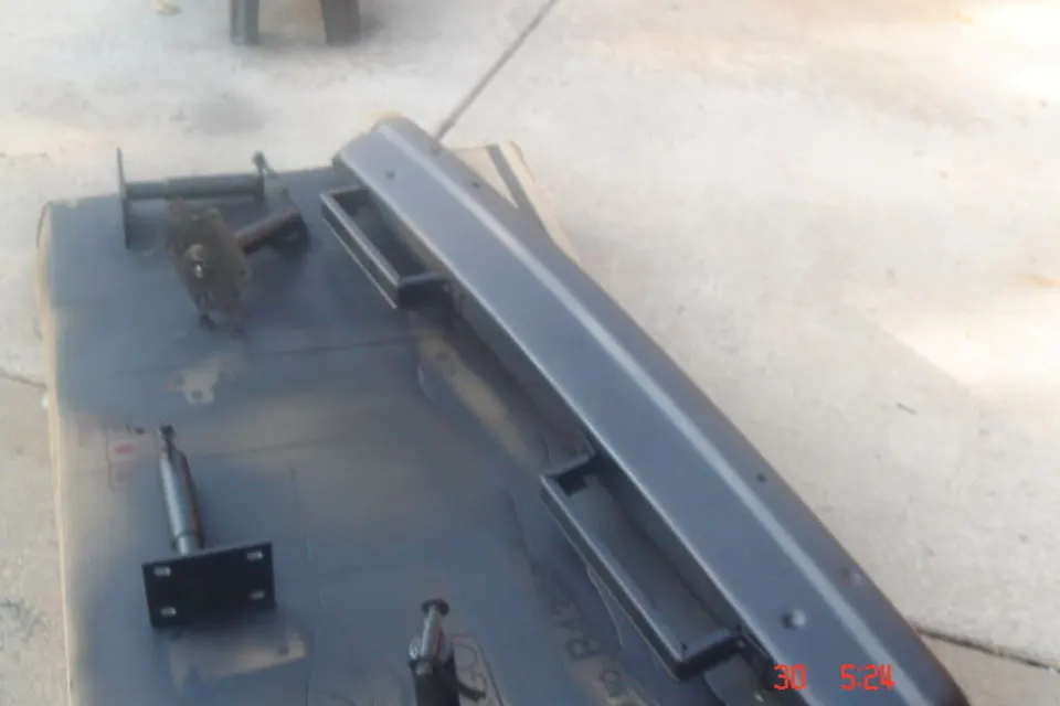

the rear bumper installed but i will have to modify the mustang gt brackets on the bottom since i have an oem cobra bumper and attach the bottom.

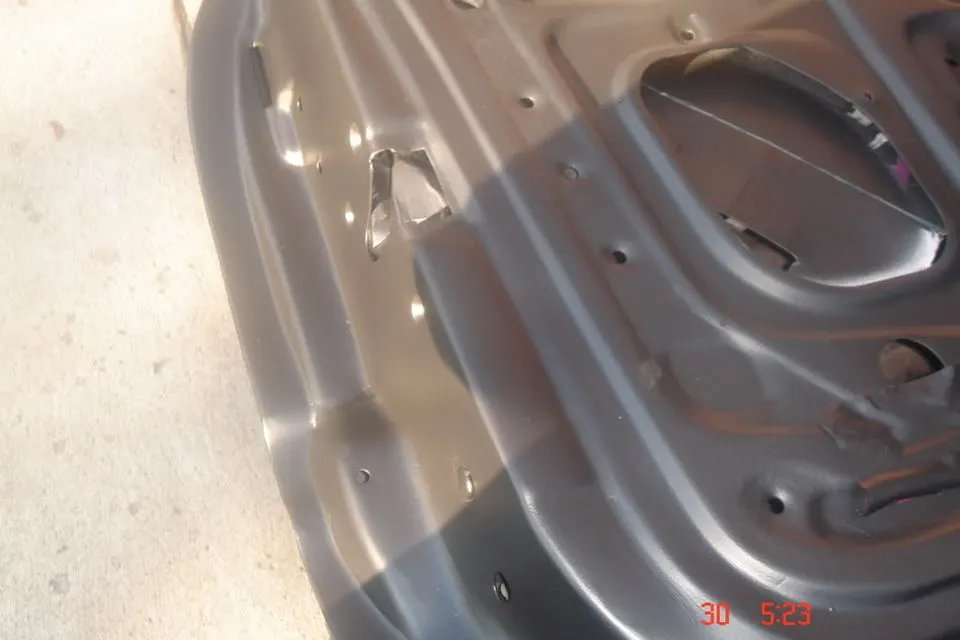

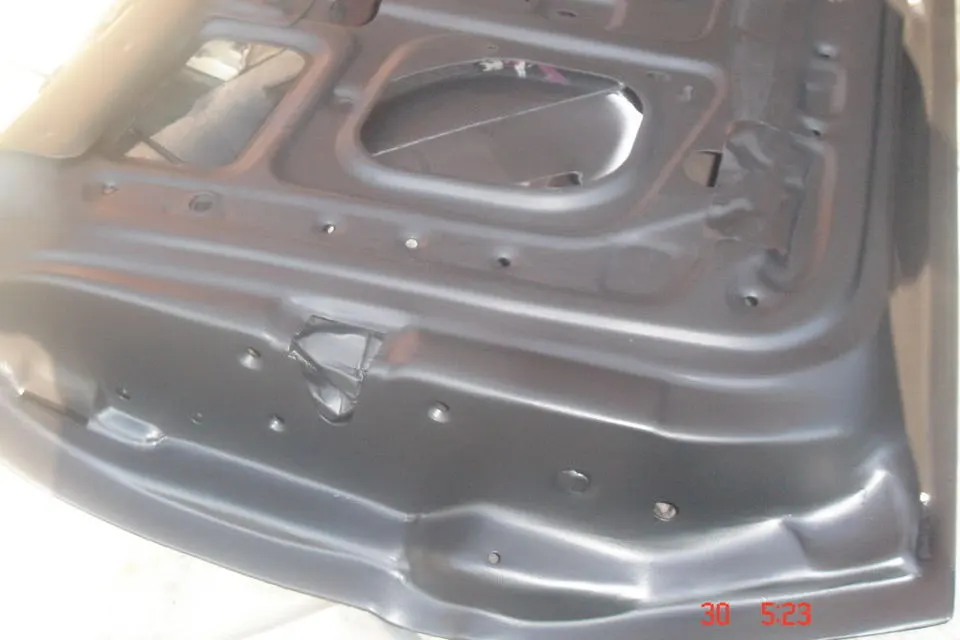

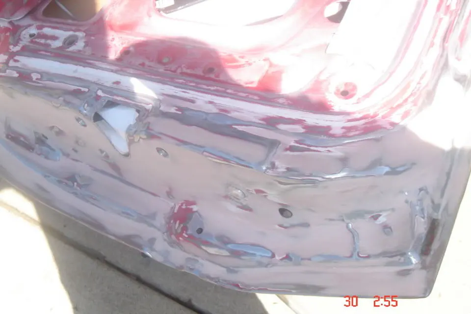

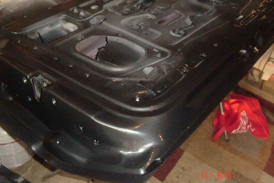

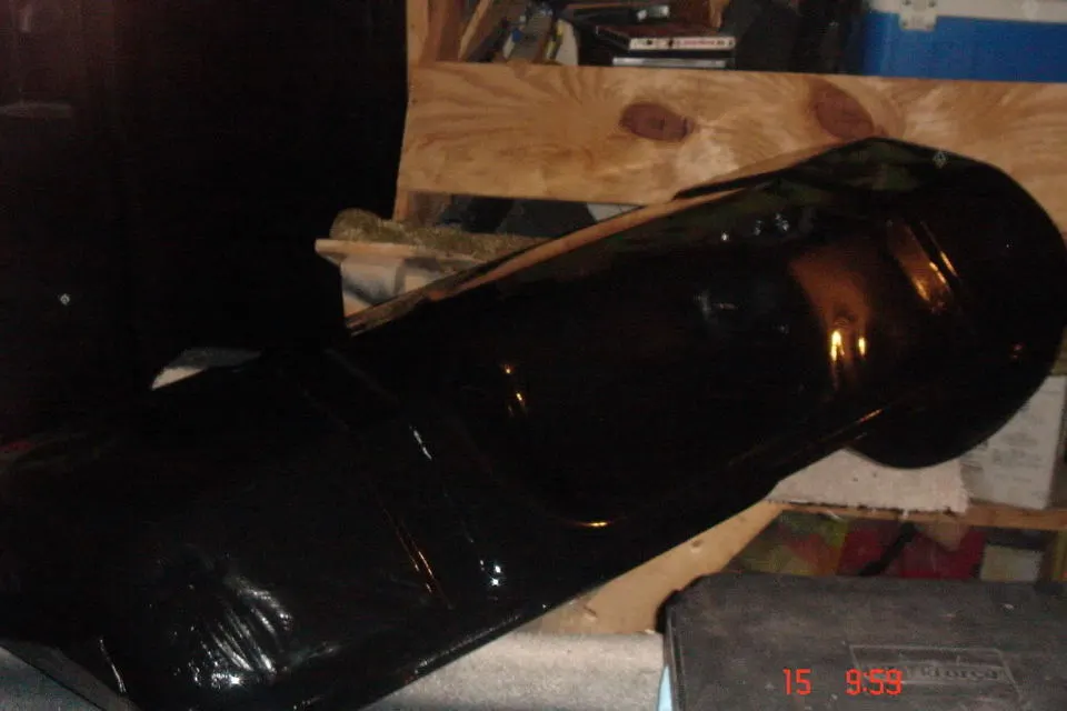

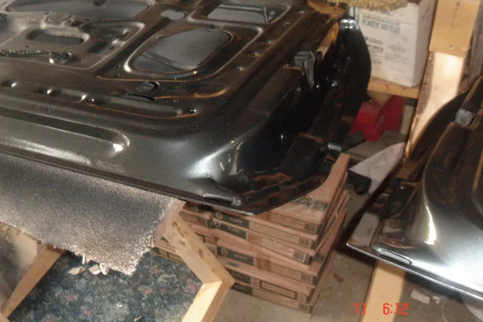

i finished working on my doors earlier this week i filled in the area on the bottom with fiberglass and then a extremely light coat of bondo filler.
and with paint

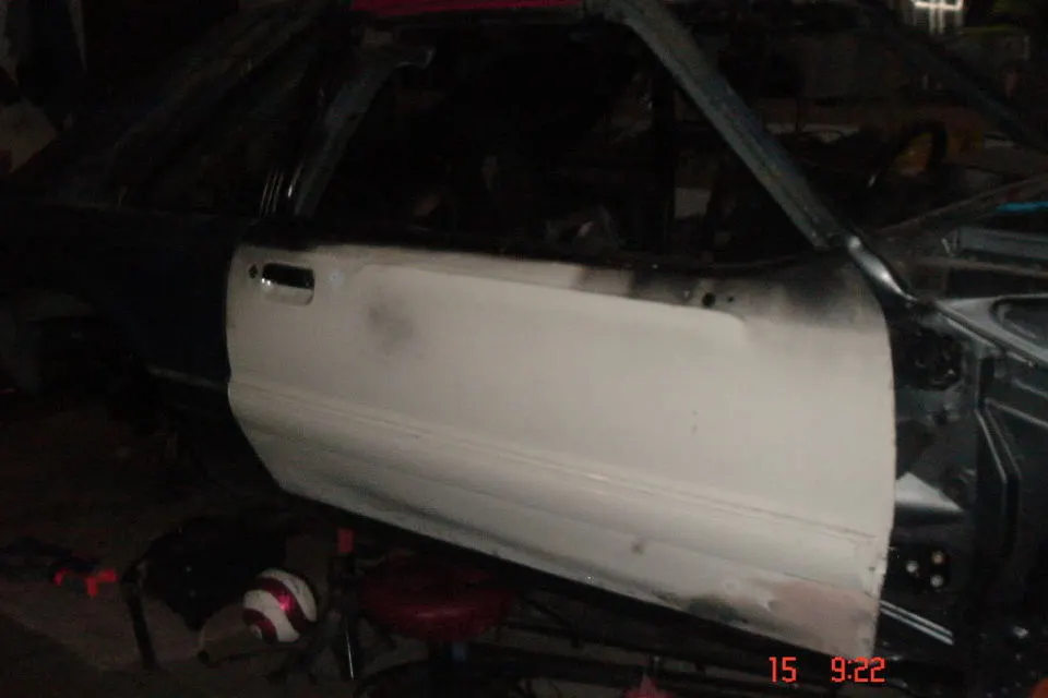

i finally tonight hung the passenger door and tomorrow hopefully will get to the driverside

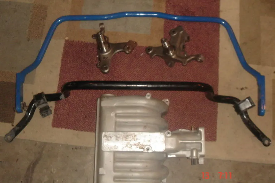

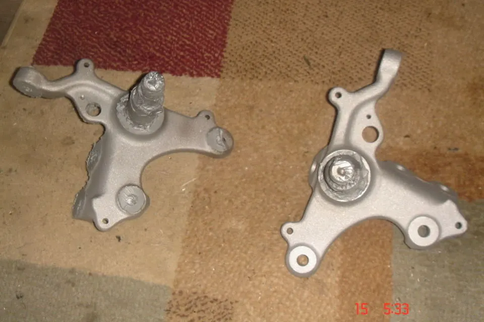

i had these sandblasted today these spindles are 93 cobra R and been sitting around in the garage and i saw a few rust spots.
i hope to epoxy primer tomorrow
here is a pic of the stuff i took to get sandblasted

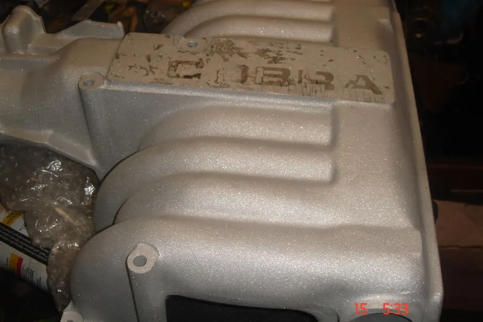

the upper intake after sandblasting
thats as far as i've gotten

thanks i'm undecided to shoot it with epoxy primer and a nice gloss black paint job or powdercoat it .i still need to get the valve covers off the car and get those done.
Make sure you heat tank or equivalent to the intake, im sure you would NOT want to get glass bead inside your engine
hey guy,
i'm not exactly sure what you mean by heat tank do you mean throw it in the oven.i taped the cobra intake with duct tape but my friend ended up sandblasting it off.:rolleyes:
there is fine sand in there right now i was going to hose it off real good once i got paint on it.
Looking good:nice:! I would say if nothing else take the intake to the car wash and run water thru it. If it is gunky and sticky inside then you will need to hot tank to remove the gunk but it may oxidize the outside depending on the cleaning solution used in the hot tank.
Scott
Scott
I doubt it would oxidize it, i cleaned my intake in my hot tank/parts washer/whatever you feel like calling it

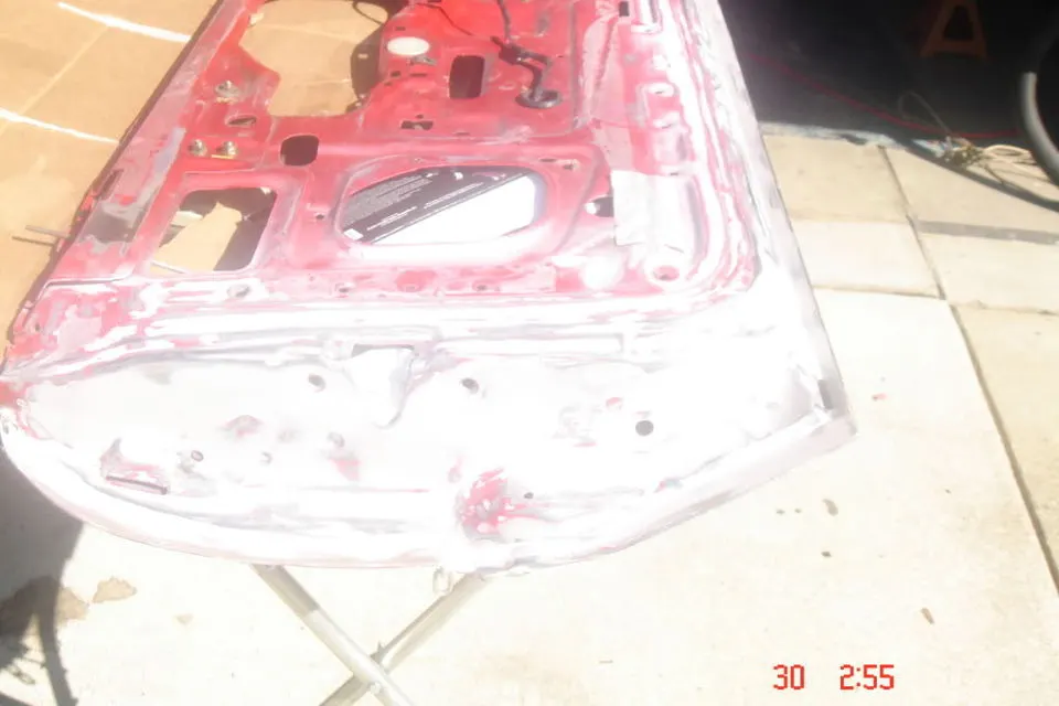

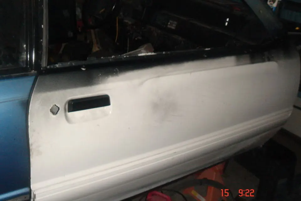

i had some rust on the corners that i had to remove and one thing led to another and i went overboard.i didn't like how cheap the doors looked so i put a light coat of fiberglass all the way around .if the doors are slammed there is a chance they could crack like anything else.i know its not like you can see on the bottom of the doors.i also as best i could put por 15 on the inside of the door and along the bottom as well.possibly overkill but here in michigan it could be nice and sunny and not a cloud in the sky and then start to rain.
Lookin good, although I have to ask, how come you smoothed out the door jambs? That filler that covered the hem is likely to crack from the door shutting and flexing.

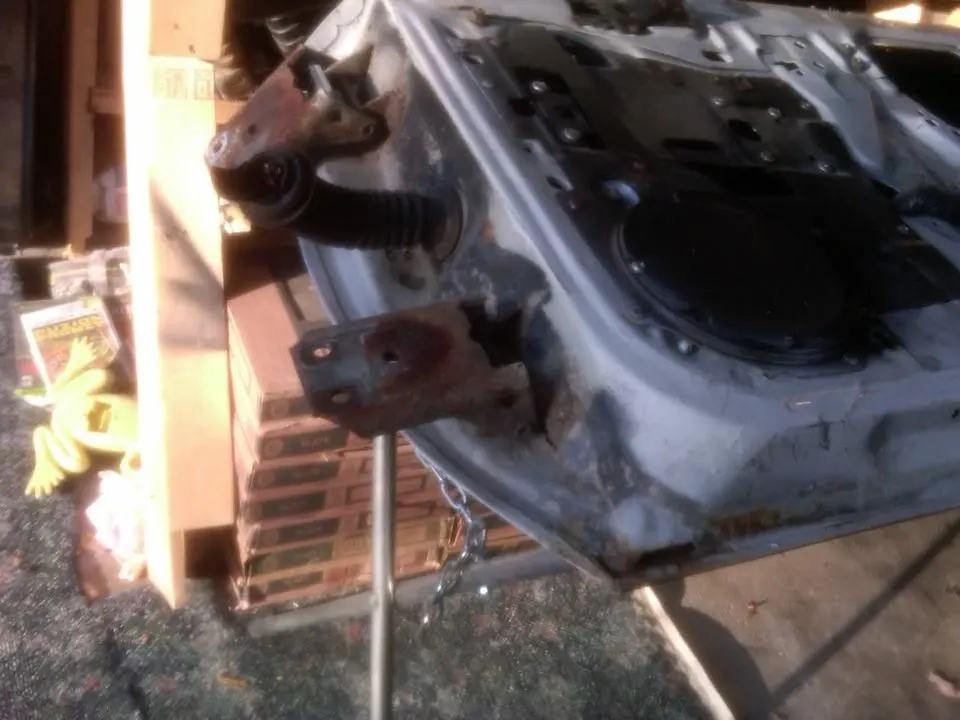

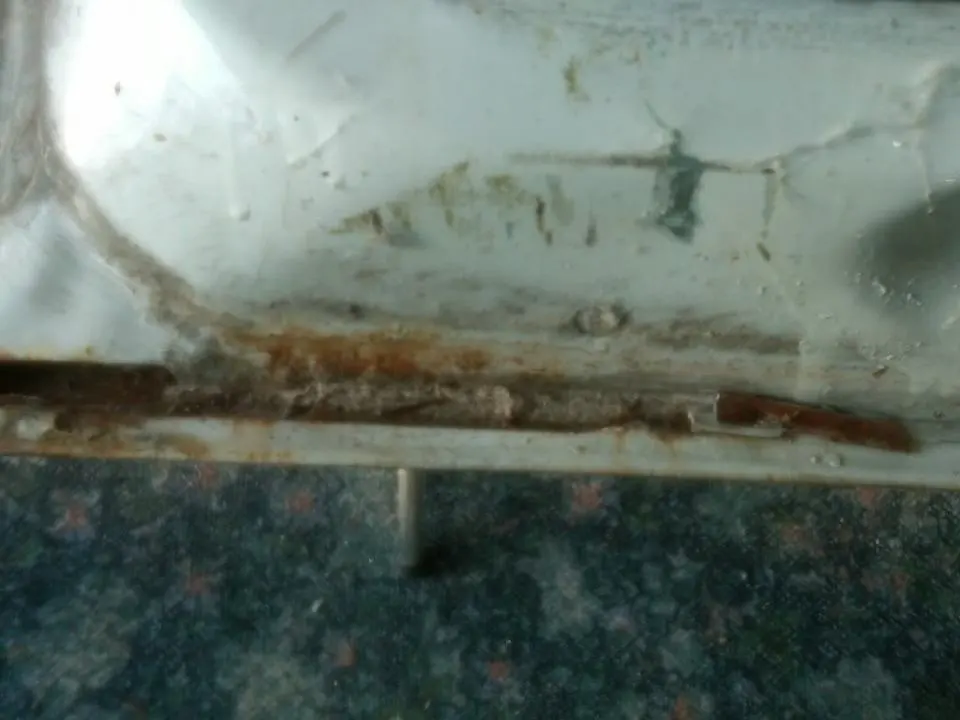

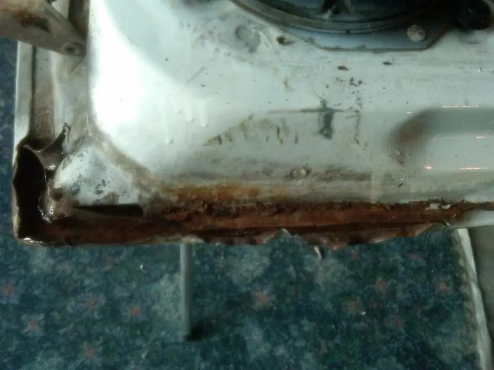

here is what i am talking about i should have just bought some new doors.i sandblasted them clean and cut out the metal that was bad and rewelded the area.
here is what i started with
here is a close up
and here after i peeled the skin back ouch!!!!!!!!!!

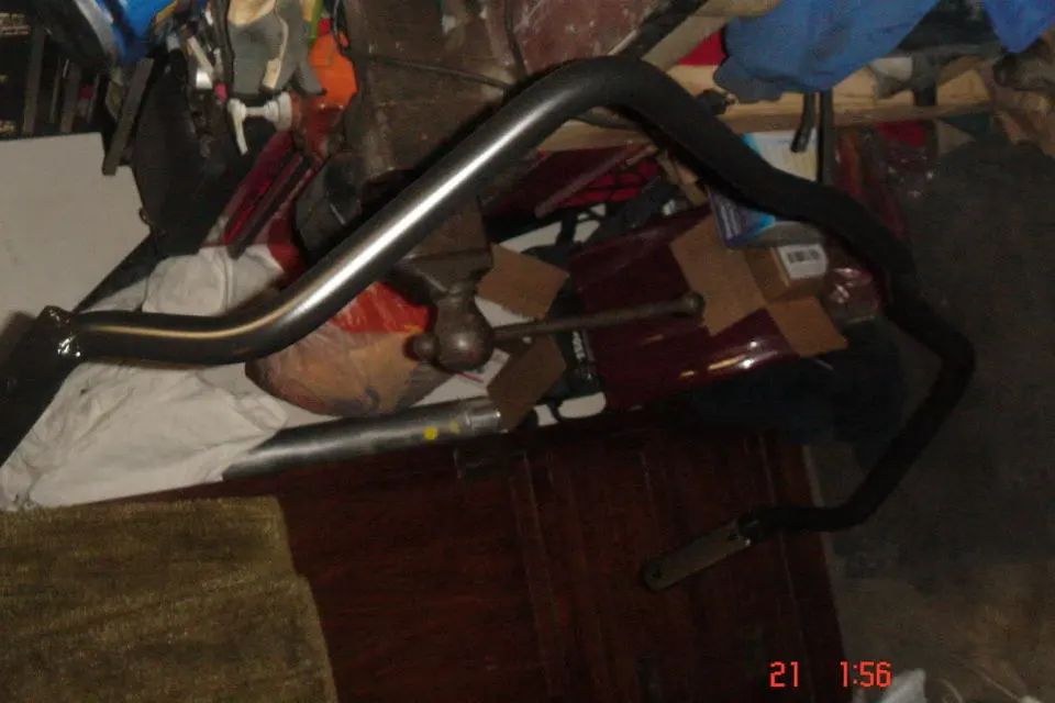

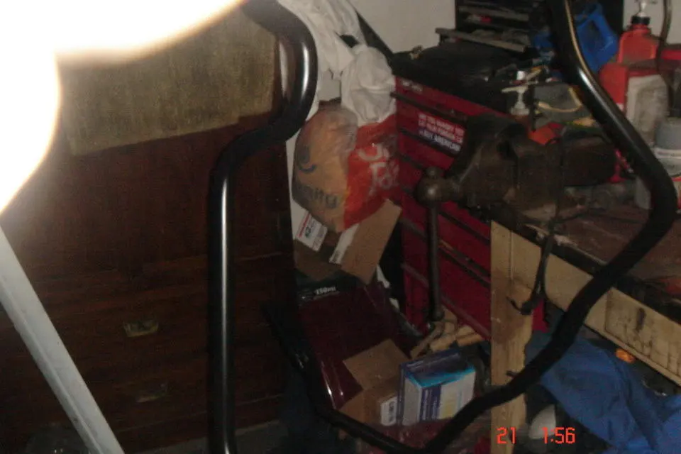

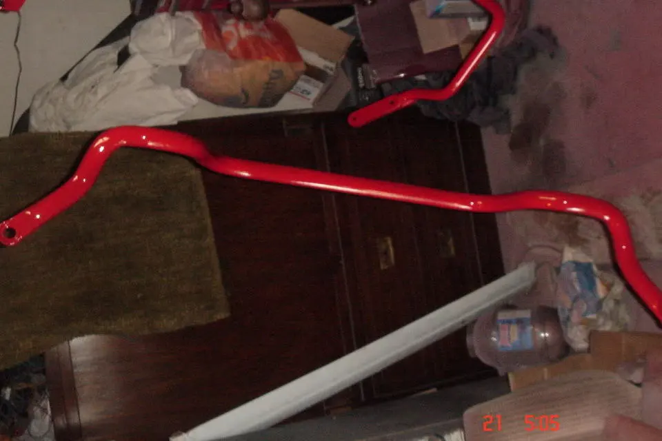

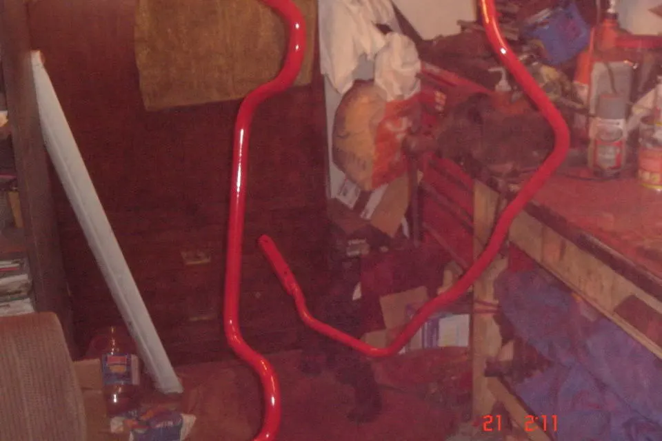

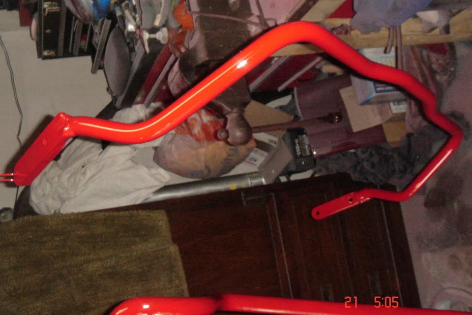

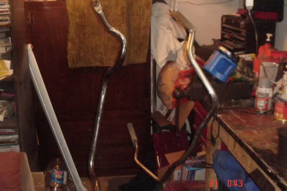

i did these yesterday the front and rear sway bars the front is a ford motorsport which was new and never installed but started to rust a bit on one corner where the paint flaked off. the rear is a steeda which was blue .
sandblasted and had a hard time getting the paint off so i took a DA to them
epoxy primered
and then paint and clear
i don't have any install shots hope to sometime this winter i am still collecting all the parts for my 5 lug conversion.
