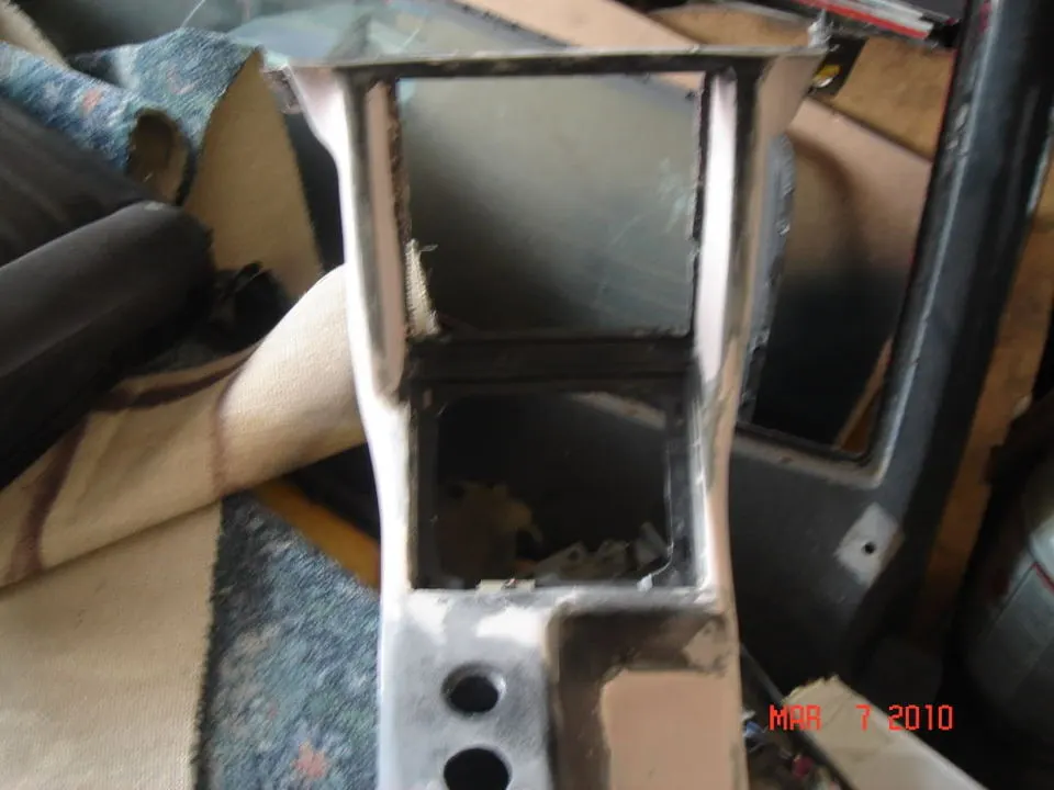

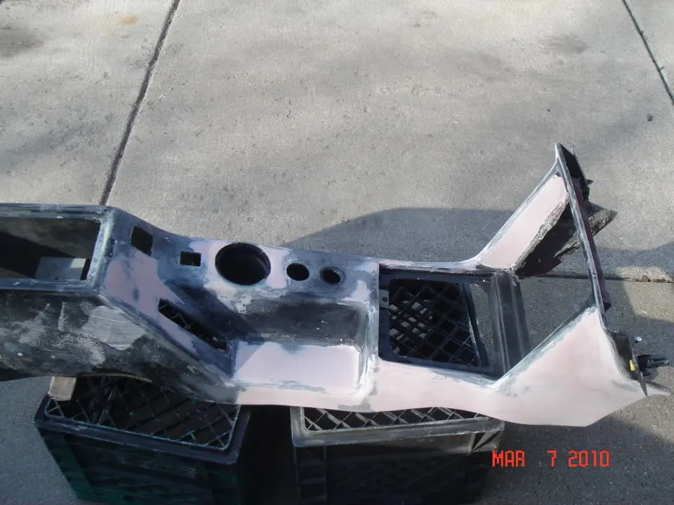

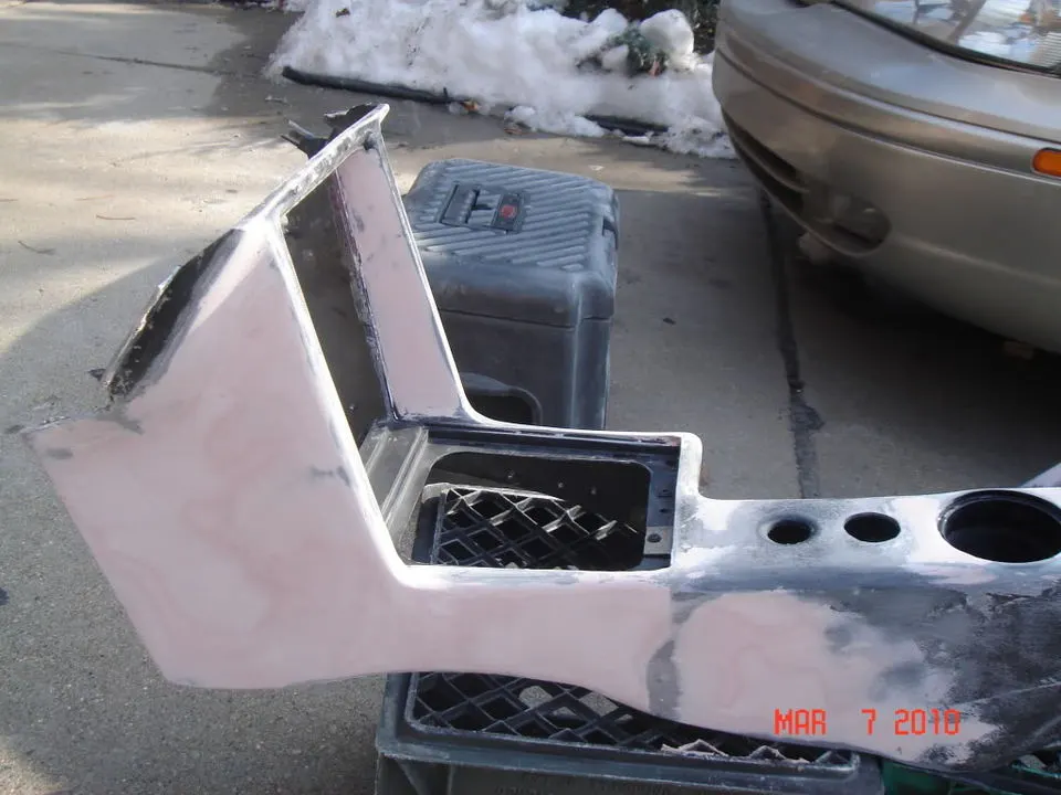

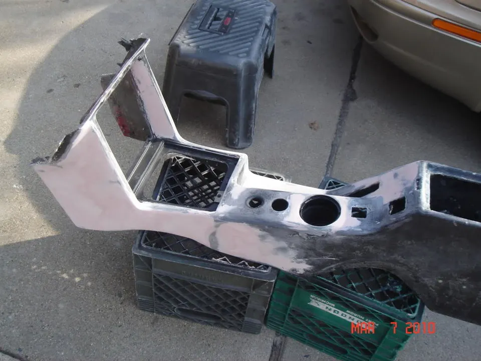

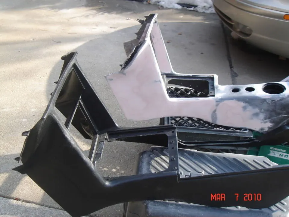

i have the center console all ready for leather i fused the back end of the asc mclaren center console with the front section . i also extended by 1.5 inches the front end of the console past the radio and smoothed out the lines across there. i placed a stock black one next to it so that you can see the difference.
sprayed it black before i wrap it in leather

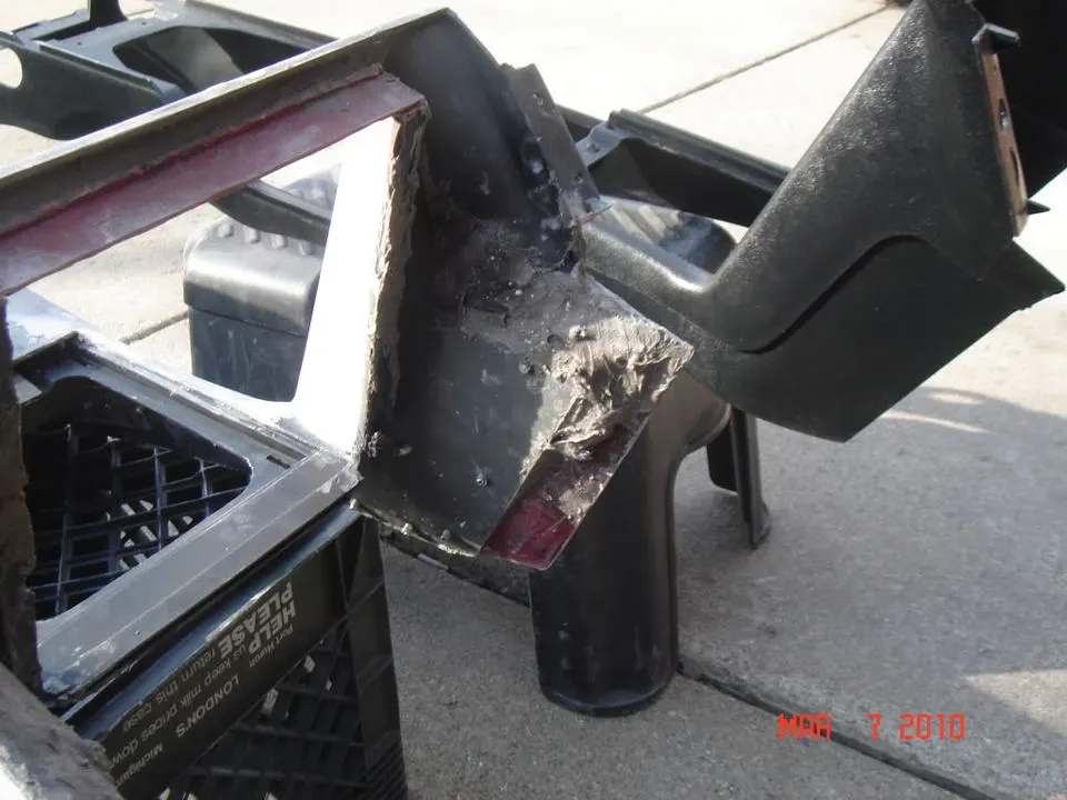

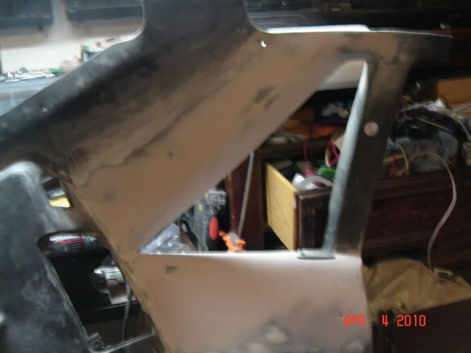

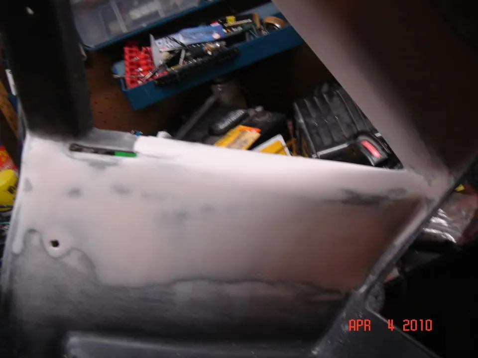

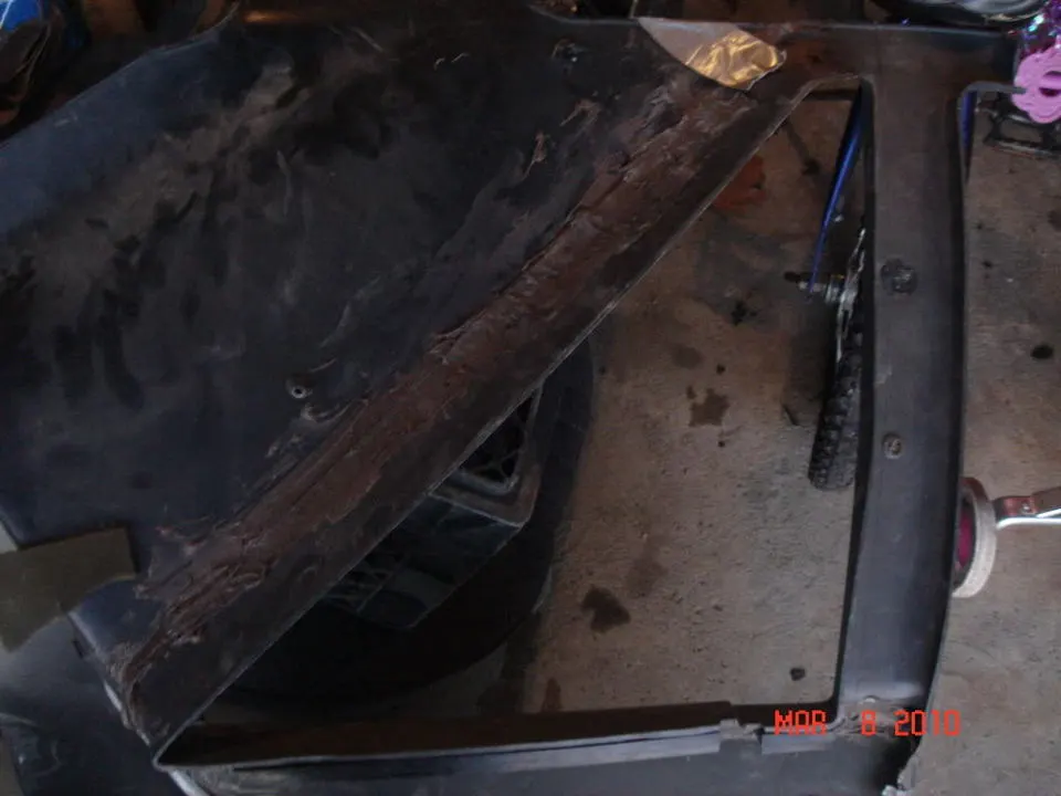

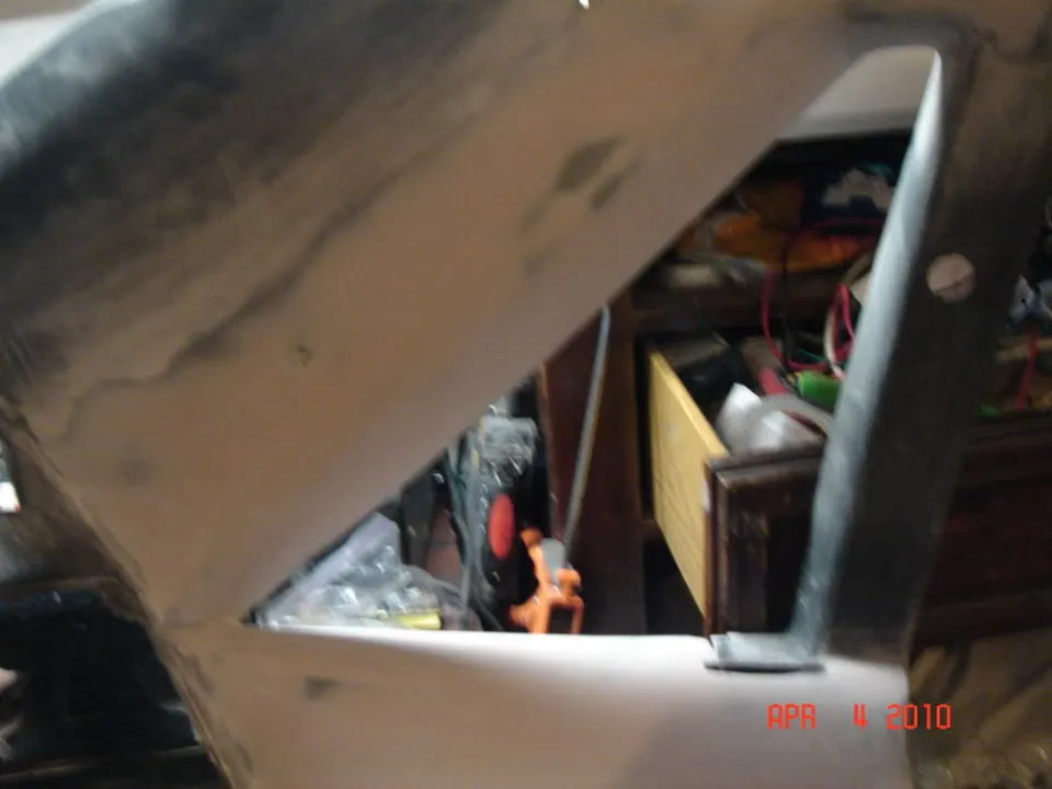

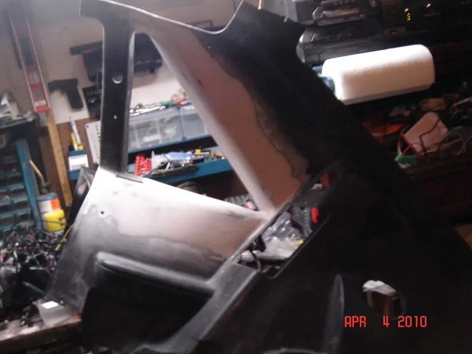

here is what i got done this week i had to cut the window sections out of an 86 mustang and using them in my 90 inner quarter panels.i wasn't sure if i could make this work since no one has ever done this before i had nothing to go on.it sure wasn't easy cutting my 90 black clean inner quarter panels especially since they are not cheap when you come across a set. here is some pics i still need to spray them sem trim black in the next few weeks.

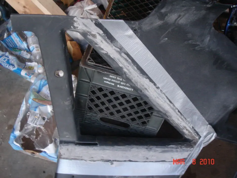

the section i cut out of my 90 inner quarter panel that is going in the trash

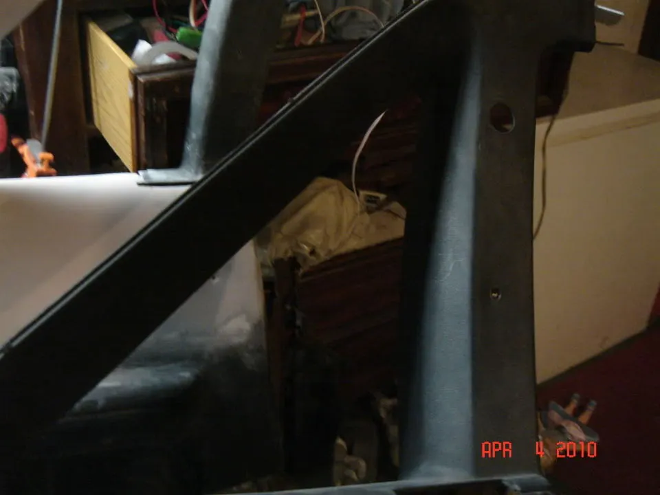

and here is the panels all sanded down and ready for paint
i could have just saved myself all the trouble and put the whole 86 panel in but i put in the shoulder belts and wasn't an option.

I hear ya, I'm a sucker for detail and all the creative little things too. If I did all the things I wanted to my car I'd never get it done, and right now that' a little more important.;) Again, looks great! You have a lot more guts then I do. I don't know if I could cut up new panels and modify them the way you did.:eek: Oh, as a side note, I'm still planning on building a sub/speaker/amp box in the rear. I know it takes up valuable room but my car is not a daily driver so I'm not too worried about it. it's gonna suck though if I have to go overnight someplace and need to put luggage back there, lol.

thanks man so how's your project coming along are you going to cut up your panels?this is definately not for the faint of heart lol i am very happy with the results thus far and look forward to spraying them this weekend .good luck with yours just make sure you measure right.:nice:

good luck make sure you buy the metal mesh and cut strips and fiberglass over the seam that you cut.this will make it stronger at the joint .
Thanks for the tip. I'm not sure exactly how I'm going to make it work yet until I get into it.

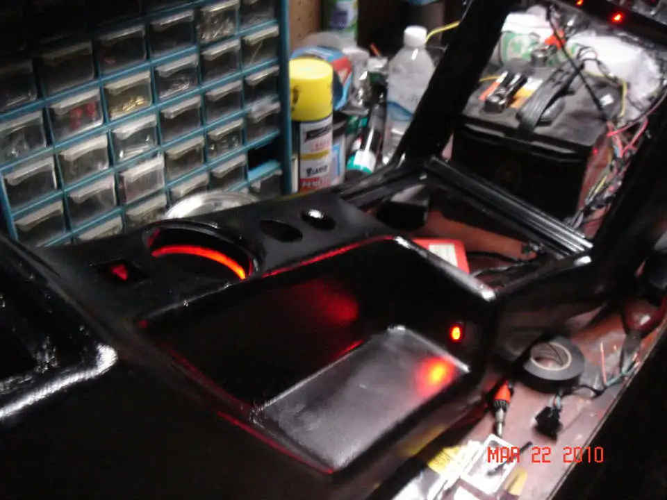

i have decided to add another cup will start on it in a few hours should have it done in a few days.my kid has basketball practice today and that will take up a couple hours of my time.sounds like you have a long project going yourself.

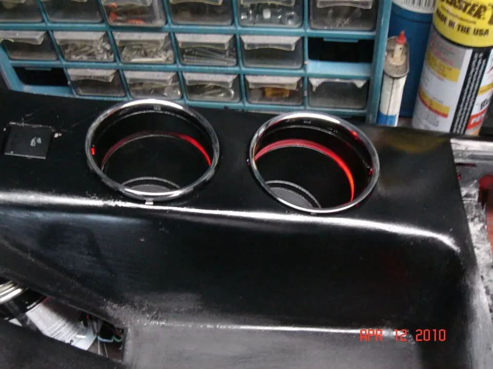

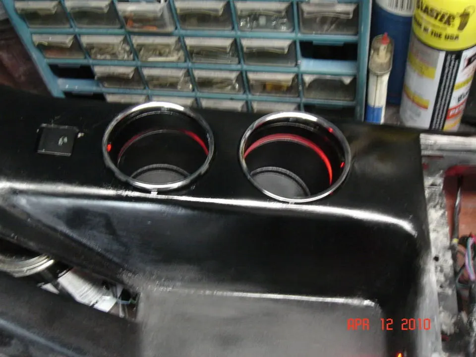

i am finally done with this center console minus the leather upholstery i added the second cup to make it look more modern like the newer mustangs what do you guys think?
the chrome trim will be snapped in place when the thing is wrapped in leather

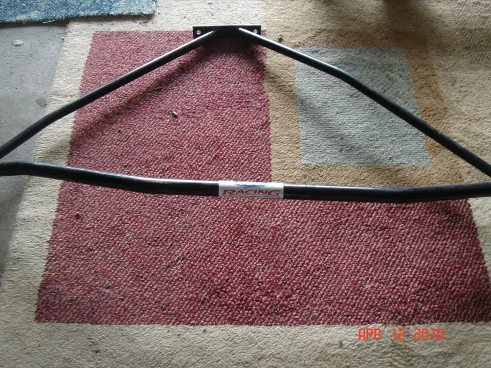

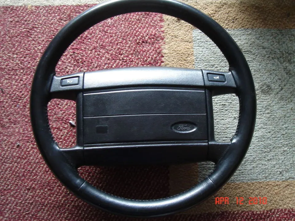

here are some things i have picked up for the project starting with a 93 cobra steering wheel notice the missing cruise control buttons.this was the last authentic 93 cobra piece i was missing.
i was going with this
but recently picked up this

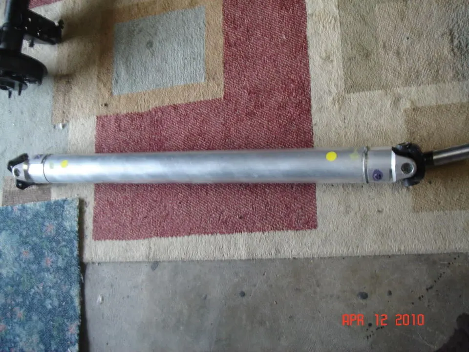

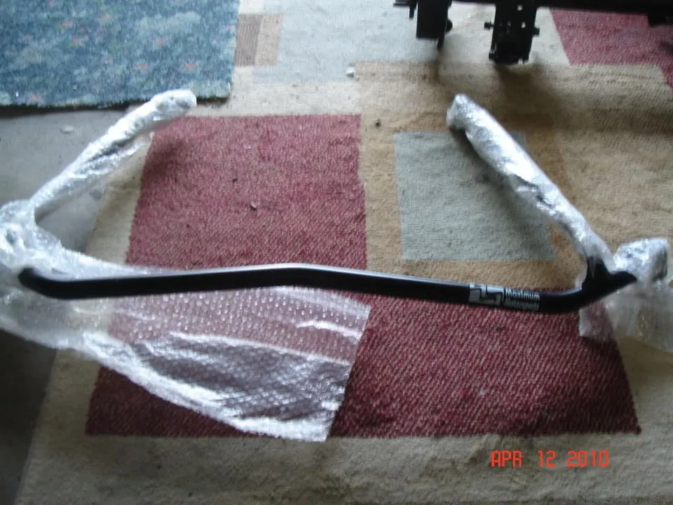

i don't think this will make that much of a difference but

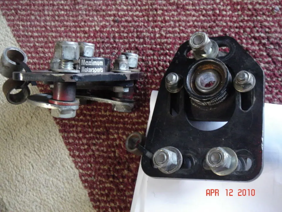

i am going to paint these used maximum motorsports caster camber plates body color as well as my strut tower brace too.

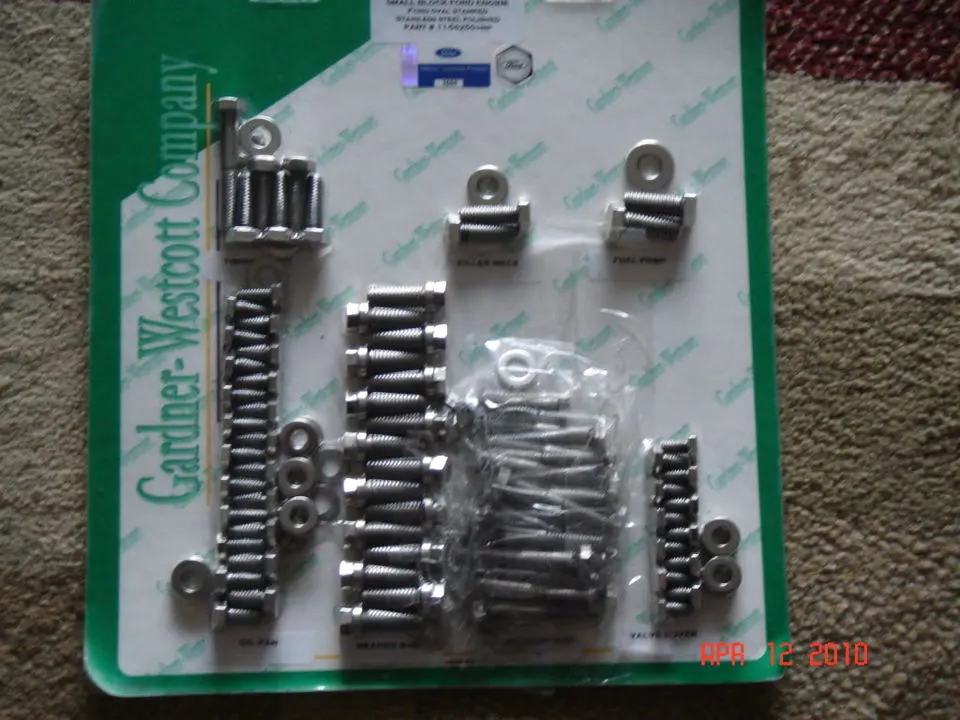

stainless steel polished engine dressup kit bolts should look nice with the cyber gray
You will be surprised about the driveshaft. I felt a huge difference in my 89 when i put it in. Mostly at high speeds.
And I would leave the camber plates and strut bar satin black! Too much of the body color may look like you just hosed the whole engine bay in body color. The black on the plates and strut bar would break things up a bit!
