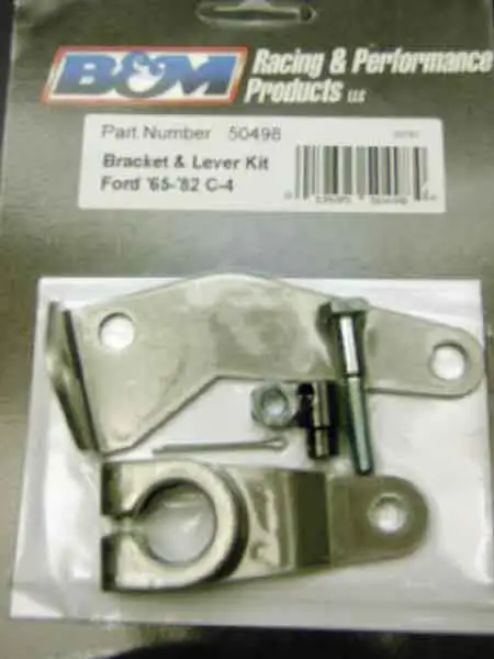

I have one of these shifters installed on a C4 tranny in a 68 mustang. The first installation was done on my old trans (24 spline) by a trans shop. Just recently I did a swap myself for a 26 spline C4. Unfortunately I did not take out the old trans to see how the shifter was hooked up to the trans so I am having difficulty installing it on the new trans. If someone knows of a site where I can get installation instructions or you could explain it on here I would really appreciate it.
Thanks
Do you still have the old transmission? The shifter requires you to cut the 90 degree part out of the shifter arm and install this lever (the bottom piece). The top piece is bolted to rear of the oil pan so the cable can be routed through it and connected to the new shifter arm mechanism.
