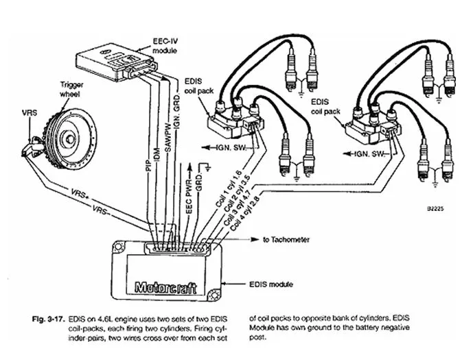

There is a way to wire the edis to a stock computer, I believe.
Yes, it can be done with a quarterhorse tuner and a stock A9L. The A9L actually has the ability to run the edis, it’s just not activated in the stock tune.
I was originally going to go this route, before I changed to going MS3. Ultimately I kept my stock TFI setup and sold off all my EDIS stuff. I think I still have the cam sensors
theee was a bunch of threads on corral on doing the edis8 with a9x ECU. You’ll need to search, but there was a pretty detailed thread on it. Unfortunately I no longer have my links
You’ll need the explorer coil packs and mount, explorer cam sender (2-wire VR preferred over the 3-wire hall sensor) and an EDIS8 module.
Edit: quick search and found this. EDIS is pretty popular as it can be made to function stand-alone with a few inputs/outputs to an ecu. You just need a QH to adapt it to the stock ecu
this one has good info as well
