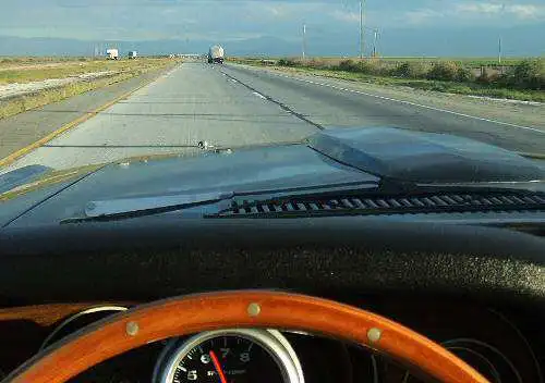

90mph - hehehehe :rlaugh: This shot is from the I95. Toploader and 3.70 gears - look at the RPMs and do the math. The stupidest thing was to let go with one hand to take the picture. :p

I don't have a tach which is why I was concerned. It's just that the tone changed from a great sounding exhaust to something like a raspy glasspack.
Well I'm glad nothing went wrong and that I gave some of you guys a good chuckle. :D
