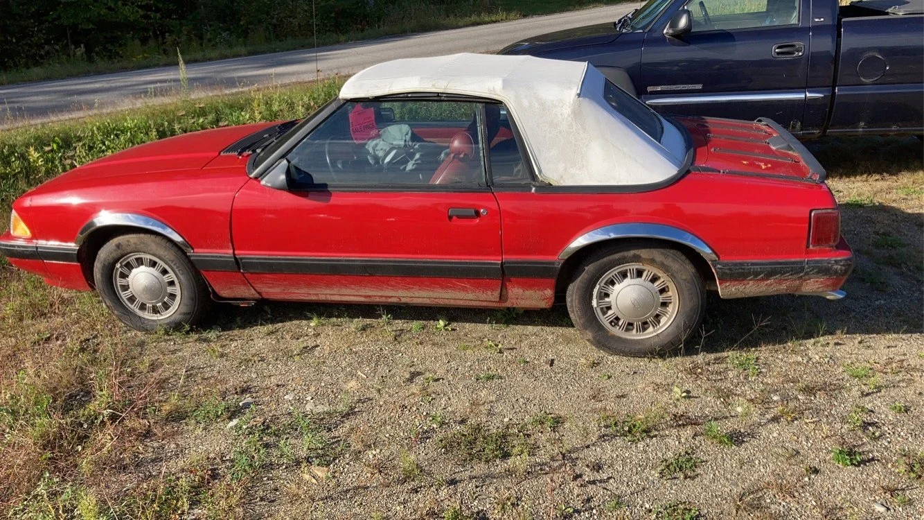

Hi, I'm kinda new here. I've had a few mustangs before (a 77' and a 99') and I recently got a 87' convertible manual 4-banger. I've heard that these cars were the pinnacle of mustang modification. I know for a fact that I want to put a V8 in it, but I'm also thinking I want more HP than the stock 5.0 302 although I'm not sure. What would I need to do a Coyote swap, I'm having trouble getting a complete picture of everything I'd have to do.
I'm planning on doing this mostly alone on weekends or vacations from university. I make decent money for a student and understand I'll have to save. I'm not making this for the track but I do want a fun daily driver that has enough zip to race newer cars.
I'm looking for recommendations for what I should swap in and maybe a little direction (maybe a list) on how much i'll need to do.

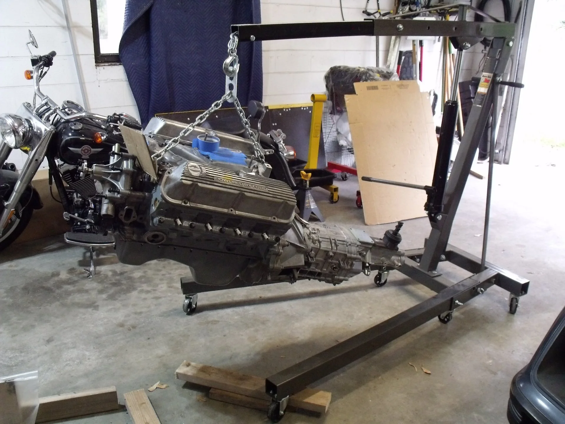

You will need to start gathering up the 5 speed, bell housing with pivot ball, spacer plate, flywheel, clutch, throw out bearing, clutch fork, clutch cable, and transmission mount. The transmission crossmember can be reused but you will have to grind the spot welds on the tubes so it can slide back on them. I would strongly suggest you get a positive stop shifter as they are proven to help the life of a T5. Optional stuff would be a firewall adjuster and an aluminum quadrant. All this is assuming you are going manual being the car is already a manual.

I swapped in a 302 thirty over at about 10.5:1 with good heads, cam, cobra upper and lower, Pro-M MAF with 24 lb/hr injectors and the car ran great like that for years. Made about 250ish to the rear wheels and was a blast to drive.
