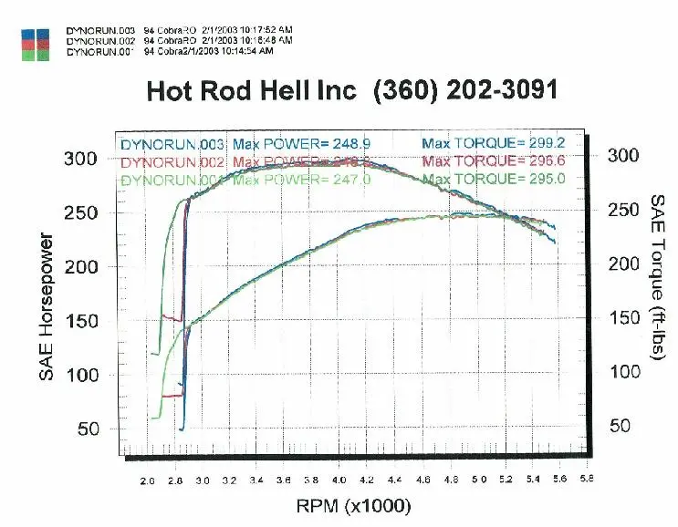

Edit: btw, here is my dyno graph, how does my torque curve look? I have no idea how to read this damn thing!

Hmmm what other mods do u have? 285hp (your 248rwhp plus 15% loss) seems like a lot for what u have listed. Aren't stock cobras at 240hp? Anyway...

What RPM do you shift in each gear. 1-2, 2-3, (3-4??)
I plugged your torque curve into ZeroSignal's shift point calculator. According to it, 1-2 is 5700, 2-3 is 5600, 3-4 is 5500.
If you go close to the rev limiter (6250?) in each gear, you are shifting way too high.
Look at your torque curve. Concentrate on that. Horsepower is too deceiving.
See right at 4200 RPM's. The torque curve begins to fall flat on it's face. Now, the longer you stay in each gear (after 4200), the more torque you lose. Your acceleration rate is decreasing after 4200 RPM's.
But, because of gearing, you want to stay in the lowest gear until it becomes more "effeceint" to switch to a higher gear. 5500-5700 (as outlined above) is the threshold point for your torque curve. After that, you need to switch gears.
You have the better heads on your car (and more parts), and this allows you to shift later than I would. I shift 1-2 5200 & 2-3 5000. My torque curve falls flat on it's face at 3500 rpm's. And 5000-5200 is the threshold for my car.

Your TQ curve is fine and theres nothing wrong w/ your car, just that learning to drive at the track is alot diffrent then the street. Im in that learning process myself. Your 60" times will tell you alot as far as your traction. The first time I went I was running 92-94 MPH but w/ 2.4 and 2.6 60' times. Most people cant get good 60' times w/ out a set of DR's. Just pratice and get the thing to hook up and you will see your times drop.

Have you calculated your shift points out? According to the torque curve you posted up there, you should be shifting at 6000 rpm.
To be more exact:
1st to 2nd: 6200 rpm
2nd to 3rd: 6000 rpm
3rd to 4th: 5800 rpm
4th to 5th: 6000 rpm
