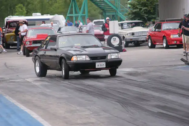

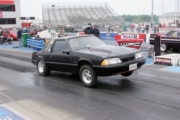

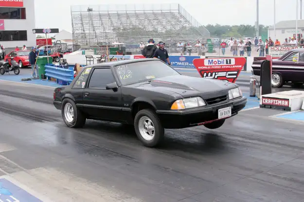

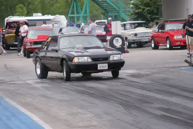

Now for the pics.

I musta missed that pass where you pulled the front wheels, I'm guessing that was the 11.98? Sucks that ET2 was so packed though, but ah well...maybe next year eh?
Actually it did it nearly every time Except for the 11.98 and the 12.5 I ran on the last run.
I guess if you get used to watching huber then you dont think mines pulling the wheels.

I have sent a few links out to your pic of a 2.3L turbo pulling wheels off ground. Excellent work. Looks like your making enough power to warrant adding some body stiffening.

yeha I do have a cage and full length weld in subframes. The car definitely doesn't give. The car rolled in that pic because the pass side air bag was let down just a shade too much.
