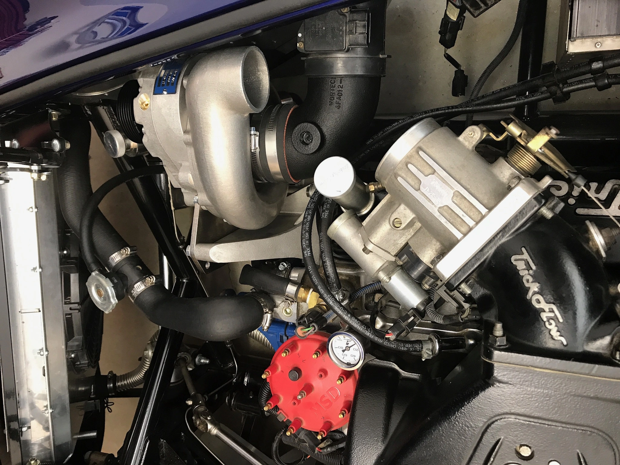

This is the pic without intake discharge tube installed, mass air is at the end of the 90deg tube under fender.
Where it is located there is good air flow and a space of about 2x2 feet with an external duct from brake cooler duct coming in.
Yes airflow.. too much so i'm thinking.. those MAFs are very delicate.. and so much turbulence from the inlet sucking that much air that close to it could be throwing it waayyyyyyy off. Most people mount their MAF down in the fender away from the inlet so there is less turbulence and the MAF can meter air smoothly..
