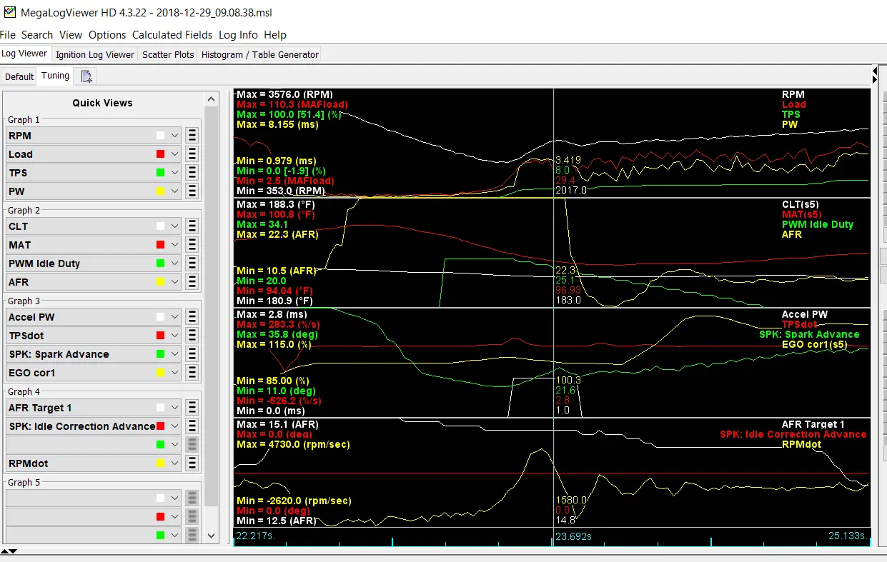

OK can you get me a datalog without VEAL running? also a copy of the tune file.
This is what i see from the datalog, Assuming you are running MAF/MAP as i can see both load parameters in the log file. When the engine goes into decel the AFR goes very lean [no bit# on status 1 in the datalog so i know you are not using overrun fuel cut] [status 2 bit #128 shows cl idle takes a long time to activate as well] This lean spot does not clear up until the rpms come up even though I can see the tps% come up [this means that the transition into load is not set right]. Looks to me you may need to alter the Accel pump settings
-make sure end PW is 0
-make sure the decel Fuel % is set at 100%
Now we need to look at the MAF table to see if there is more we can do. But first check out this snip from your datalog.
The stumble issue you noticed at your time stamp looks like it may be the idle going below the cranking RPM threshold if you have it set that low... that one is odd.. you can see the spark: spark advance drop from 16 to 11 and the spark: base spark advace drop to -3... basically it dropped to the cranking advance setting......
I see nothing in the status blocks showing loss of anything... maybe check that the spout is in tightly, this can be tested to see if the spark advance drops to the cranking advance.
let me know what you find

Was this datalog done with the spout removed??? anything special? basically the ecu is in startup mode for timing....

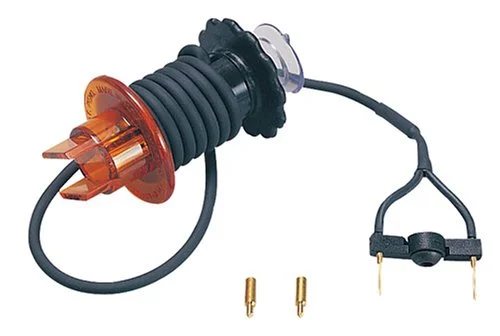

How to connect a noid light without removing upper intake?
No I believe it's another issue and not tune related.... maybe check the electrical connectors salt and pepper shakers and the TFI.
The issue is the timing is defaulting to 11 no matter the rpm it seems... in the last datalog you sent it showed base spark advance to be -3....

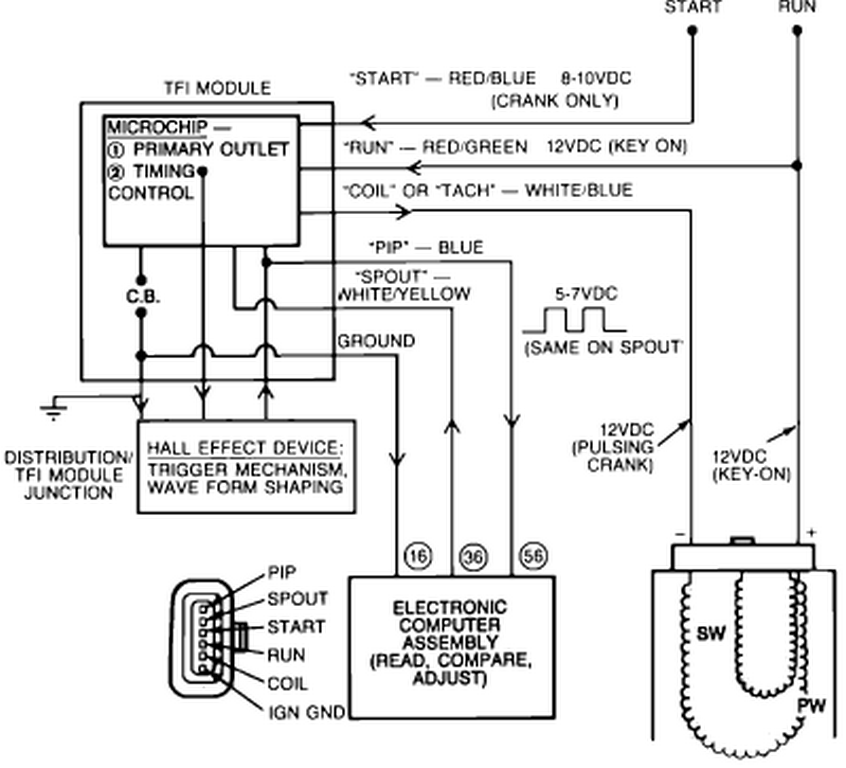

The issue is the timing is defaulting to 11 no matter the rpm...
Nothing from ignition goes through salt and pepper shakers.
Distributor harness goes beneath upper intake. One of the vacuum hose was jammed up in there, maybe this one still is?
Looks like the best way is to check continuity from the TFI connector back to the 60-pin.
UPDATE: 56, 36, 16 all checkout as good back to ECU.
I'm running out of ideas, don't know where to go from here.
