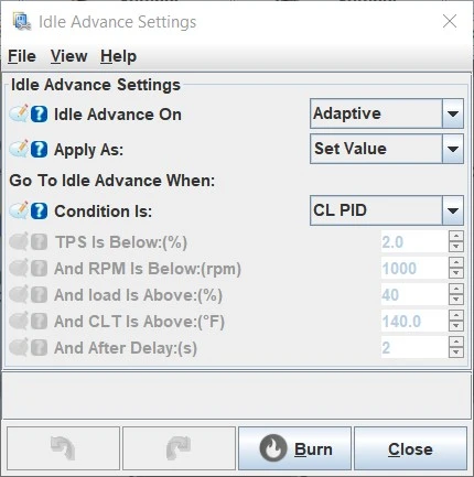

Idle Advance is ON.

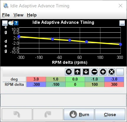

Sets the timing vs engine load or RPM or Adaptive when Idle-Advance is active.
Load: Typically the curve will ramp from low advance at low load to more advance at higher loads to stablise idle.
RPM: Typically the curve will ramp from higher advance at lower RPMs to less advance at higher RPMs to stablise idle.
Adaptive: Typically the curve will ramp from higher advance at negative RPM deltas (below target) to lower advance at positive RPM deltas (above target) to help stablise idle.

This makes sense now, this is wrong.
Apply as: adder = this is what you need
Setting this as 'set value' forces the timing to that amount at idle. Sorry I didnt catch this sooner.

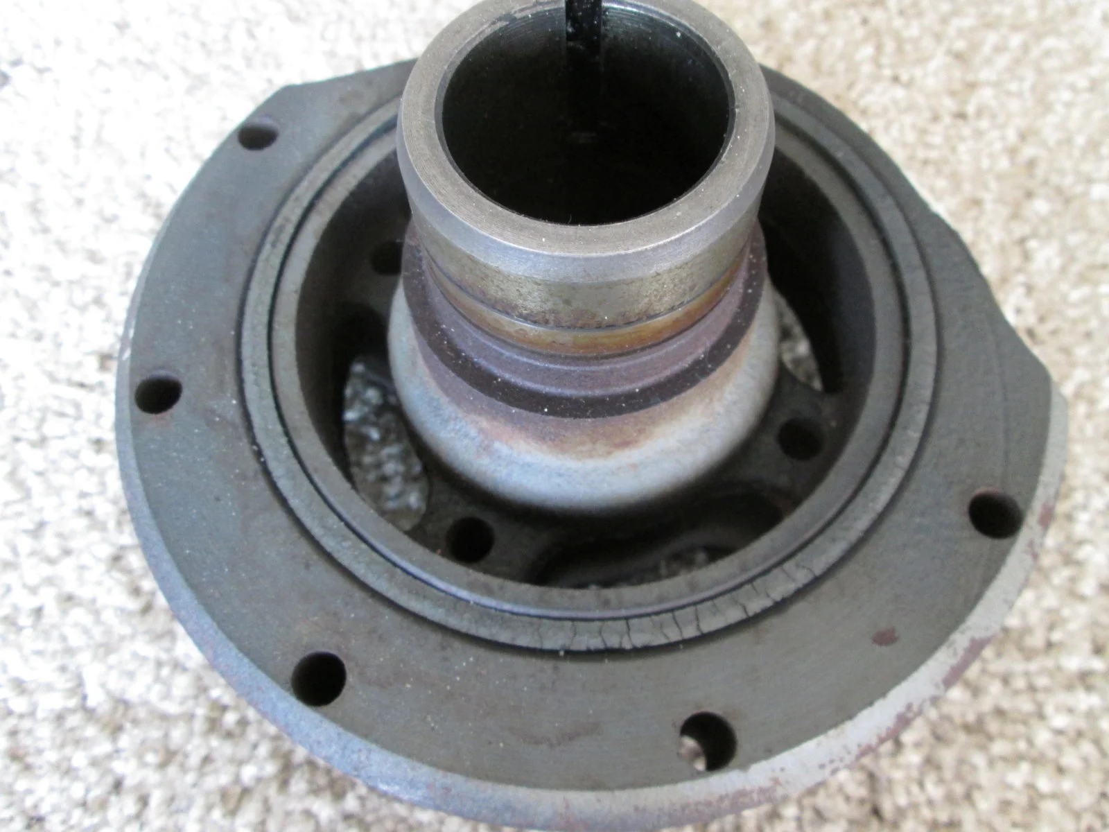

The harmonic balancer elastomer has probably hardened after 31 years, so it's not dampening anymore.
Its possible that the harmonic balancer ring has slipped this needs to be checked very soon. If the rubber on the balancer is bulging out then it likely needs a replacement.
Balancer is out. Backside rubber displays all the classic signs of needing replacement (bulging & cracking), front looks fine.

Looks like the old balancer might have slipped 5 deg, base timing with new balancer was 5deg BTDC when it's been set at 10 forever.
Since MS table in the lower left is 16, in reality it was 11 which may have been the root cause of the low load stumble. Steering wheel still has some shake at 850 rpm. Didn't have time to analyze the tune further.
