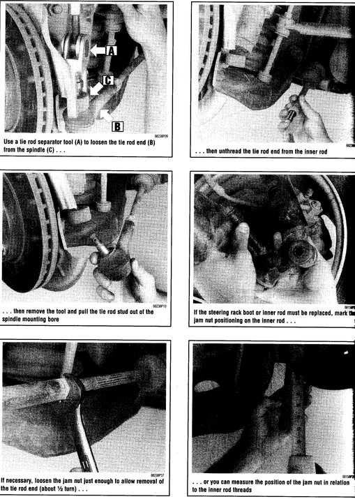

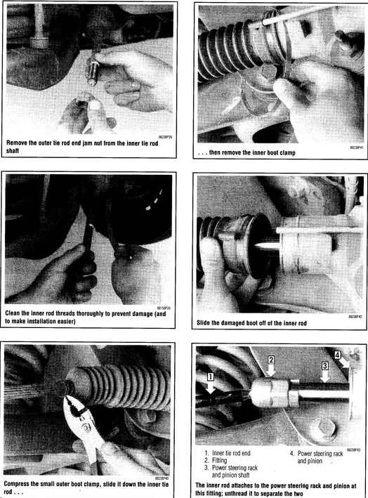

remove the outers you have done this before right? and and unscrew outer tie rod from inner and when you reinstall you want to screw the outer in to the new inner up to the same location on the thread.remove jamb nut from inner.remove inner boot clamp.remove outer boot clamp. slide boot off. the inner rod attaches to the power steering rack and at the fitting ,unthread it to remove. the install in reverse then imediately after changing get a front end alignment....
here are some illustrations hope they help...

Do SN95 racks not have the pin that has to be drilled out to remove the inner tie rod? That's kind of the PITA part of doing an inner on a fox.

nobody mentioned that u need a special tool to remove the inners, basically a long tube that accepts the correct adapter for the inner tie rod at one end, and the other end has a hole for a 1/2 inch ratchet/breaker bar so this way u can get the leverage to beak it free. my kit has about 5 different adapters for all different cars. i guess if u had a wrench big enough u could try to break it free that way but the tool makes it alot easier.
ok guys, as an update, it only took me about 1.5 hours and it was really easy.
If anyone is gonna do this in the future, dont even try and drill out the retaining pins. Take a flat whood chisel and hit around the head to bring it up a bit, then grab it with some dikes, and they come right out......takes like 5 mins each. other than that straight foreward...just unscrew them from the rack and put new ones on.
