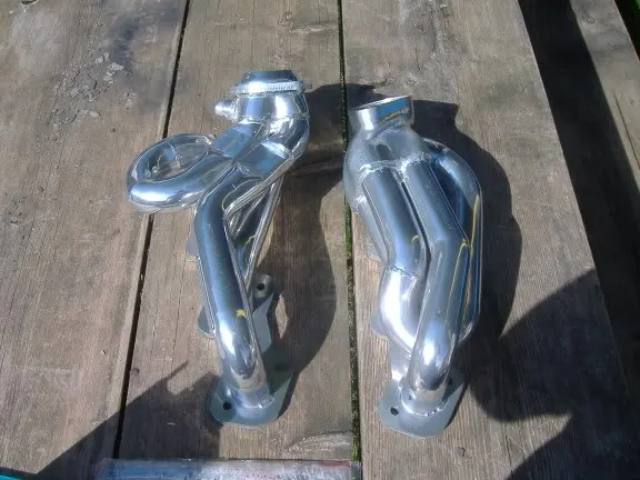

Time to install the bbk shortie headers today. I'm going to try and post pictures as I go through out the day. I'm sure this willl turn into tech Q and A with people who've done it before, so check regularly...

Cool...! Those are equal length? Stock midpipe? I want to do the same. Can't do long tubes cause I'm too low. Next year I'm going to an O/R mid pipe, hopefully an "H" pipe.
Subscribing...
On Edit: Just saw you're not w/stock midpipe. Post an audio clip sometime if you can.

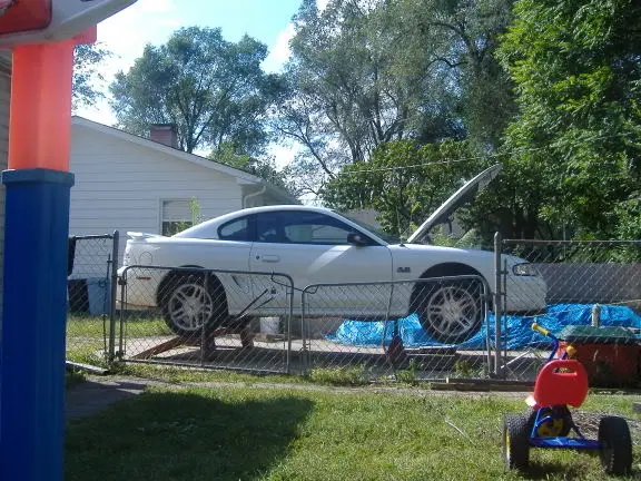

Wow... make sure you actually finish that project. With the car up on stands like that and the rest of the surroundings, it looks like Arkansas threw up in there. I've seen that whole 'vehicle on the stands in the backyard surrounded in weeds' on Cops a few times before in the background of some crazy domestic dispute or something. :D

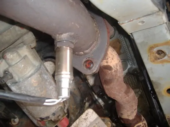

Does the header to the right in the picture have a slip fit flange on it? I can't tell. but if it does, good luck in getting that to seal!

have been great. everything is going smoothly so far. the bbk header have a couple of slots on the header holes, not all.
only on step 13, lol. i expected myself to go slow, labor day, here i come!

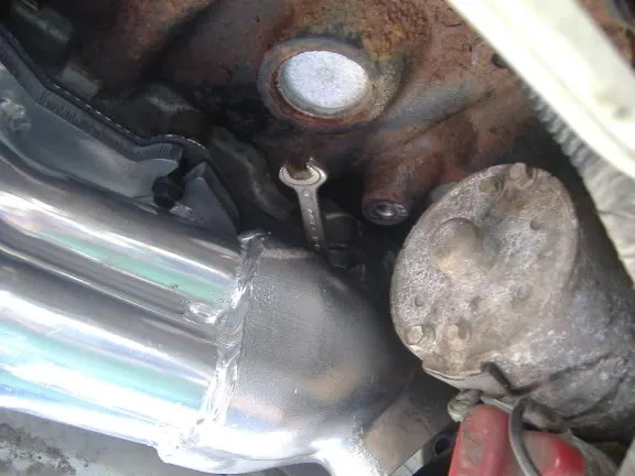

thats what sucks about this whole thing. I thought i could just pick up some at autozone as everyone and there mom said they stock copper ones.... well they don't. for now its the bbk ones, but seeing how easy this all is, i will replace those as soon as i need something to do.

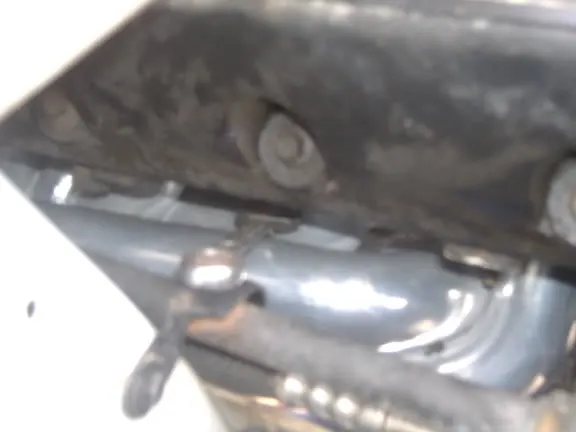

It doesn't seem like anything else is in the way once the K is removed, i've stopped following the directions as mine is a 98. we'll see how this goes.

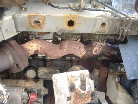

well, had to stop early today due to rain. Its been on and off since 5:00. As of right now the passanger side header is in place and just needs to be tightened down. I may have to remove the starter to get to bottom left bolt to tighten down. There is very little room to tighten these bolts. Its not that the car is in the way, its that the headers themselves get in the way. The only way is to have open ended wrenches, even the closed end is too thick to get in between the flange and header pipes. I had to nudge the engine a bit and create an opening from above to get one of the top bolts into place. Sorry, no pics this time.

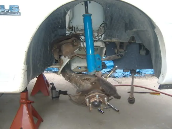

That's a good tip on the spindles, I guess the whole control arm has to go to get them off?

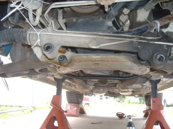

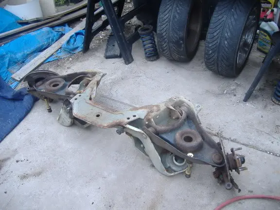

I have a jack under with a block on the oil pan to support the engine. The k-member bolts had no problems coming off. a couple were a bit worn, but none were seized or anything. Dieffently grab a can of pb blaster and you'll have no worries. I haved sprayed every bolt i've turned to be on the safe side. I was surprised at the ease the header nuts came off.
This car has 126,000 mile all in michigan hence the rust.
Nah, you could if you wanted to though! That would make it even lighter ;) There is a nut on top of the balljoint where the spindle mounts to it. Simply take it off, and smack the spindle with a hammer till it comes loose hah.
Is the transmission half-way supported with the oil pan? I wouldn't want to put ALL the weight of the motor on the oil pan, could end up bending it.

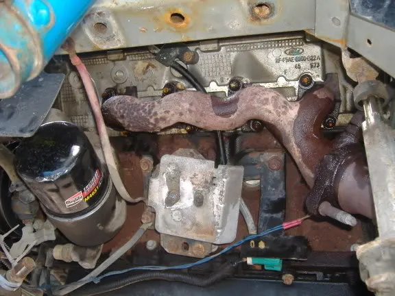

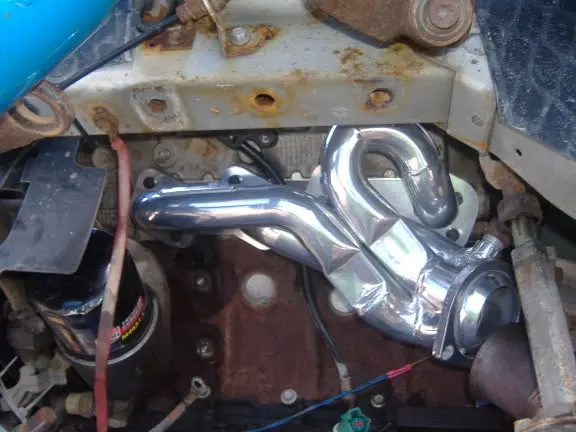

today started a bit later(a guy's gotta eat) and things are going good. both headers are on and im in the process of tightening everything down. This takes a while as a few bolts have to go an 1/4 or less of a turn with the wrench.
Here's how the clearences look. Imagine tring to do this with the k-member still there....
it looks like the bottom right motor mount stud needs to be shaven down about an 1/2" as it hits the header a bit.
