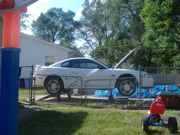

mijo_latino said:
Will you make sure it sit safe cause you have jack stand up front and ramp out
back . Looks like it might role back. be safe
Working under the very front of the car, I guess if it were to roll at all, I'd rather it roll backwards instead of forwards...

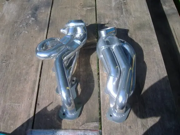

blackink00 said:
i still cant believe your going with the header gasket that came with bbk
yeah the bbk header gaskets suck! we put them on with my brothers bbk shorties. they literally baked, then they leaked really bad. just made of the wrong material i think. turned into lika a tortilla shell.
-=NightHawk=- said:
I have BBK gasket in mine. I didn't have time to look in to new one at the time, and reusing stock one didn't go well(stock manihold have dinple where protrusion from gasket fit, and BBK flange don't have them), and leaked. So i used BBK instead.
I haven't had any issue with it yet. But next time I have K out(hopefully to do Tube K), i'll change gasket with dead soft aluminum one...

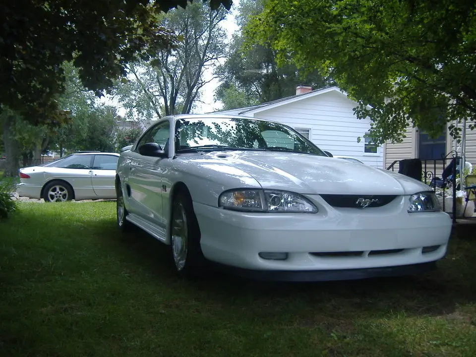

Just came back from an extended test drive, everything turned out great! The tone deepened quite a bit more, a smidge louder too. SOTP impression is that there is a definate gain. idle to 2300 rpms is almost the same, but after that you feel the car gain power and it pulls a little harder now.
Finally Done!!!
The first start up was horrid. The computer was having a grand ol time relearning all the modifications, it was stumbling and hesitating quite a bit. I let it idle for a while until it calmed down.
There are no leaks so far. I went with gaskets bbk came with due to the fact i thought i could get some copper/aluminum ones at the local auto parts stores. None carries them. I can spin it and say i want to test out these gaskets for you all, see the lifespan until leaks develop, hehe.
