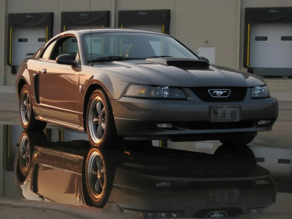

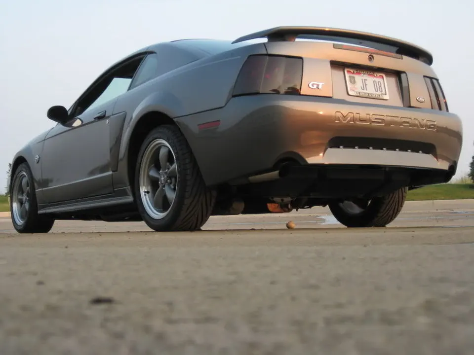

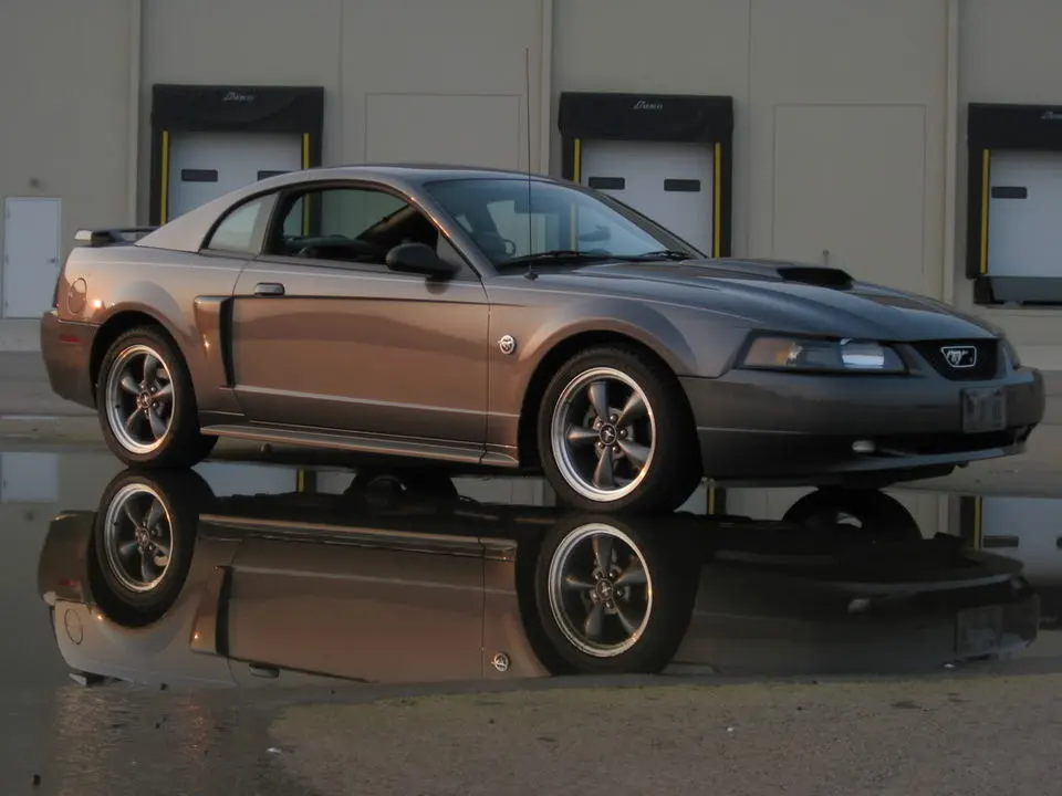

Ride quality isnt to bad not as good as stock but the feel of the car is great. If you do take the isolators out. Make sure you do a quality wrap job on either end of the spring with some electrical tape(I used Scotch Super 88, supposedly more all weather type?) No squeak either. I love the rake look! I washed mine up today and went for a cruise so I took some pics hope they convince or dont. haha
john
