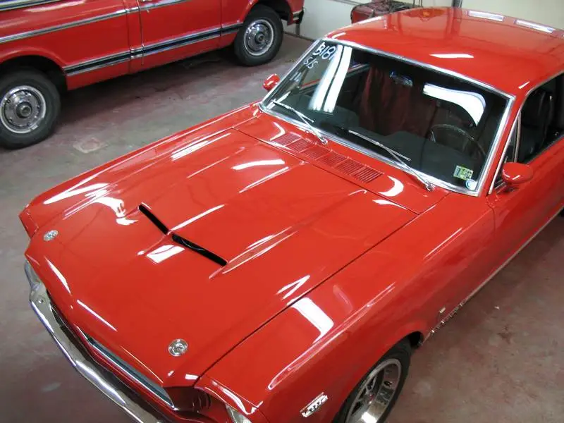

Although not a great pic of the plates, these photos show the location that the pins will be when you use the hood bumper mounting location:
I too bent the brackets more upright using the pins.

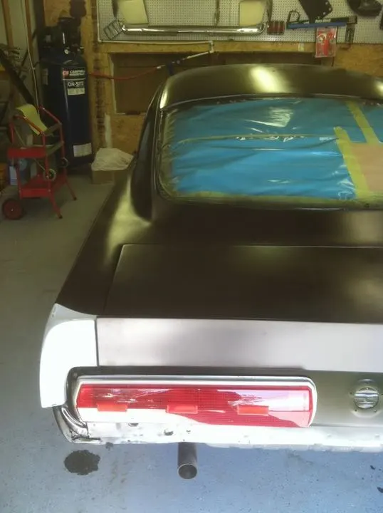

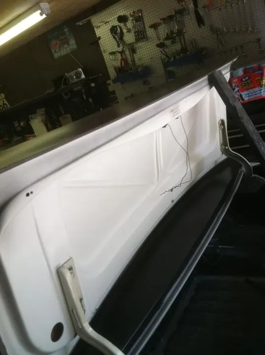

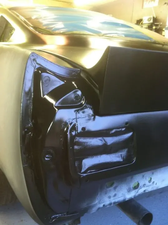

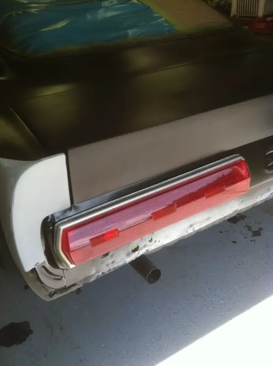

Yes hood is mounted, looks great. Stangoholics really does sell quality products that fit well. The end caps were almost a bolt on deal, just a skim coat of bondo and they fit perfect. I included a pic of the inside of the trunk lid so you can see the quality of the product, and I also set one of my taillights in the hole so you could see it too.

looking good keep posting pics
