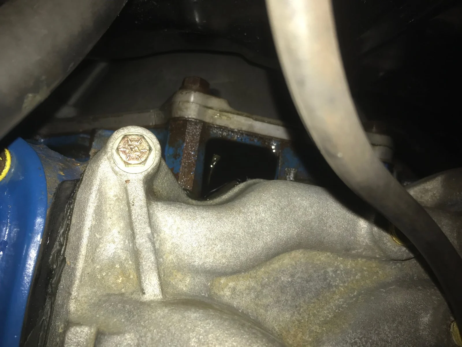

I got them straightened out and took the Cobra II out for a spin and I needed gas so I could take it to the custom exhaust guy on Monday. I got on the gas a little getting on the freeway and looked in the rear-view mirror to see the horror happening behind me. Blue smoke bad. I got to the exit ramp two blocks from my house and idled it home. It left an oil trail all the way down my block and into my garage.
The oil was running out the back of the manifold with a nice pool on the block then down the side to land on the headers and exhaust pipes.

Assuming you've had the manifold off, did you silicone the connecting points between the cork valley gasket and the actual intake gaskets mated to the head? And you made sure to stick the valley gasket in place before installing the manifold? Iirc, they come with a sticky back with a cellophane or paper backer you remove so the gasket stays in place. Aside from just plain out having a bad gasket, those are usually the 2 main culprits of an oil leak like that. Really not too big of a deal to take care of, especially if that's the case.

Well I used the method described by Edelbrock which uses RTV instead of the gasket. It held for a long time although not many miles. I've ordered a new gasket set from Summit Racing #MS93334 which has the rubber end seals. I'm hoping that is all I need.
I'm kind of amazed that there is that kind of oil pressure in the lifter valley to blow all that oil out. I think I only have a couple of quarts left although I haven't drained it yet. Is there anything else that could cause this? I don't want to go to the effort to replace them only to find out that I should have done a rebuild. Although, it was running great. It was smiles all the way around until I looked in the rear-view mirror. That wiped the smile off my face fast.

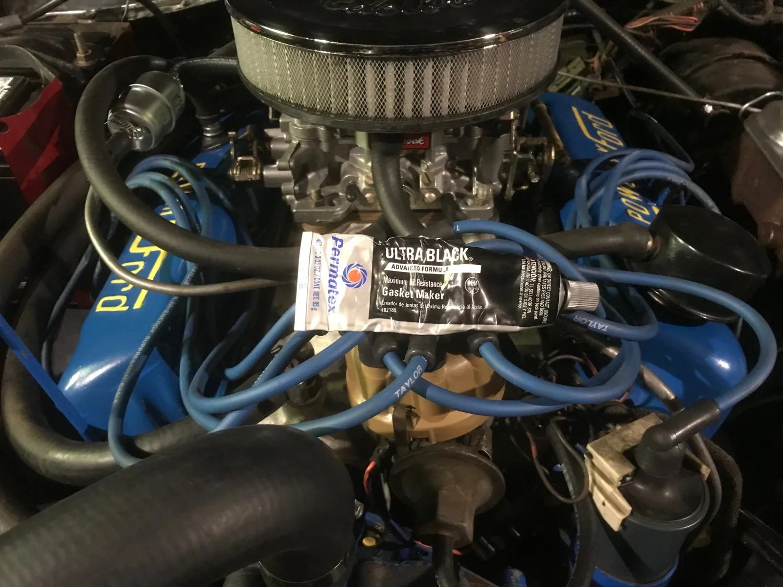

Reality = An 5 dollar tube of silicone
If the silicone doesn't fill the void from where the little end gasket is (we all toss that pos), It will do just as you described.
Its just lifter splatter but can empty crankcase fast. Got to fat bead both sides, block and manifold

The four main causes would be excess crankcase pressure, not enough silicone, improper surface prep, or wrong type of silicone (Permatex Ultra Black is best for this job).
If you have a breather and PCV, it's not crankcase pressure.

Ultra Black is what I've used. And the rubber gasket is preferred over the cork. Paste it down to the block, apply a bead to the top of the rubber gasket and a little extra dab at the intersections and you should be good. If you have extra crankcase pressure from bad rings or anything that caused that leak, you'll find another weak point soon. I ran into the issue with my 302 which is one of the reasons for my tear down a few years ago. I found I had a broken compression ring so oil was finding it's way out at any weak point it could including my breather. I went so far at one point before finally giving in and tearing it down as to change from the rubber oil pan gasket that was in it back to a cork gasket while the engine was still in the car. I thought maybe I had torn or slipped the rubber gasket which was the problem, but I found out soon after that it was indeed crankcase pressure necessitating the tear down. In my case it really wasn't that big of a deal. I ran my cylinder hone through the scratched cylinder and was able to keep it from going too far out of tolerance while giving the cylinder it's crosshatch pattern. I don't think I'd recommend someone do that without proper tools and all that, but it CAN be done.
