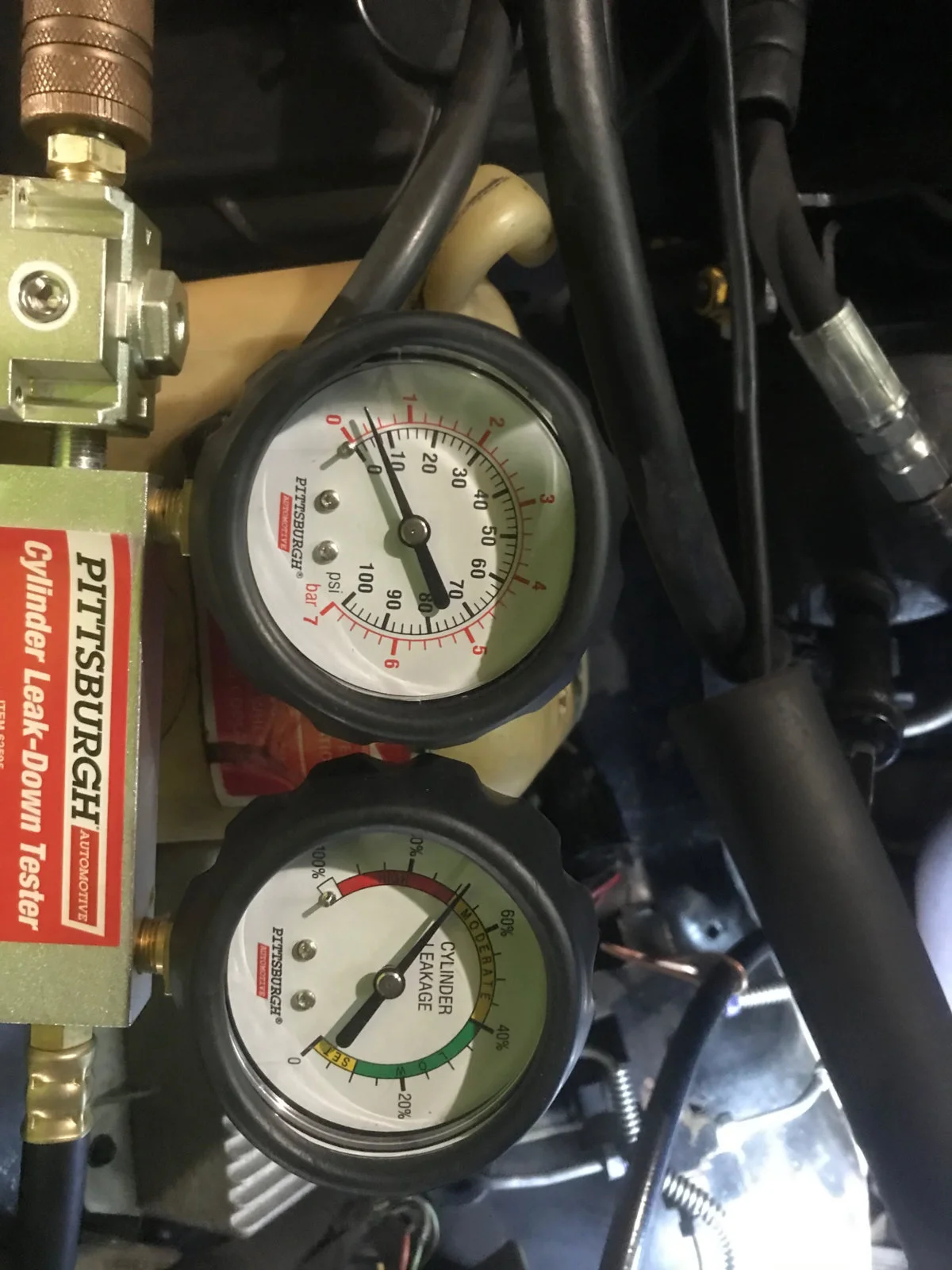

Well that took WAAYYY too long. Needless to say here is the leak-down test on #8.
I'm hard of hearing but I think I could hear it hissing at the back of the manifold. no bubbles in the antifreeze. I couldn't hear anything at the oil fill nor the carb.
Thoughts please.

If the air is coming out where the gasket blew out, it's either a head gasket or a defect in the block or head (such as warpage or a crack). You can verify that it's pushing combustion gasses out to the crankcase by connecting an air hose to that cylinder again and listening/feeling for air at the dipstick tube, oil cap, or breather.
You can also spray some glass cleaner or soapy water at the area you suspect while supplying air to that cylinder for a visual indication.
Hopefully it's just a head gasket.
No bubbles. It was pumping the air through there like crazy. I think when I shut off the compressor at it's peak pressure i could hear the air from the exhaust. So, that tells me the valve is bad and it doesn't solve the manifold gasket blow out unless I didn't do it right in the first place.
Unless you tell me different the head needs to come off.
Did you make sure the valves were closed before putting the air in it?

I'll test it one more time in the morning. I tried with a pencil to bring it to TDC. If I went a little to far I'll check again. I covered the intake with dove and water mix. Again, I'm hard of hearing. especially high frequency. I'll ask for help tomorrow and let you know. Thank you for your help.
Enzio
couldn't find anyone to help out. most people are working. there is definitely air from the exhaust. I can't tell if there is any leakage at the manifold end seal. Now, I'm going to check one more thing when i get back from fishing which is to see if I have the #8 exhaust valve too tight and therefore not closing. I don't know if that's possible or not. But I will check.
