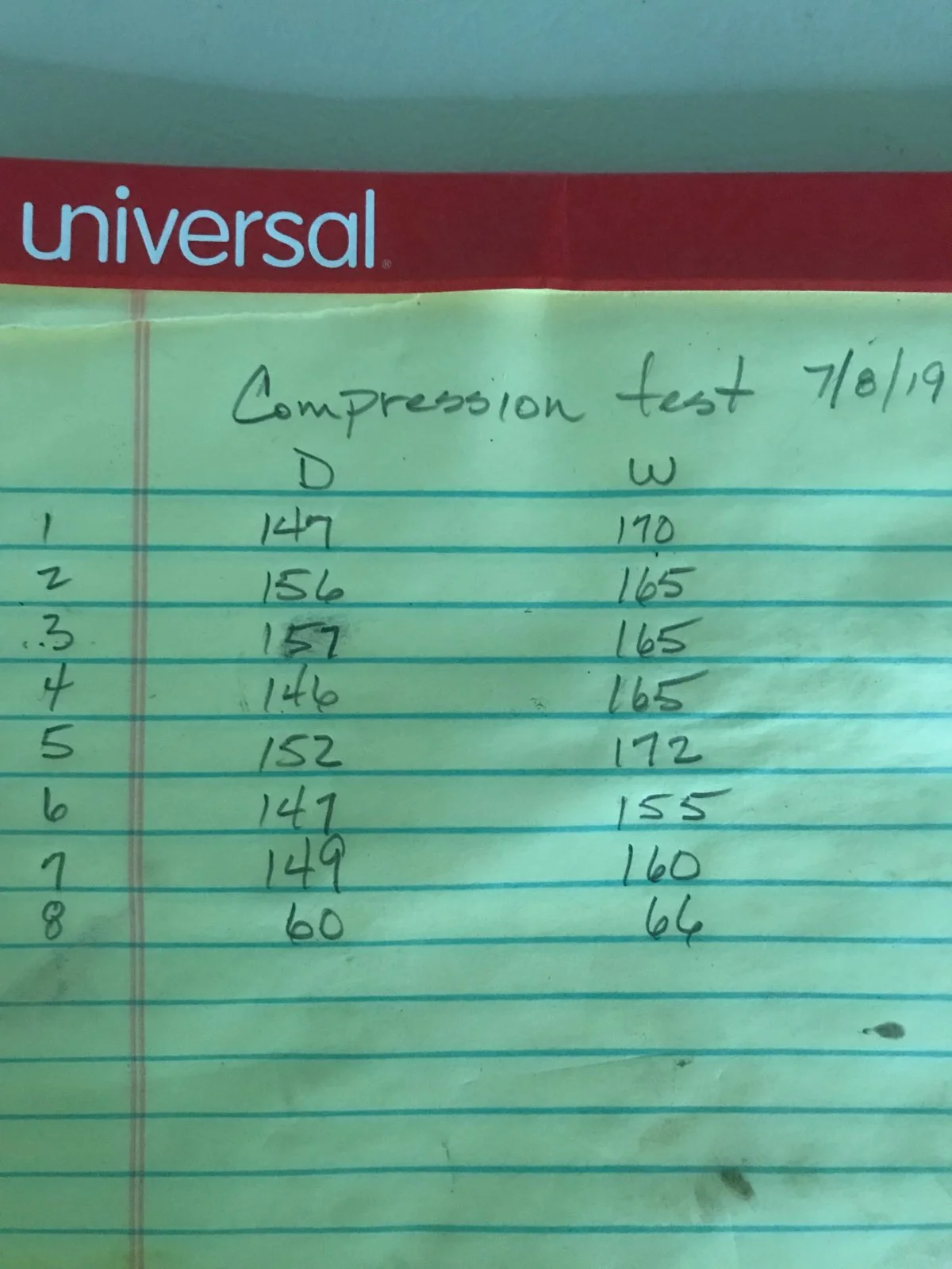

I'd like to determine whether I have excessive crankcase pressure due to a broken ring(s) before I go through the replacement of the intake manifold gaskets. All the plugs look like they are burning perfect.
Is there a way to tell if there is a ring issue? Compression test? I've never done a compression test so I'd need someone to tell me a procedure to follow and I'll run out and do it.
