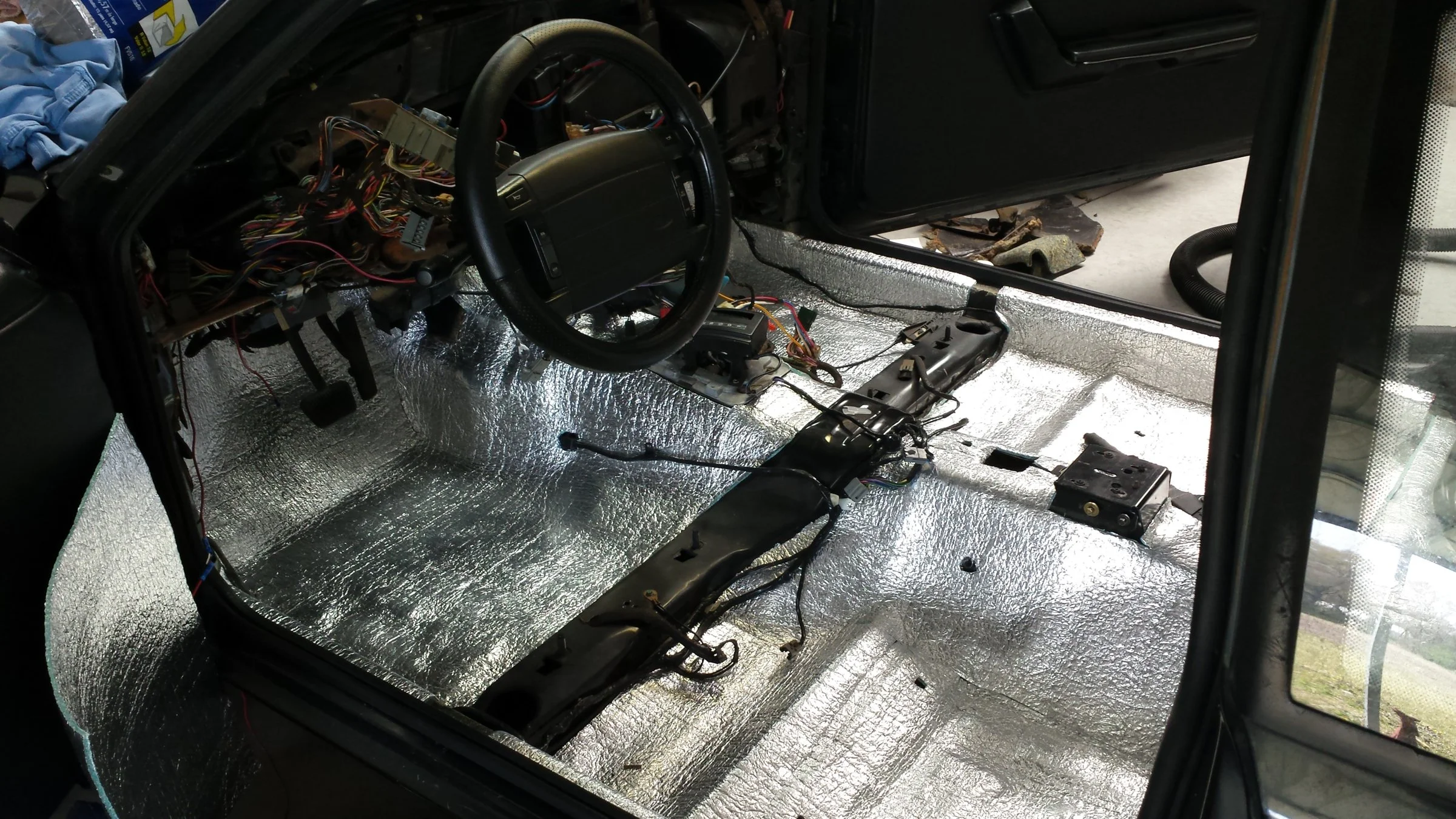

My son and I have been working on his 92 SSP interior. We wanted the car to be cooler and more quiet. I used Fatmat on the metal surfaces to muffle the drum sound, and over the top of that I put a layer of Car Insulation. I'm looking forward to seeing how much improvement will be gained.

Will do, I will say that's a major plus with the Car Insulation, it's very lightweight. I can say the roof of the car use to sound like a drum, but after some strategically placed Fatmat and a layer of the CI, it's a night and day difference. Should have it put back together soon, I'll report back with the results.
