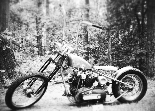

The Harley is nice. It's an Ironhead RAT. It was a custom build that I finished. I've had a lot of offers for it but am interested in getting a mustang. I just don't want to get screwed on the deal like I said. I don't want to get rid of something worth money in trade for something of no value.

That Harley is sick. I'm not into ape hangers but if that thing had some drag bars, i would be all over it. I think i'd hold out for the next Mustang myself. All the tune up parts is like $50 if that, and the exhaust could be super cheap muffler shop stuff, and even if it's after market stuff it isn't but a few hundred unless he threw a bunch of Bassani stuff on a stock car (unlikely).

BTW that bobber is baaaaaaad asssssssssssssssss!
